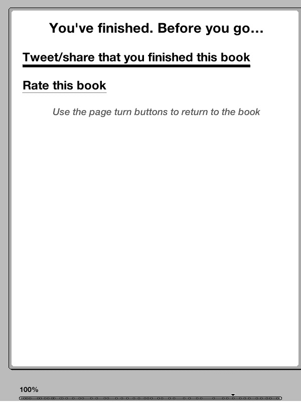

Originally Posted by ProfCrash View Post
Mike: It is on the PW's. I never saw it on my K3 or DXG. It might be on the Touch but I am not sure about that.
After the 3.4 firmware update my K3 also started showing this nag screen for some side-loaded books after reaching the end of the book.
Here's a screen capture.
