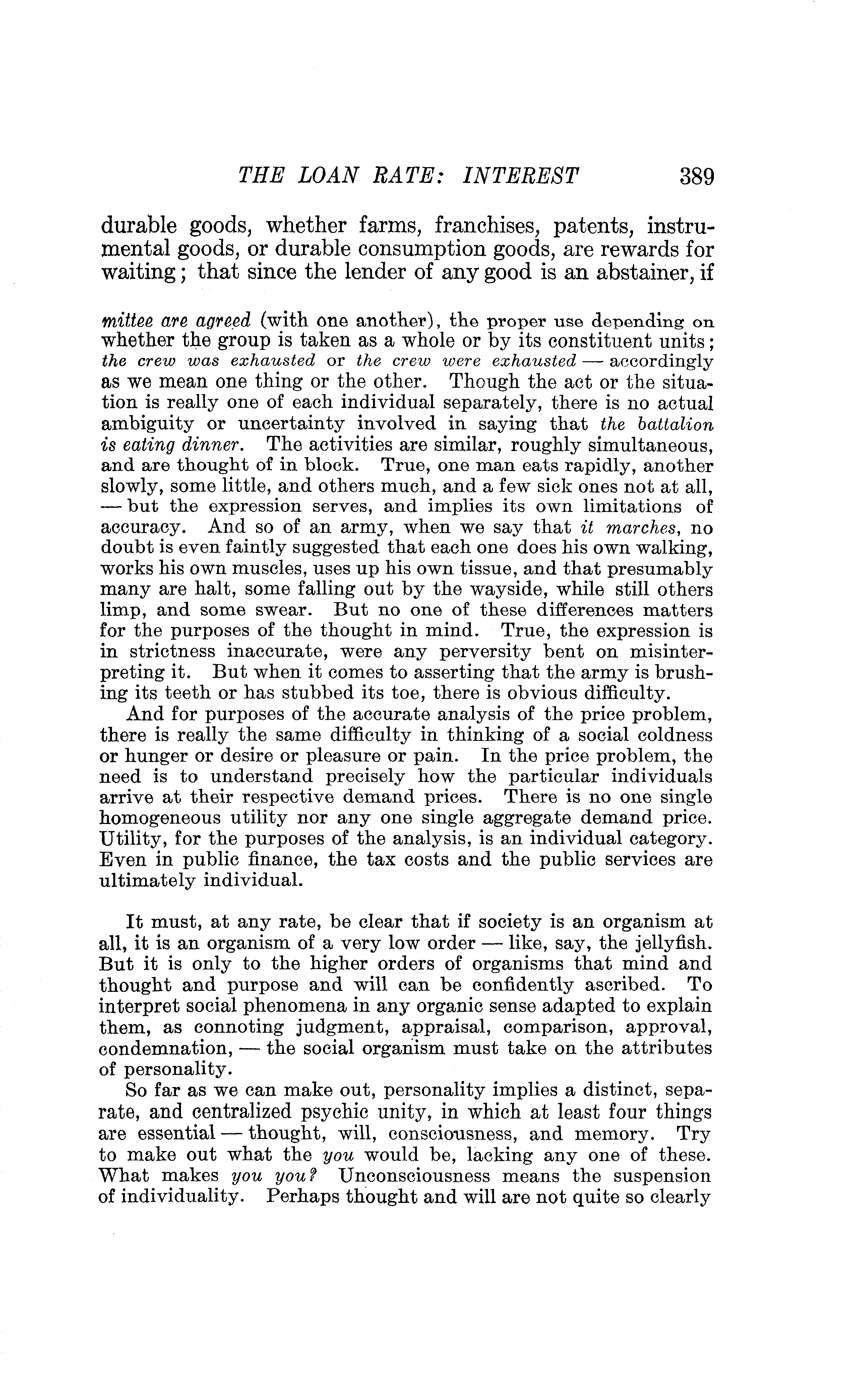

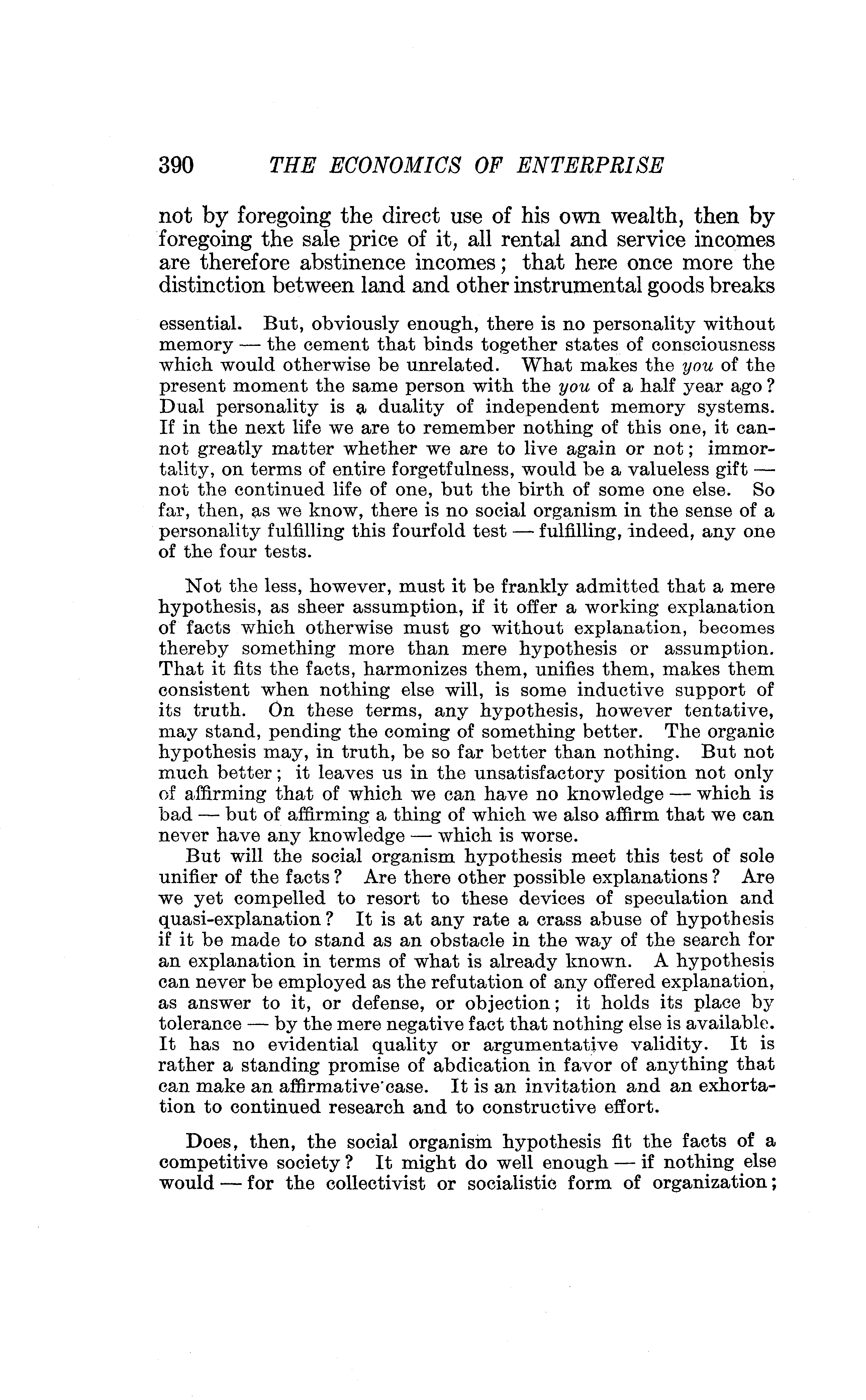

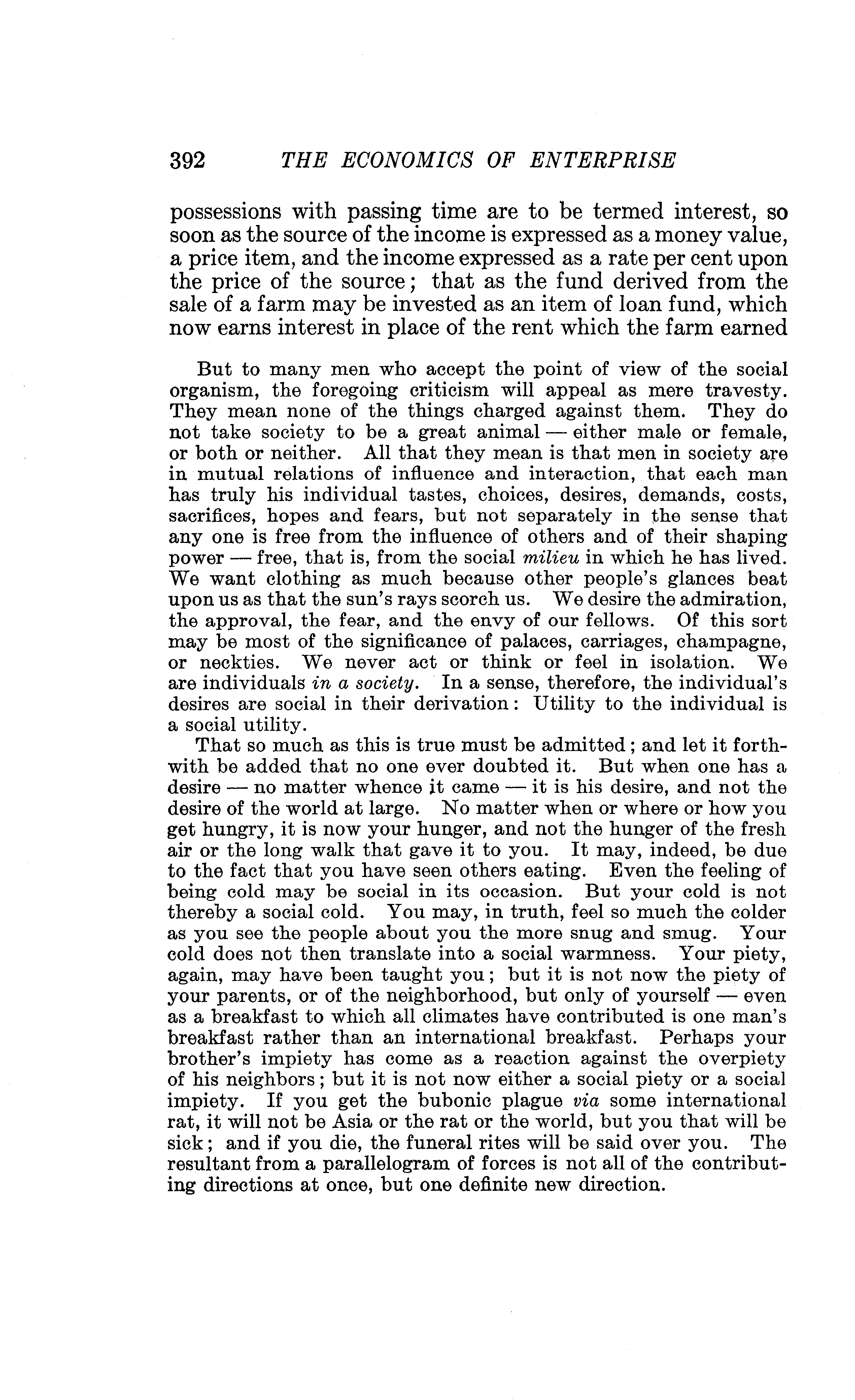

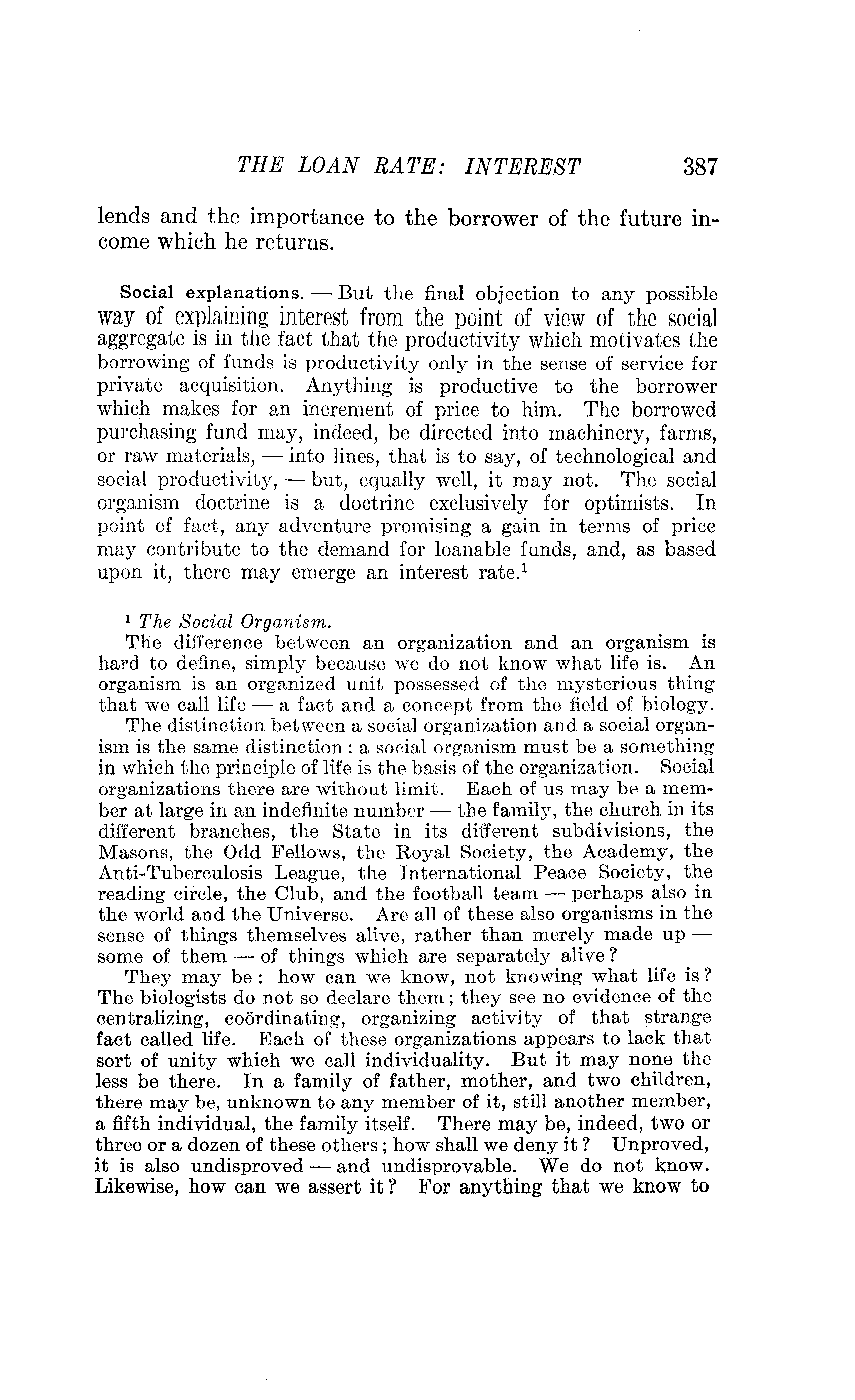

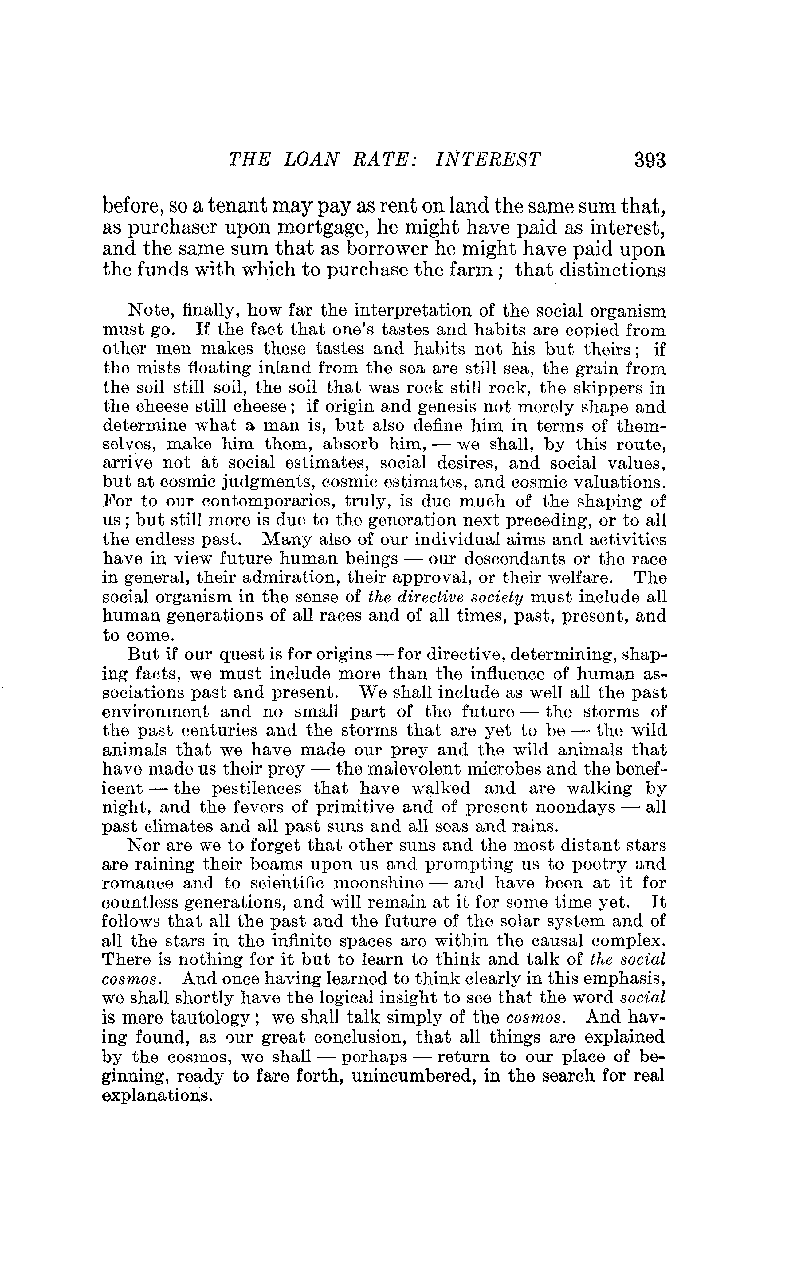

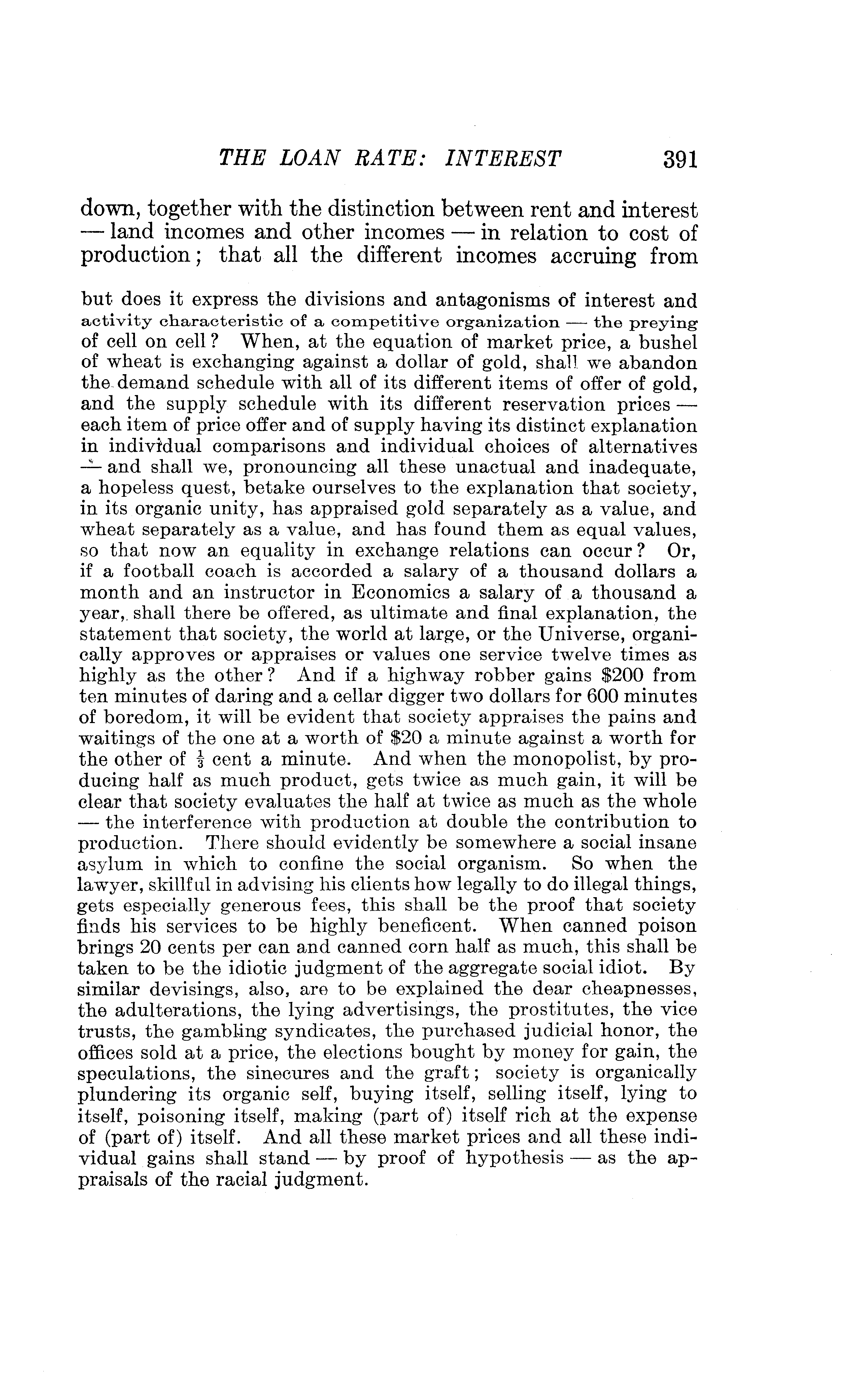

This current EPUB I am working on, it has the mother of all footnotes. It spans 7 pages:
Name:	Davenport,H.J.-.The.Economics.of.Enterprise - 387.png
ID:	113751Click image for larger version
Name:	Davenport,H.J.-.The.Economics.of.Enterprise - 388.png
ID:	113752Click image for larger version
Name:	Davenport,H.J.-.The.Economics.of.Enterprise - 389.png
ID:	113753Click image for larger version
Name:	Davenport,H.J.-.The.Economics.of.Enterprise - 390.png
ID:	113754Click image for larger version
Name:	Davenport,H.J.-.The.Economics.of.Enterprise - 391.png
ID:	113755Click image for larger version
Name:	Davenport,H.J.-.The.Economics.of.Enterprise - 392.png
ID:	113756Click image for larger version
Name:	Davenport,H.J.-.The.Economics.of.Enterprise - 393.png
<p><sup>1</sup> <i>The Social Organism</i>.</p>
  <p>The difference between an organization and an organism is hard to define, simply because we do not know what life is. An organism is an organized unit possessed of the mysterious thing that we call life — a fact and a concept from the field of biology.</p>
  <p>The distinction between a social organization and a social organism is the same distinction: a social organism must be a something in which the principle of life is the basis of the organization. Social organizations there are without limit. Each of us may be a member at large in an indefinite number — the family, the church in its different branches, the State in its different subdivisions, the Masons, the Odd Fellows, the Royal Society, the Academy, the Anti-Tuberculosis League, the International Peace Society, the reading circle, the Club, and the football team — perhaps also in the world and the Universe. Are all of these also organisms in the sense of things themselves alive, rather than merely made up — some of them — of things which are separately alive?</p>
  <p>They may be: how can we know, not knowing what life is? The biologists do not so declare them; they see no evidence of the centralizing, coördinating, organizing activity of that strange fact called life. Each of these organizations appears to lack that sort of unity which we call individuality. But it may none the less be there. In a family of father, mother, and two children, there may be, unknown to any member of it, still another member, a fifth individual, the family itself. There may be, indeed, two or three or a dozen of these others; how shall we deny it? Unproved, it is also undisproved — and undisprovable. We do not know. Likewise, how can we assert it? For anything that we know to</p>
 <p>the contrary, every atom in the Universe may have each its separate psychic aspect and activities — herein resting the secret of chemical affinity: their souls are drawn to one another or are seeking their mates. But is it science to assert it or to assume it? And have we thereby explained anything? One mystery is not the competent solution of another. This sort of explanation is merely pseudo-explanation — faith or metaphysics or guess. In similar jargon, principles are sometimes said to be working themselves out, or to be engaged in the process of realizing themselves. But talk like this means merely that some unknown X is doing something or other. We recall from Goethe “Men often think, if only words they hear, that therewith goes material for thinking.” So also Gilbert and Sullivan:</p>
 <blockquote> <p>“Her gentle spirit rolls</p>
  <p>Through the melody of souls; —</p>
  <p>Which is doubtless very pretty,</p>
  <p>But I don’t know what it means.”</p></blockquote>
  <p class="noindent">Nevertheless it may roll. It may be that the Universe, as a unified organized thing, is alive in every detail — an organism in the biological sense — as Pan-psychism declares to be the ultimate truth. Surely somewhere in the Universe all that there is in it has its explanation — if only we could find it. But the mere assertion of this large fact — taking it as a fact — is not an explanation of all the intermediate subordinate facts. After all, what is <i>explanation</i> in our human sense? We understand not one whit the better any single item out of a great whole, by discovering that, taking it as a whole, it stands for us as merely one gigantic flux and pow-wow. To assert this is rather so far a confession of our total lack of understanding. The social organism people greatly need to master the distinction between an explanation and a mystery. It is not the solution of a problem to give it up, nor the unriddling of your riddle to confess that you yourself have no solution.</p>
  <p class="margintop">Good rhetorical usage does doubtless permit us to speak of human beings in aggregates, with the use of a singular verb: <i>the Committee is agreed; the group disperses; Congress votes; the army is marching</i>. We may talk of public opinion, <i>esprit de corps</i>, the spirit of the times. But probably no one understands this collective use to imply or to assume organic unity.</p>
  <p>Equally well we may say that <i>the army are marching</i>, <i>the committee are agreed</i> (with one another), the proper use depending on whether the group is taken as a whole or by its constituent units; <i>the crew was exhausted</i> or <i>the crew were exhausted</i> — accordingly as we mean one thing or the other. Though the act or the situation is really one of each individual separately, there is no actual ambiguity or uncertainty involved in saying that <i>the battalion is eating dinner</i>. The activities are similar, roughly simultaneous, and are thought of in block. True, one man eats rapidly, another slowly, some little, and others much, and a few sick ones not at all, — but the expression serves, and implies its own limitations of accuracy. And so of an army, when we say that <i>it marches</i>, no doubt is even faintly suggested that each one does his own walking, works his own muscles, uses up his own tissue, and that presumably many are halt, some falling out by the wayside, while still others limp, and some swear. But no one of these differences matters for the purposes of the thought in mind. True, the expression is in strictness inaccurate, were any perversity bent on misinterpreting it. But when it comes to asserting that the army is brushing its teeth or has stubbed its toe, there is obvious difficulty.</p>
  <p>And for purposes of the accurate analysis of the price problem, there is really the same difficulty in thinking of a social coldness or hunger or desire or pleasure or pain. In the price problem, the need is to understand precisely how the particular individuals arrive at their respective demand prices. There is no one single homogeneous utility nor any one single aggregate demand price. Utility, for the purposes of the analysis, is an individual category. Even in public finance, the tax costs and the public services are ultimately individual.</p>
  <p class="margintop">It must, at any rate, be clear that if society is an organism at all, it is an organism of a very low order — like, say, the jellyfish. But it is only to the higher orders of organisms that mind and thought and purpose and will can be confidently ascribed. To interpret social phenomena in any organic sense adapted to explain them, as connoting judgment, appraisal, comparison, approval, condemnation, — the social organism must take on the attributes of personality.</p>
  <p>So far as we can make out, personality implies a distinct, separate, and centralized psychic unity, in which at least four things are essential — thought, will, consciousness, and memory. Try to make out what the <i>you</i> would be, lacking any one of these. What makes <i>you you?</i> Unconsciousness means the suspension of individuality. Perhaps thought and will are not quite so clearly essential. But, obviously enough, there is no personality without memory — the cement that binds together states of consciousness which would otherwise be unrelated. What makes the <i>you</i> of the present moment the same person with the <i>you</i> of a half year ago? Dual personality is a duality of independent memory systems. If in the next life we are to remember nothing of this one, it cannot greatly matter whether we are to live again or not; immortality, on terms of entire forgetfulness, would be a valueless gift — not the continued life of one, but the birth of some one else. So far, then, as we know, there is no social organism in the sense of a personality fulfilling this fourfold test — fulfilling, indeed, any one of the four tests.</p>
  <p class="margintop">Not the less, however, must it be frankly admitted that a mere hypothesis, as sheer assumption, if it offer a working explanation of facts which otherwise must go without explanation, becomes thereby something more than mere hypothesis or assumption. That it fits the facts, harmonizes them, unifies them, makes them consistent when nothing else will, is some inductive support of its truth. On these terms, any hypothesis, however tentative, may stand, pending the coming of something better. The organic hypothesis may, in truth, be so far better than nothing. But not much better; it leaves us in the unsatisfactory position not only of affirming that of which we can have no knowledge — which is bad — but of affirming a thing of which we also affirm that we can never have any knowledge — which is worse.</p>
<p>But will the social organism hypothesis meet this test of sole unifier of the facts? Are there other possible explanations? Are we yet compelled to resort to these devices of speculation and quasi-explanation? It is at any rate a crass abuse of hypothesis if it be made to stand as an obstacle in the way of the search for an explanation in terms of what is already known. A hypothesis can never be employed as the refutation of any offered explanation, as answer to it, or defense, or objection; it holds its place by tolerance — by the mere negative fact that nothing else is available. It has no evidential quality or argumentative validity. It is rather a standing promise of abdication in favor of anything that can make an affirmative case. It is an invitation and an exhortation to continued research and to constructive effort.</p>
  <p class="margintop">Does, then, the social organism hypothesis fit the facts of a competitive society? It might do well enough — if nothing else would — for the collectivist or socialistic form of organization; but does it express the divisions and antagonisms of interest and activity characteristic of a competitive organization — the preying of cell on cell? When, at the equation of market price, a bushel of wheat is exchanging against a dollar of gold, shall we abandon the demand schedule with all of its different items of offer of gold, and the supply schedule with its different reservation prices — each item of price offer and of supply having its distinct explanation in individual comparisons and individual choices of alternatives — and shall we, pronouncing all these unactual and inadequate, a hopeless quest, betake ourselves to the explanation that society, in its organic unity, has appraised gold separately as a value, and wheat separately as a value, and has found them as equal values, so that now an equality in exchange relations can occur? Or, if a football coach is accorded a salary of a thousand dollars a month and an instructor in Economics a salary of a thousand a year, shall there be offered, as ultimate and final explanation, the statement that society, the world at large, or the Universe, organically approves or appraises or values one service twelve times as highly as the other? And if a highway robber gains $200 from ten minutes of daring and a cellar digger two dollars for 600 minutes of boredom, it will be evident that society appraises the pains and waitings of the one at a worth of $20 a minute against a worth for the other of 1/3 cent a minute. And when the monopolist, by producing half as much product, gets twice as much gain, it will be clear that society evaluates the half at twice as much as the whole — the interference with production at double the contribution to production. There should evidently be somewhere a social insane asylum in which to confine the social organism. So when the lawyer, skillful in advising his clients how legally to do illegal things, gets especially generous fees, this shall be the proof that society finds his services to be highly beneficent. When canned poison brings 20 cents per can and canned corn half as much, this shall be taken to be the idiotic judgment of the aggregate social idiot. By similar devisings, also, are to be explained the dear cheapnesses, the adulterations, the lying advertisings, the prostitutes, the vice trusts, the gambling syndicates, the purchased judicial honor, the offices sold at a price, the elections bought by money for gain, the speculations, the sinecures and the graft; society is organically plundering its organic self, buying itself, selling itself, lying to itself, poisoning itself, making (part of) itself rich at the expense of (part of) itself. And all these market prices and all these individual gains shall stand — by proof of hypothesis — as the appraisals of the racial judgment.</p>
  <p>But to many men who accept the point of view of the social organism, the foregoing criticism will appeal as mere travesty. They mean none of the things charged against them. They do not take society to be a great animal — either male or female, or both or neither. All that they mean is that men in society are in mutual relations of influence and interaction, that each man has truly his individual tastes, choices, desires, demands, costs, sacrifices, hopes and fears, but not separately in the sense that any one is free from the influence of others and of their shaping power — free, that is, from the social <i>milieu</i> in which he has lived. We want clothing as much because other people’s glances beat upon us as that the sun’s rays scorch us. We desire the admiration, the approval, the fear, and the envy of our fellows. Of this sort may be most of the significance of palaces, carriages, champagne, or neckties. We never act or think or feel in isolation. We are individuals <i>in a society</i>. In a sense, therefore, the individual’s desires are social in their derivation: Utility to the individual is a social utility.</p>
  <p>That so much as this is true must be admitted; and let it forthwith be added that no one ever doubted it. But when one has a desire — no matter whence it came — it is his desire, and not the desire of the world at large. No matter when or where or how you get hungry, it is now your hunger, and not the hunger of the fresh air or the long walk that gave it to you. It may, indeed, be due to the fact that you have seen others eating. Even the feeling of being cold may be social in its occasion. But your cold is not thereby a social cold. You may, in truth, feel so much the colder as you see the people about you the more snug and smug. Your cold does not then translate into a social warmness. Your piety, again, may have been taught you; but it is not now the piety of your parents, or of the neighborhood, but only of yourself — even as a breakfast to which all climates have contributed is one man’s breakfast rather than an international breakfast. Perhaps your brother’s impiety has come as a reaction against the overpiety of his neighbors; but it is not now either a social piety or a social impiety. If you get the bubonic plague <i>via</i> some international rat, it will not be Asia or the rat or the world, but you that will be sick; and if you die, the funeral rites will be said over you. The resultant from a parallelogram of forces is not all of the contributing directions at once, but one definite new direction.</p>
  <p class="margintop">Note, finally, how far the interpretation of the social organism must go. If the fact that one’s tastes and habits are copied from other men makes these tastes and habits not his but theirs; if the mists floating inland from the sea are still sea, the grain from the soil still soil, the soil that was rock still rock, the skippers in the cheese still cheese; if origin and genesis not merely shape and determine what a man is, but also define him in terms of themselves, make him them, absorb him, — we shall, by this route, arrive not at social estimates, social desires, and social values, but at cosmic judgments, cosmic estimates, and cosmic valuations. For to our contemporaries, truly, is due much of the shaping of us; but still more is due to the generation next preceding, or to all the endless past. Many also of our individual aims and activities have in view future human beings — our descendants or the race in general, their admiration, their approval, or their welfare. The social organism in the sense of <i>the directive society</i> must include all human generations of all races and of all times, past, present, and to come.</p>
  <p>But if our quest is for origins — for directive, determining, shaping facts, we must include more than the influence of human associations past and present. We shall include as well all the past environment and no small part of the future — the storms of the past centuries and the storms that are yet to be — the wild animals that we have made our prey and the wild animals that have made us their prey — the malevolent microbes and the beneficent — the pestilences that have walked and are walking by night, and the fevers of primitive and of present noondays — all past climates and all past suns and all seas and rains.</p>
  <p>Nor are we to forget that other suns and the most distant stars are raining their beams upon us and prompting us to poetry and romance and to scientific moonshine — and have been at it for countless generations, and will remain at it for some time yet. It follows that all the past and the future of the solar system and of all the stars in the infinite spaces are within the causal complex. There is nothing for it but to learn to think and talk of <i>the social cosmos</i>. And once having learned to think clearly in this emphasis, we shall shortly have the logical insight to see that the word <i>social</i> is mere tautology; we shall talk simply of the <i>cosmos</i>. And having found, as our great conclusion, that all things are explained by the cosmos, we shall — perhaps — return to our place of beginning, ready to fare forth, unincumbered, in the search for real explanations.</p>
I don't know... I think the best way to handle it would be at the end of the chapter with a numbered link.

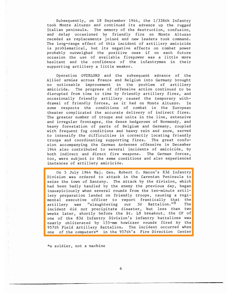

Hmmm so this was a physical/PDF book that you worked on, and changed to an EPUB? Mind posting examples of this in action (with links to the original PDF if possible)?
Here is a book I have been working on. Its footnotes are not extensive, so I have just included the footnote following the paragraph. I have uploaded the original pdf too.
I don't believe I have submitted this yet, since things have gotten a little scattered lately.
Let me know what you think. When the footnotes are at the bottom of the physical page, it means they would be several epub pages away and nearly always break a paragraph.

Thank you for the PDF/EPUB.
Perhaps we just had different definitions of what an "in-line" citation is. I always thought they went along smack dab in the middle of the paragraphs, surrounded by () or [].
In the case of this book, it has all numbered notes as Endnotes, and tiny Footnotes that are marked with asterisks at the bottom of the page.
You seem to have just placed it between paragraphs:
This is the case I mentioned above, where you could go a few ways:
  • Try to match the look of the original document
    • Your .9em at the end of the paragraph seems fine to me.
      • See potential situation below (marked with NOTE).
  • Move the asterisk/daggers to the endnotes in between the numbers they appeared.
    • This is the method that I personally use, so that all footnotes are in the same area.

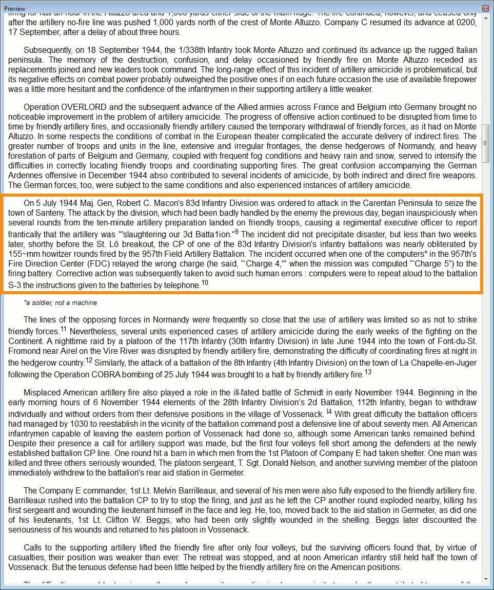

Of course, I would never break a paragraph just to stick a footnote in the "exact placement as in the physical text". If you would go the method of sticking it in the text, your placement seemed perfect to me (combine the paragraph which flows onto the next page, and add the footnote right after).
ID:	113787Click image for larger version
ID:	113788Click image for larger version
<p>On 5 July 1944 Maj. Gen, Robert C. Macon's 83d Infantry Division was ordered to attack in the Carentan Peninsula to seize the town of Santeny. The attack by the division, which had been badly handled by the enemy the previous day, began inauspiciously when several rounds from the ten-minute artillery preparation landed on friendly troops, causing a regimental executive officer to report frantically that the artillery was '"slaughtering our 3d Batta1ion."<a href="#fn9" id="ft9">[9]</a> The incident did not precipitate disaster, but less than two weeks later, shortly before the St. Lô breakout, the CP of one of the 83d Infantry Division's infantry battalions was nearly obliterated by 155~mm howitzer rounds fired by the 957th Field Artillery Battalion. The incident occurred when one of the computers<a href="#fnast1" id="ftast1">[*]</a> in the 957th's Fire Direction Center (FDC) relayed the wrong charge (he said, “‘Charge 4,"' when the mission was computed “‘Charge 5”) to the firing battery. Corrective action was subsequently taken to avoid such human errors: computers were to repeat aloud to the battalion S-3 the instructions given to the batteries by telephone.<a href="#fn10" id="ft10">[10]</a></p>
<p class="fn"><a href="#ftast1" id="fnast1">[*]</a>a soldier, not a machine</p>
<p>The lines of the opposing forces in Normandy were frequently so close that the use of artillery was limited so as not to strike friendly forces.<sup>11</sup> Nevertheless, several units experienced cases of artillery amicicide during the early weeks of the fighting on the Continent. A nighttime raid by a platoon of the 117th Infantry (30th Infantry Division) in late June 1944 into the town of Font-du-St. Fromond near Airel on the Vire River was disrupted by friendly artillery fire, demonstrating the difficulty of coordinating fires at night in the hedgerow country.<sup>12</sup> Similarly, the attack of a battalion of the 8th Infantry (4th Infantry Division) on the town of La Chapelle-en-Juger following the Operation COBRA bombing of 25 July 1944 was brought to a halt by friendly artillery fire.<sup>13</sup></p>
Personally, when I run into books with a mix of numbers + symbols, I just move the symbols notes with the rest of the footnotes. In this case, the asterisk note would be between endnote 9 + 10, and do a link back and forth from text/note:
<p><a href="#ft9" id="fn9">[9]</a> Blumenson, Breakout and Pursuit, p. 84.</p>
<p><a href="#ft10" id="fn10">[10]</a> Interview with Brig. Gen. James L. Collins, Jr., a former US Army Chief of Military History, who then commanded the 957th FA Battalion, 10 April 1980 at Fort Leavenworth, KS.</p>
Originally Posted by phossler View Post
Since this is only to make something more readable for me, MY house rules will be to choose the style that make sense one book at a time.
The way that mrmikel handled it seems fine to me.
NOTE: Although if there are a massive amount of them, I would just be be aware of the placement of all symboled notes in the middle of paragraphs.
You might have an asterisk on page 6 pointing to the last paragraph on the page, and an asterisk on page 7 pointing to the first paragraph, and a dagger on page 7 pointing to the second paragraph.
So you will have [..] + Last of page 6 + ASTERISK + first of page 7 + ASTERISK + second of page 7 + DAGGER + [...]

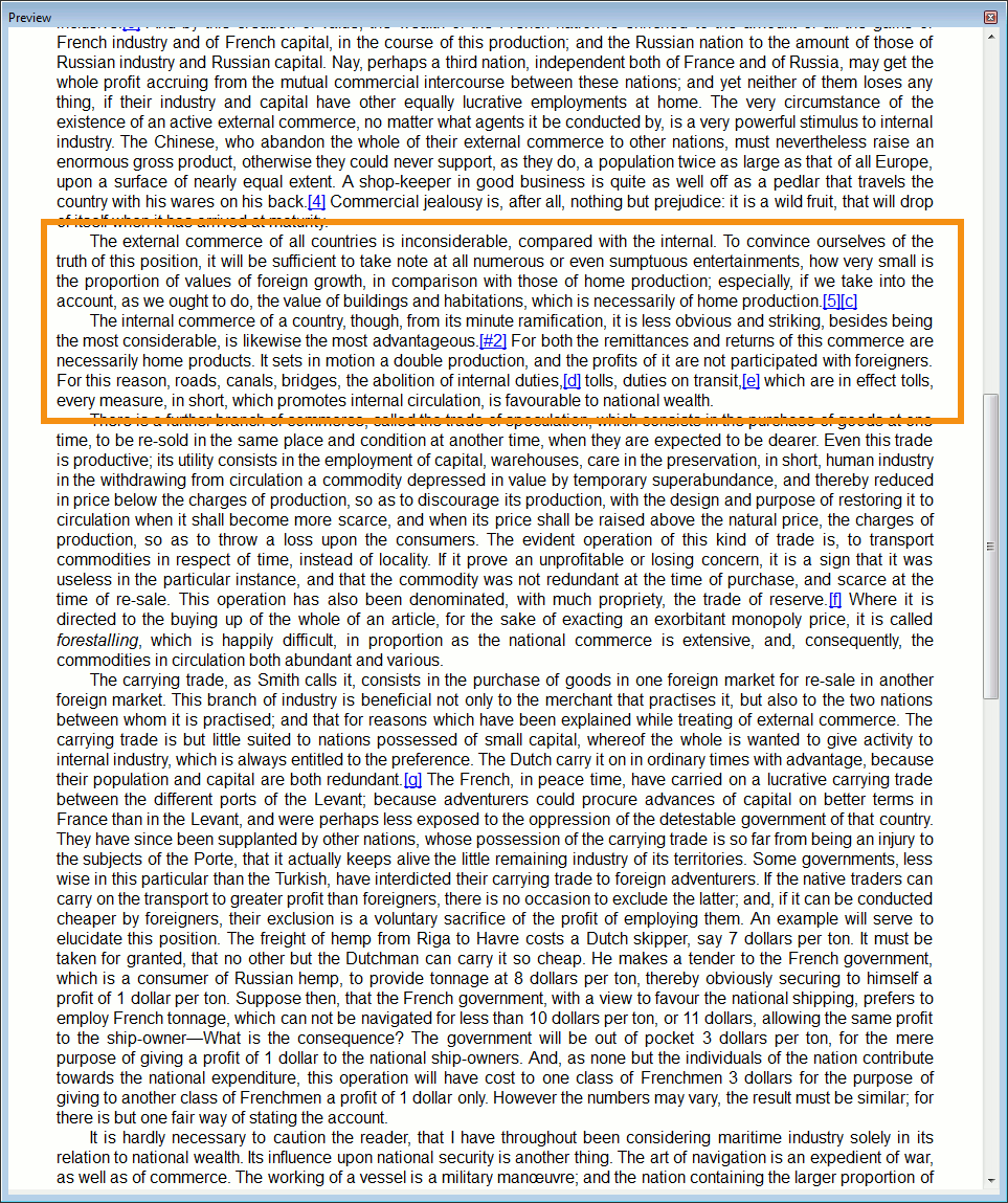

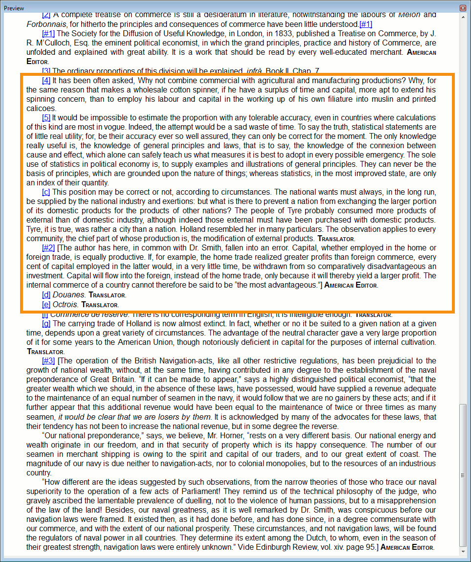

Forgive the double post, but while looking through my archives, I stumbled upon this book I completed a few months ago. A Treatise on Political Economy by Jean-Baptiste Say.
Now this is another HORROR example of footnotes. There are three sets of footnotes, and lots of footnotes in footnotes:
  • *, †, ‡ are original footnotes
    • I changed to [1] [2] [3] ...
  • (a), (b), (c) are Translator footnotes
    • I changed to [a] [b] [c] ...
  • (1), (2), (3) are American Editor footnotes
    • changed to [#1] [#2] [#3] ...
I changed everything to consecutively numbered/lettered per chapter, and placed the footnotes all in the order they appeared in the text.

I have attached the completed EPUB to this post if you are interested.
Here is an HTML version by OLL (Online Library of Liberty): http://oll.libertyfund.org/index.php...74&layout=html
Note: Their version decided to jam original+translator notes into [1]-[###], which lost the importance of which were which, and the American Editor footnotes were oddly turned into asterisks... which just makes it impossible to navigate back in an EPUB (as you can see where they stuck them, the entire section turns into "[*]" links). Plus the order the footnotes are in makes slightly more than zero sense.
Here is the cleanest PDF version on Archive.org that I based much of the EPUB work on:
https://archive.org/details/atreatiseonpoli02biddgoog
As you can see, in a situation such as this (this is really up there with the worst case footnote scenario), any sort of in-line footnotes would get wildly out of hand. While my method of sticking all of it at the end and in the order it appears to have worked out quite well.

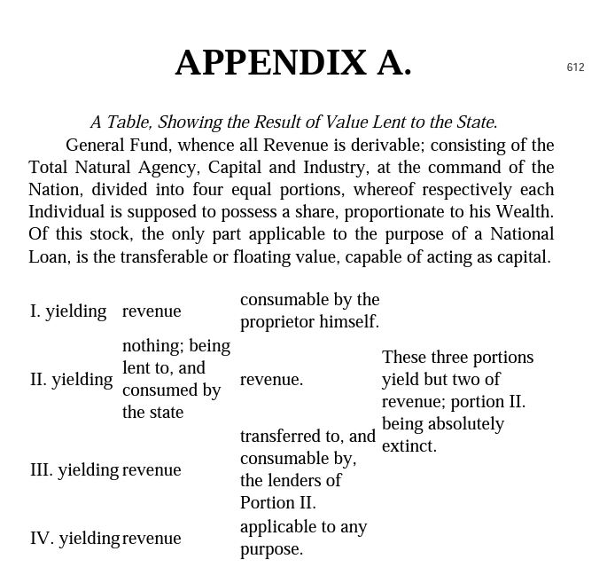

I did have a question about Appendix A. ADE displays it as in the attached screenshot, and I was wondering if the table was the way you intended?
Doesn't seem to align correctly, and I am not very good on table CSS to actually understand a lot of what you have
I was probably trying to stray from my usual table code slightly, and failing miserably.
Note: Actually, I took a look at my changelog and I spotted this:
Still could use some work on the tables, i will have to take a much closer look in the next few days. The EPUB is 99% complete though.
I guess I forgot to mark this one with [WIP].
I will maybe fix this up and get a new version out within the next few days.... but if I believe my note, it will be three more months before that table gets updated.
Do not learn table code from me, I am also horrible at tables, and am on the lookout for some good code I can commandeer and begin using.
I just use basic:
<table border="1">
<tr><th colspan="2">Table Header</th></tr>
<tr><td>Cell 1</td><td>Cell 2</td></tr>
<tr><td>Cell 3</td><td>Cell 4</td></tr>
</table>
No CSS or anything. It is hideous, but all the information is there (and that is the most important thing).
Table CSS can always be added in the future within a few minutes, as long as you have a nice, clean, consistent code as your base.
