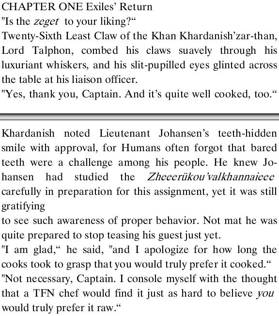

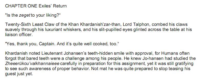

Ok, example here. And this is not even the worst, just average bad.
I REPEAT. The PDF is totally well formatted. It is not the input material that is at fault. Please look at the PDF - NOTHING WRONG WITH IT. Lrf loses most formatting nonetheless.

BlackVoid is offline   Reply With Quote
