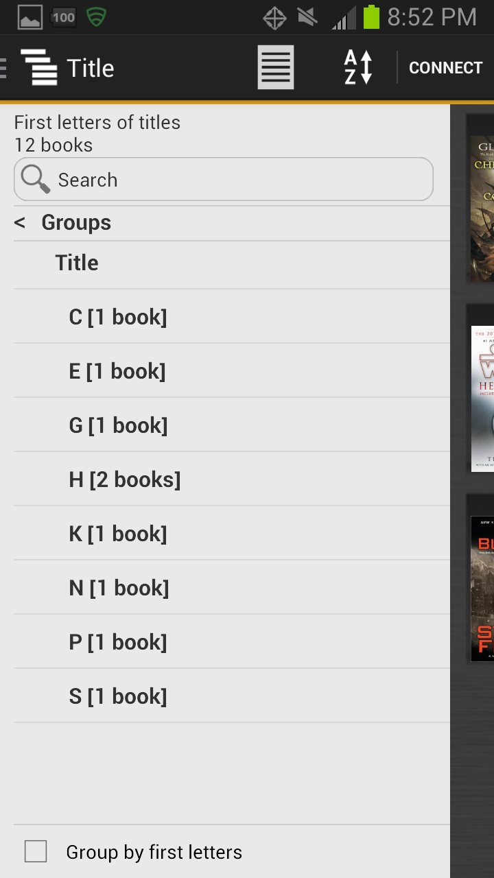

I am not certain this issue is specific to this release but it is where I noticed the issue.
When opening the grouping drawer I notice the book count is higher than the actual number of books on my device in the designated CC folder.
I have tried clearing the book database and connecting wirelessly to Calibre via CC, but I believe the issue may have been as a result of manually deleting several book files through a file explorer as opposed to CC.
Actual books: 9
Book Count listed: 12
Yup, deleting files outside of CC will result in what you see. For performance reasons CC believes its database.
You can fix this by going to CC's "Books with missing files" function, available in CC's menu (the 3 dots). You will be shown all the books in CC's database for which the book files no longer exist. Either delete the books or connect and resend them.

Book Count

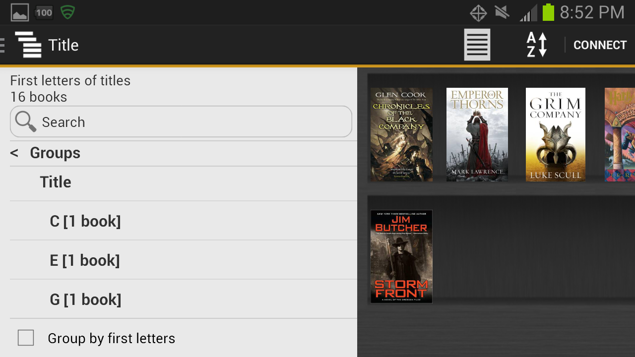

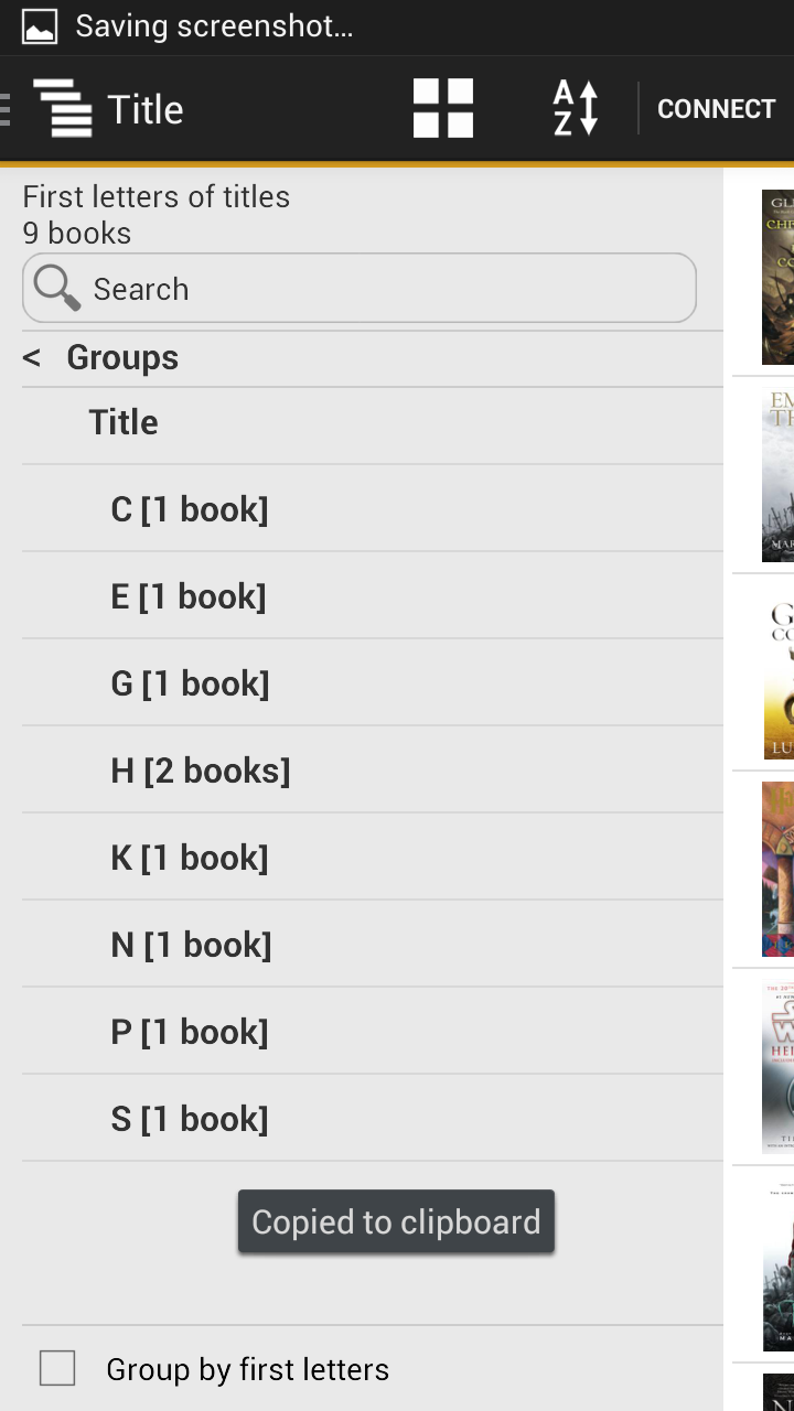

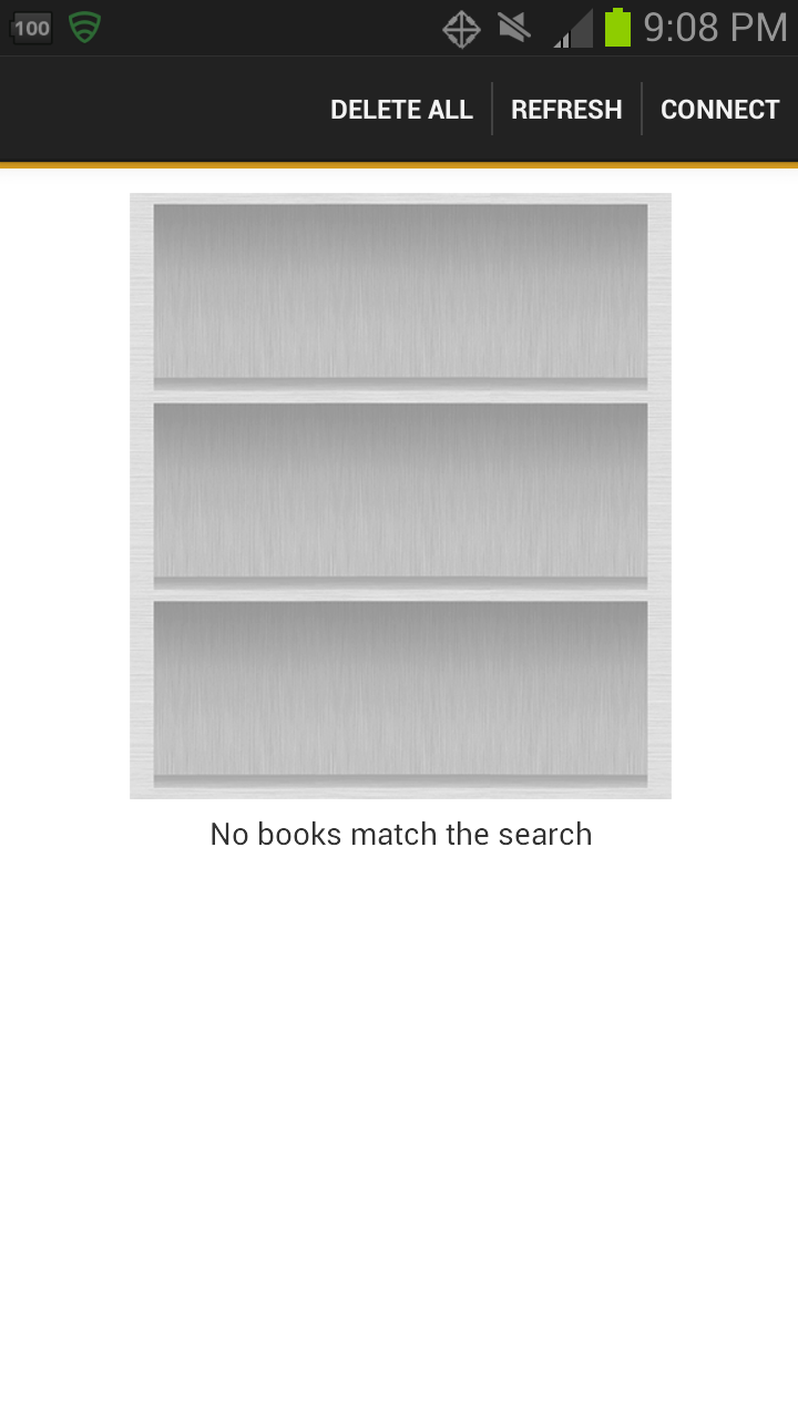

I think I've stumbled upon something more with this.
1) Selected "Books with missing files" and returned 0 results as seen in attachment 1, I went ahead and selected "Delete All" all the same.
Book count still tracking phantom books.
2) After using deleting all books from within CC, clean book database from within CC, Clearing Data from the android application manager, uninstalling CC. Reinstalling CC. Reconfiguring CC settings and connecting wirelessly to Calibre with scan on connect the book count still tracks the phantom books.
But, and this is where I thought it got interesting, as you'll see in attachment 2-5:
- While in portrait mode, list display: 9 books counted. (Correct count)
- While in portrait mode, cover grid display: 12 books counted (+3 books)
- While in landscape mode, list display: 9 books counted. (Correct count)
- While in landscape mode, cover grid display: 16 books counted (+7 books)
What all this means... do not manually delete books from outside of CC. lol. I just thought I would share this finding. It's not so much a big deal but I found it quite amusing.
Edit: These results were all taken from Galaxy S3, but replicated on my Galaxy tab 2 10.1 both running 3.1.1.
I can send a copy of the debug log, which from my initial look over, tracks 9 books, if you need.
To expand further: It appears that only when selecting a Group category such as Title, Authors, Series etc, and then a sub-group, does the book count then display the total books including phantom books. Ex: Group by Title: Entries starting with "C"
Yes, you did, and thank you for persevering.
When in grid view, the last row can have empty book positions when the number of books in the database is not an exact multiple of the number of books shown in a row. In order to ensure that the wood shelf background is displayed all the way across the screen, CC creates enough "phantom books" to fill the shelf to the end. Because it does this, when displaying the grid, sometimes (perhaps "usually" but not "always") the count of books will include these phantoms.
This will teach me to test always with hundreds of books. I had too many to notice that the sum of the grouping numbers did not always match the displayed total.
The fix is straight forward: remove the phantoms from the count. I will make another prerelease soon, probably today, that contains this fix.
