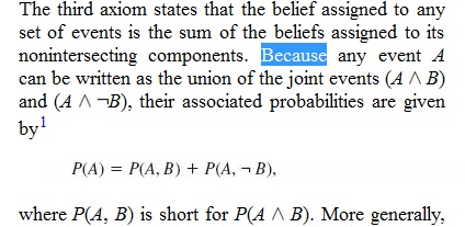

The HTML is not entirely straightforward, so I'll give a snippet of the HTML, then show how it displays.
<p class="noindent">The third axiom states that the belief assigned to any set of events is the sum of the beliefs assigned to its nonintersecting components. Because any event <i>A</i> can be written as the union of the joint events (<i>A</i> <img alt="image" src="images/And.jpg"/> <i>B</i>) and (<i>A</i> <img alt="image" src="images/And.jpg"/> <img alt="Image" src="images/arrow.jpg" style="vertical-align:2px;"/><i>B</i>), their associated probabilities are given by<a href="#fn1" id="fn1a"><sup>1</sup></a></p>
<p class="eqimage"><a id="eq0104"/><img alt="Image" src="images/eq01_04.jpg"/></p>
<p class="noindent">where <i>P</i>(<i>A</i>, <i>B</i>) is short for <i>P</i>(<i>A</i> <img alt="image" src="images/And.jpg"/> <i>B</i>).
The image for how that displays (in Calibre and in the Kobo desktop app - on the H20, it's super-tiny) is attached.
Images have different classes in the CSS file. Equations that are centered are in the class "eqimage."
However, there are also some math symbols that are inserted inline with no class as you can see in the snippet above. I can manipulate them a little using nested CSS referencing (I tried .noindent img and .indent img and it seemed to work okay on my computer, but not on the H20). And then there are figure classes as well that display okay, so I probably won't be touching them.
The CSS sheet has the following style for "eqclass":
.eqimage {margin-top:1em; margin-bottom: 1em; text-align: left; text-indent: 1.25em;}
As I said, I tried adding adding height and width here using both em and %, but it didn't actually resize the image.

Originally Posted by rashkae View Post
If the book is a kepub, (either auto synced from Kobo, or sideloaded with Calibre and the Extended Kobo Driver plugin.), then you can double tap on images to open them in an "Image viewer" That will scale them up to the size of the screen, and allow you to zoom and pan as well.
Cool! That works well for my centered equations that I have trouble reading an is a good stopgap, although it's slightly awkward to zoom in to in-line math symbols that are displayed as images, yet surrounded by normal text. Thanks for the tip.
What you have done should have worked, unless there is something else in the stylesheet that overrides it or perhaps sets max-height somewhere. I tested his and it appears to work in both ePubs and KePubs:
p.noindent img {height:1em;width:auto;}
p.eqimage img {height:auto;width:80%;}
However if the eqimage images are all different sizes then it might not look good, you would need to either go through and set a specific height to suit each individual image, or use ImageMagick to resize the jpg files instead.
Edit: Since the eqimages are actually text, they should really be proportional to the font size, so ideally you would set the height for a one-line equation to height:1em;width:auto; and set the height of multi-line equations to a multiple of 1em; then set an appropriate font-size in the parent paragraph (say font-size:1.5em; ) In this case you might also need to set the max-height and max-width to make sure the image still fits on the screen at large font sizes.
Edit2: You might not think this worth the time, but you could replace the inline images of individual symbols with actual glyphs from a font, which would look much better (it is what the publisher should have done in th first place.) Just embed a font SymFont that has all the symbols you need with @font-face, create a class like .syms {font-family:SymFont;} and then replace each <img alt="image" src="images/And.jpg"/> with <span class="syms">∧</span> etc. I do this for fiction books where the publisher has used a (usually extremely low resolution) bitmap of a letter instead of embedding a font that includes that letter. The display equations would take a lot more work though.
Edit3: Thinking a bit more about fixing up the image size used for bitmaps of equations without using SVG: The ideal is that the euation should change size proportional to the selected font size, but should not become so big that it no longer fits on the screen. The solution is to set the width proportional to the font size, but also set the max-width proportional to screen size.
For example, if the size of the bitmap was 100 pixels high and 800 pixels wide, (assuming a one-line euation) then something like this would do the job:
p.eqimage img {height:auto; width:8em; max-width:80%;}
