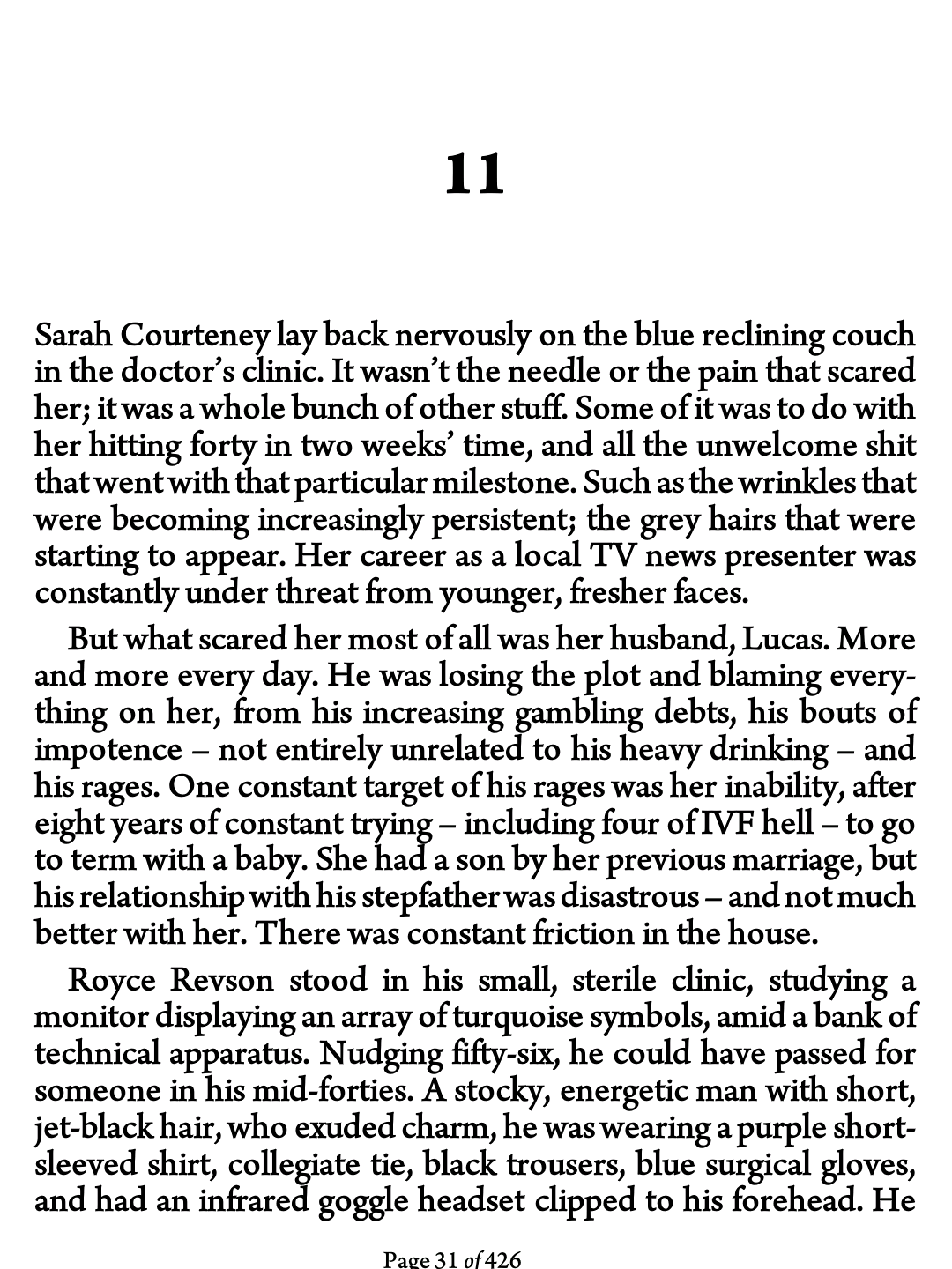

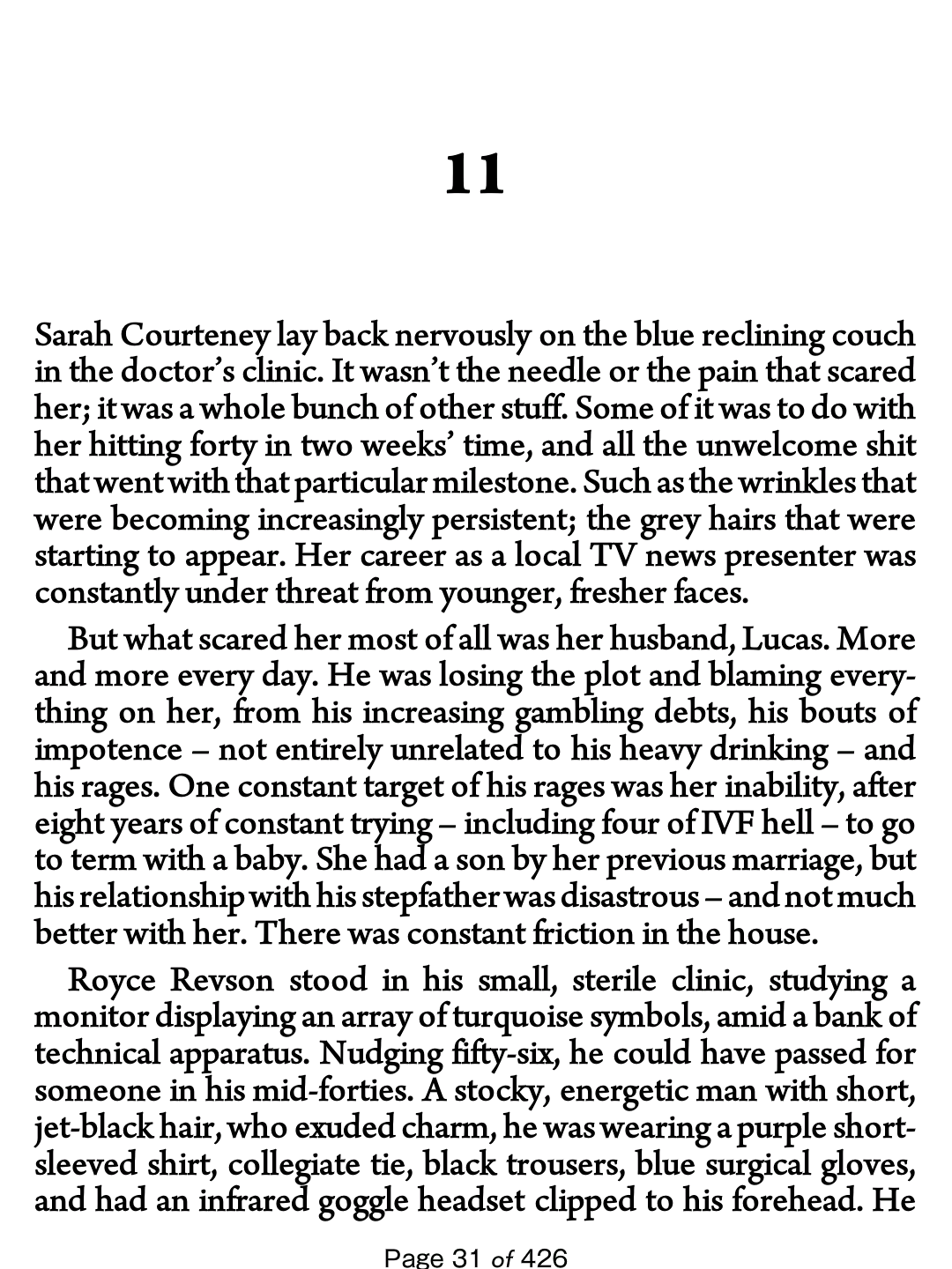

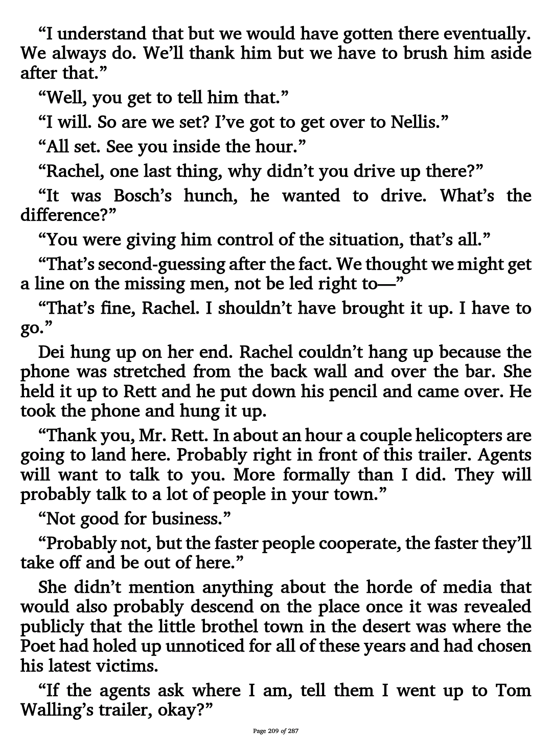

In case it helps anyone else, I'll also pass on this snippet. If you apply the patch with customised footer enabled then don't be too quick to decide that the values you have chosen are wrong. Once the Kobo has rebooted and a book is opened you may find that the 'Page x of y' runs slightly off the bottom edge of the screen. If you then open the font menu and close it again (no need to change any sliders) the font used for Page x of y should change to the one selected in the font menu. This should raise the 'Page x of y' above the bottom edge. If you then do a normal page turn the 'Page x of y' rises a little more... and then stays in the same place for all subsequent page turns.
I have not been able to reproduce this effect. Anyone else have an luck?
ShellShock is offline   Reply With Quote
Old 08-16-2013, 04:17 PM   #29
jackie_w
Posts: 6,344
Karma: 16800000
I've attached 3 screencaps of the effect I see.
From left to right:
1. Immediately after installing patch and opening a book.
2. Go into font menu and out again, changing nothing.
3. Turn the page.
Between 1 and 2 - 'Page x of y' change of font used from ??? to same as rest of text (Linux Libertine). This time around the 'Page x of y' is still slightly below the bottom of screen so I have to conclude that positioning for pic 2. is font dependent. I was using Garamond in my book when I did the initial tests.
Between 2 and 3 - Better space between 'Page x of y' and bottom of screen, no longer cut off.
