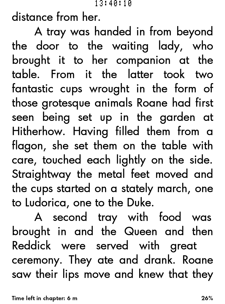

meh so I did it to show what I meant.
a learning exercise now if you can be bothered to read...
tl; dr: The extension is below.
It displays at the top.
It just parses the log and shoves up a time when the page is triggered.
I re-factored all the external scripts out and made it a one hit wonder.

Should work. Probably needs love on some devices with the showlog -f matches. feedback and testing happily accepted.
Enjoy.
If you want the display in a different place on a certain device just fiddle with the X Y on the eips.
(1st two parameters)

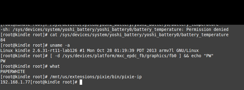

I found a small problem (not sure if small). My device is PaperWhite but it is detected as "k2 or something detected" :
if [ ! -e /proc/fiveway_wake ] ; then
echo "k2 or something detected"
echo "" > /var/log/messages; tail -f /var/log/messages 2>/dev/null | \
awk '/.*PageAction*./ || /.*acxmgrd*./ || /.*NextPage*./ || /.*Reader*./ {system("eips 40 0 `date +%H:%M`")} '
exit 0
I mean this portion of code is the one that affects the clock when I make changes. Which is probably the reason for showing the clock only when page forwards but not on page backwards.

oh.
[ -d /sys/devices/platform/mxc_epdc_fb/graphics/fb0 ] && echo "PW"
does that work? in a shell?

For now: just remove all the other "IF"s since you know what you want...
Ill post it here,.
PHP Code:
#!/bin/bash
&> /var/log/messages && 2>/dev/null tail -F /var/log/messages | exec parselog | \
awk '/.*PageTurnAction*./ || /.*JunoExecutionManager*./ {system("eips 20 0 `date +%T`")}'
just run with that.
remove everything else.
I'll think about why that might happen at some point, but that would fix it for now - to only work on a paperwhite, dumbly, without detection.
Just edit the file: /mnt/us/extensions/showtime/bin/showtime.sh
or <THE_KINDLE_ON_YOUR_PC>/extensions/showtime/bin/showtime.sh
You can run stuff directly in the backend using nilujes usbnet modification via kual or directly.from its installer. (session pictured via wifi)
