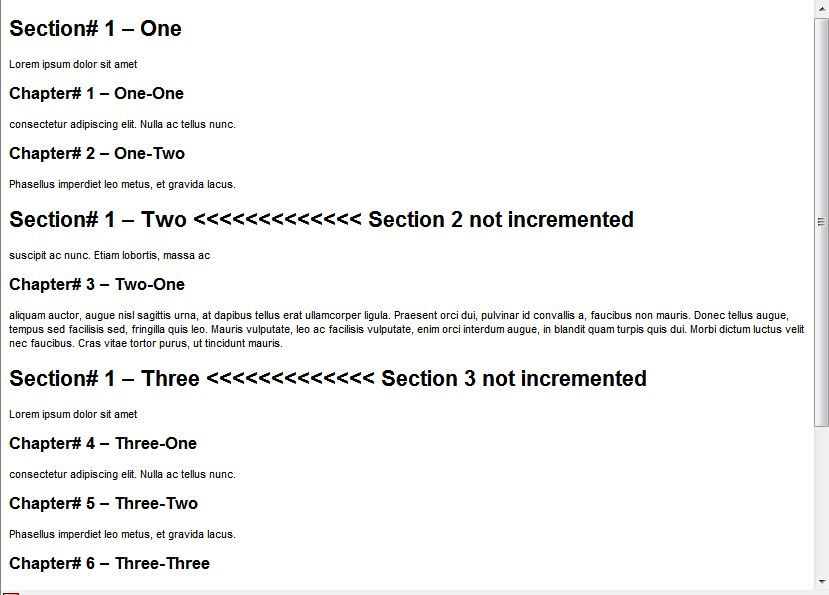

My little project is really coming togeather; your explainations have really helped a lot
So I tried emulate a numbering style that I've seen many times:
H1's = Section x
H2's = Chapter x
Except that the H2 counter doesn't get reset to 1 when the H1 changes, and the H1's continue to Increment:
Section 1
Chapter 1
Chapter 2
Chapter 3
Section 2
Chapter 4
Chapter 5
Chapter 6
It looks so easy. I have the H2's continuing to increment, but the H1 counter remains 'stuck' at 1.
Can anyone see what I'm doing wrong, or not doing right?
body
counter-reset:h1number;
counter-reset:h2number;
h1:before
counter-increment:h1number;
content:"Section# " counter(h1number) " – ";
h2:before
counter-increment:h2number;
content:"Chapter# " counter(h2number) " – ";
Thanks
Paul

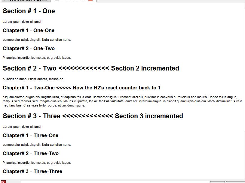

Try this
body {
    counter-reset: h1number;
h1:before {
    content: "Section # " counter(h1number) " - ";
    counter-increment: h1number;
h1 {
    counter-reset: h2number;
h2:before {
    content: "Chapter# " counter(h2number) " - ";
    counter-increment: h2number;
Based on http://www.w3.org/TR/CSS21/generate.html

Thanks, but that's pretty much where I started, before I tried to be clever
Look at the screen shot which has your CSS. The H1's increment, but the H2's reset to 1 when the H1 changes.
I was trying to get the two counters to run 'independently' without the H2 counter reseting to 1 in the h1 { } so that the H1 counter just count up, and the h2 counters also just count up
So I was trying to get an automated numbering like I saw in some books, and I decided to try getting the counter's to give me:
Section 1
Chapter 1
Chapter 2
Chapter 3
Section 2 <------ should be incremented, but remains = 1 in my CSS
Chapter 4 <----- not reset to 1, but just incremented
Chapter 5
Chapter 6
Section 3 <------ should be incremented, but remains = 1 in my CSS
Chapter 7 <----- not reset
Chapter 8
Chapter 9
If all else fails, I'll go back to the outline numbering that I know works
Paul

One final idea... Try
body
counter-reset:h1number h2number;
Also keep in mind this will ONLY work if the entire book is in a single (x)html file. As soon as you have multiples.... it will reset within each file.

All I can say is that when i tried it worked perfectly. Chapters incremented and reset and sections increased.
Could you attach a small epub so I can see how you did it?
In my test doc with your CSS, the H1's increment, but the H2's reset to 1 within each H1
I was trying to have both the H1's and H2's count up independently with out resetting so I'd end up with something like
Section 1
Chapter 1
Chapter 2
Chapter 3
Section 2
Chapter 4
Chapter 5
Chapter 6
Section 3
Chapter 7
Chapter 8
Chapter 9
Paul

See attached
Section #1 - One
Chapter #1 - One-One
Chapter #2 - One-Two
Section #2 - Two
Chapter #3 - Two-One
Section #3 - Three
Chapter #4 - Three-One
Chapter #5 - Three-Two
Chapter #6 - Three-Three
Section #4 - Four
Chapter #7 - Four-One

Works well
Thanks for your efforts
Paul
Old 07-06-2013, 06:28 PM   #24
PeterT
Posts: 14,174
Karma: 84699244
Location: Toronto
All I changed was to put the two counter-reset's for body in a single CSS statement....
