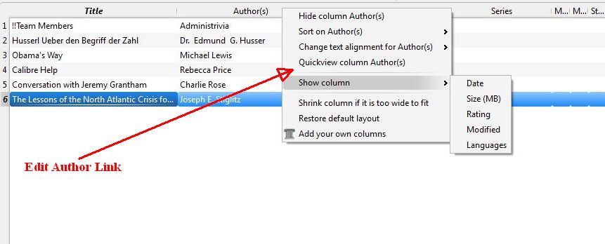

Links are only available on Authors (I mistakenly thought they were also available on Publishers and Series) - see attachment for what I was thinking - not sure what one would do about multiple authors - I'll leave that to the developers to fathom
If the Enhancement in the following launchpad request is forthcoming then I'd use it most of the time. It gives a separate link for each author which sidesteps the multiple author issue mentioned above ==>>> https://bugs.launchpad.net/calibre/+bug/1186192
In light of the multiple authors issue perhaps putting Edit Author Link in Author(s) Title context menu may not be worth the effort - especially if it can be done from book details.
Name:	Screenshot - 2013-06-01 , 08_30_03.jpg
