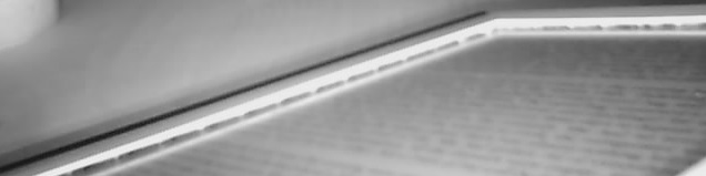

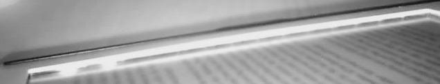

That shot is of the top, will see if I can get a similar shot of the sides and bottom to see if they have emitters as well.
Edit: There are emitters on all four sides, they must be slightly offset so there would be a very tight pattern of lines going across the screen. That or some of the light sources are reflected light, I really can't be sure but they look like light sources.
Note the larger light spots are reflections from the red light source on the camera itself.

My IR cameras arrived today and if I angle it just right, so their is no reflection from
the camera's own IR emitters, I can see the spaced dots like those posted.
Well it looks like another cleaning is in order.
