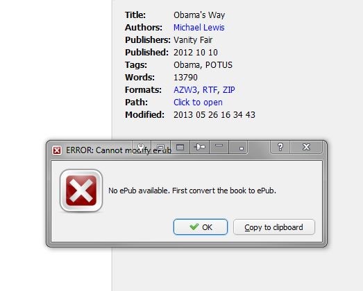

I'm unable to run Modify ePub on a Book than does not have an EPUB
Calibre 0.9.32, Modify ePub 1.3.7
Is there another Modify, other than this one https://www.mobileread.com/forums/sho...d.php?t=154371 ?

Sorry, I'm getting confused. It's "Tweak Book", not "Modify", that also works with AZW3. That's not a plug-in, but a standard feature of Calibre.
