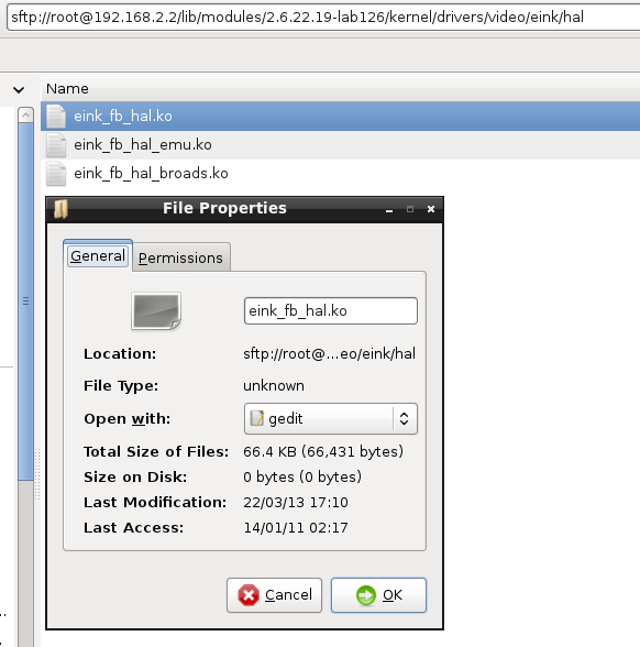

twobob: You should get an inverted screen by running this command:
echo "19 15 14 13 12 11 10 9 8 7 6 5 4 3 2 1 0" > /proc/eink_fb/update_display
If you don't, it seems the new driver didn't get applied. Please check the size of /lib/modules/2.6.22.19-lab126/kernel/drivers/video/eink/hal/eink_fb_hal.ko which should be 66431 (original is 65936).

okay Ill test that now...
Didnt seem to do anything...
Size of file in question pictured.
File attached.
