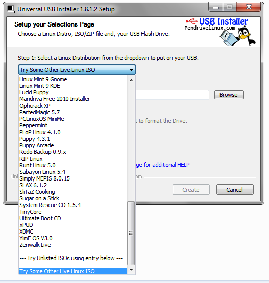

Originally Posted by joseludi View Post
I've tried with Universal USB Installer, but without any success. This program doens't recognize the iso file.
try with the latest option:
you can use "linux live usb creator" also
thomass is offline   Reply With Quote
Attachment 101530
I'll try this afternoon. Thanks
