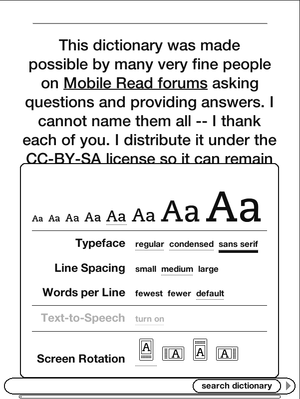

I have been able to create a KF8 mobi with an embedded font (attached). It renders correctly on my Kindle:
Name:	Zoomed screen_shot-37628.gif
But when attempting to embed the same font in my dictionary I have the following warning
 Amazon kindlegen(Windows) V2.8 build 0208-797bf75
 A command line e-book compiler
 Copyright Amazon.com and its Affiliates 2013
Info:I9007:option: -c2: Kindle Huffdic compression
Info:I9014:option: -verbose: Verbose output
Warning(parser8):W26001: Index not supported for enhanced mobi.
Info(parser8):I12001: Enhanced mobi generation suppressed.
Info(prcgen):I1041: The file format version is V7
Info(prcgen):I1031: Saving PRC file
Info(prcgen):I1032: PRC built successfully
Info(prcgen):I1036: Mobi file built successfully
Apparently, when Kindlegen detects indexing --the essence of dictionaries-- it downgrades to KF7 file format. I have seen similar reports in the Mobi/Prc Books forum.
Is there a way to bypass this problem? My future v0.5 dictionary needs this font to properly render Klingon translations!
BTW When opening the KF7 document with the (unreliable) Kindle Previewer, characters are correctly rendered using the embedded font:
Name:	Kindle Previewer.jpg
But the Kindle physical device refuses to use the font because the book's file format is not KF8.
Last edited by PoP; 02-26-2013 at 03:39 PM. Reason: Removed attachment. Grab the latest Klingon.mobi from first post.

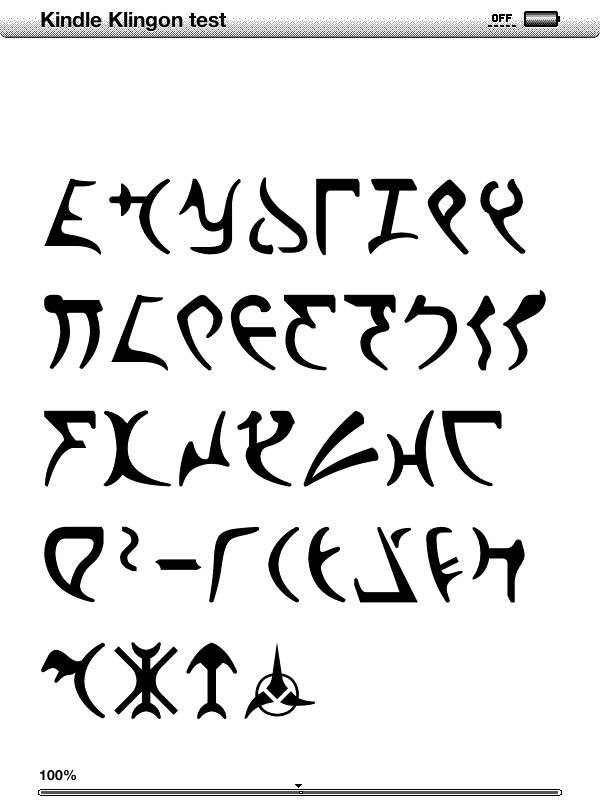

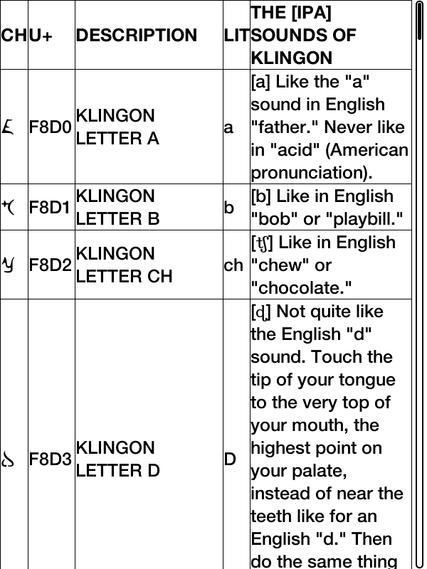

If you really want to generate a Kingon dictionary for the Kindle, you're in luck. Thanks to the code2000.ttf fallback font, eInk Kindles support most Klingon glyphs (and glyphs for most Tolkien conlangs) out of the box.
However, they're encoded in the Private Use Area (F8D0 - F8FF) and both books and dictionary obviously would need to use the same encoding.
(The source files are embedded in the .mobi file; use 7Zip to extract them.)

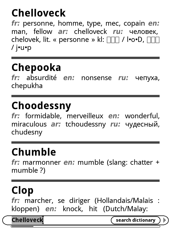

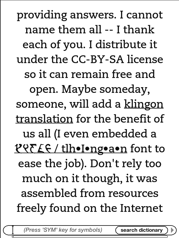

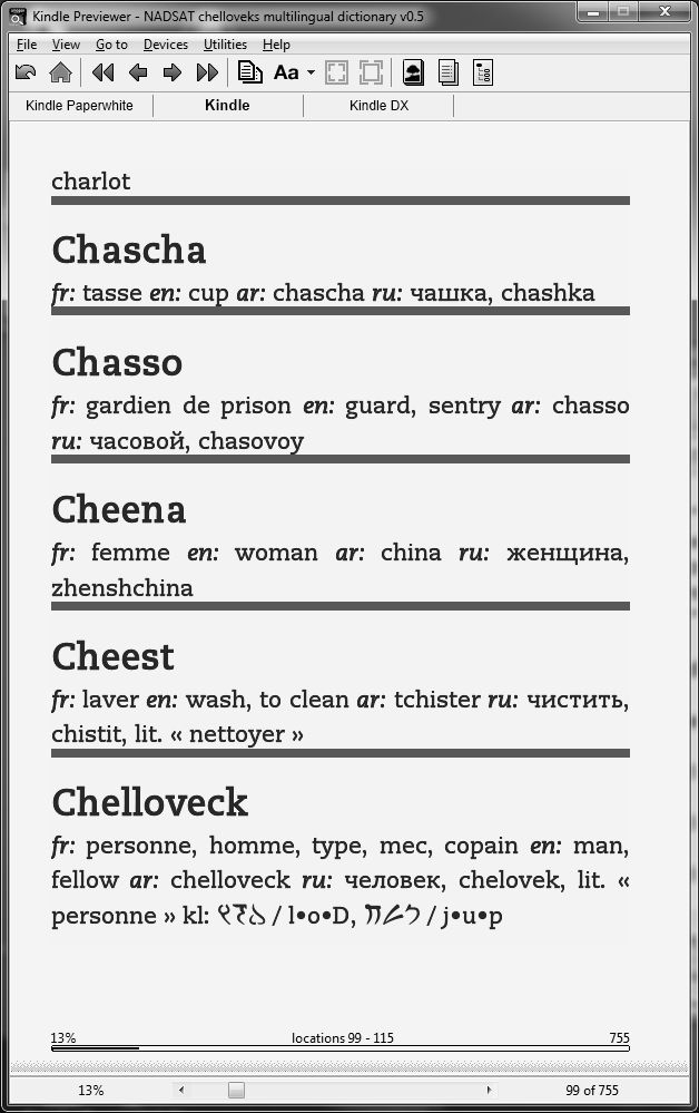

Exactly Doitsu! How about that : I previously went to the trouble of embedding my font for nothing. Just by luck the klingon glyphs are already present in the fallback builtin font and since I am already using the U+F8D0 to U+F8FF encoding, once I remove my embedded font everything is still rendered perfectly for that "ordinary" book.
But my original problem remains, it is within a "dictionary" that I want to display these glyphs. And I think that unless I can produce a KF8 dictionary (Kindlegen seeing indexing only creates a KF7 mobi) the fallback font is not used. See Chelloveck :
On Kindle Keyboard 3.4 Click image for larger version
Name:	Kindle Keyboard screen_shot-37636.gif
ID:	101863 vs Kindle Previewer Click image for larger version

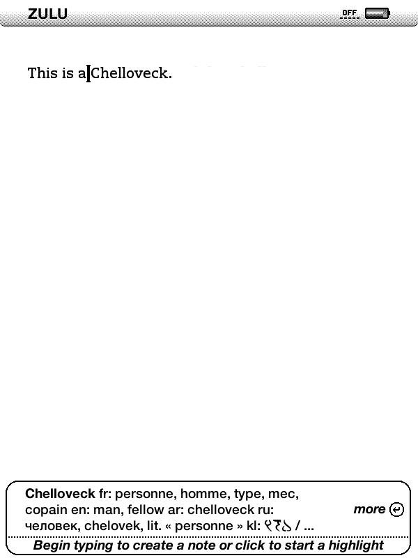

I had a look at the source files and noticed some syntax errors in the .opf file.
After commenting out the .ncx, script and font sections, it seems to work.
Fantastic Mobi Master. I will study the corrections and will do-it-so.
Initialy your .mobi gave me the same problem. But then, I removed the (Droid) font hack I had installed and everything started to work fine after. Also, my original .mobi (the one with the syntax errors) now works fine too!
Looks like the builtin fallback font is possibly overridden by the fonthack.
Again thank you very much for the big help.

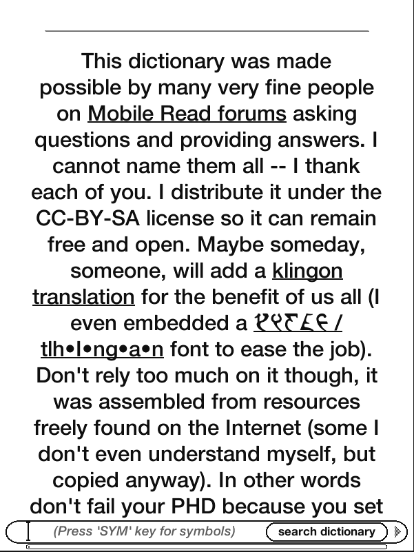

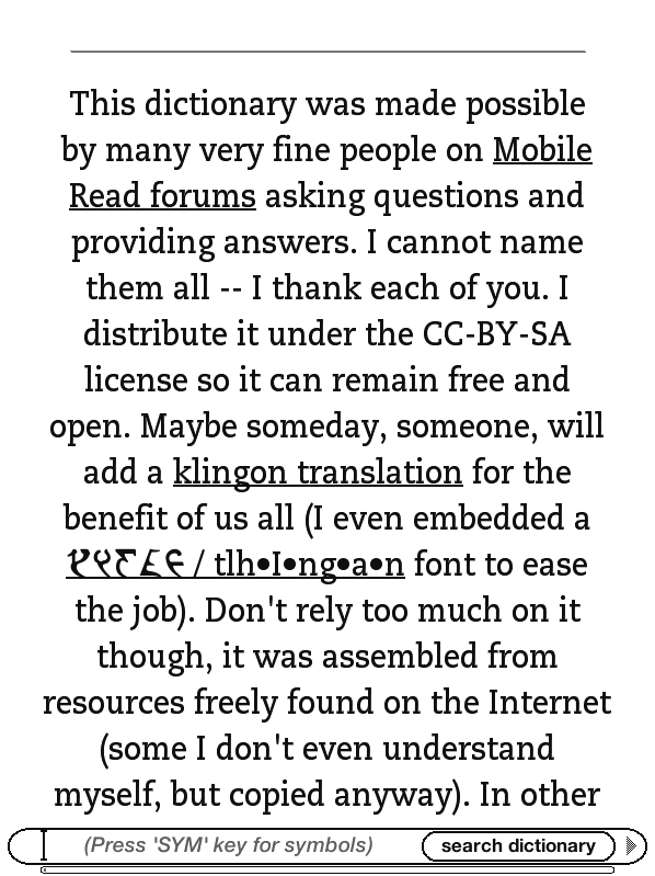

LOL... not sure how I managed it.. but... when I downloaded the klingon.mobi I must have had two copies...
so it became:
/home/me/Downloads/Klingon (2).mobi
I threw it onto the KINDLE TOUCH device via SSH AND IT REBOOTED!!! HAHAHAH! perhaps it was the mangled name ??
anyways. no harm done. seems to be fine now. just thought I would share.
(oh the image looks a bit small on the touch) [picture 1]
looks really nice on the 3 [picture 2]
Great work.
Grab my Klingon v0.2 mobi from a spoiler in the first post.
I changed the aspect ratio of the cover (matching your's KUAL). Does the cover view look better aligned now?
I also fixed the html table size, and had fun with embedding fonts (thanks Doitsu).
