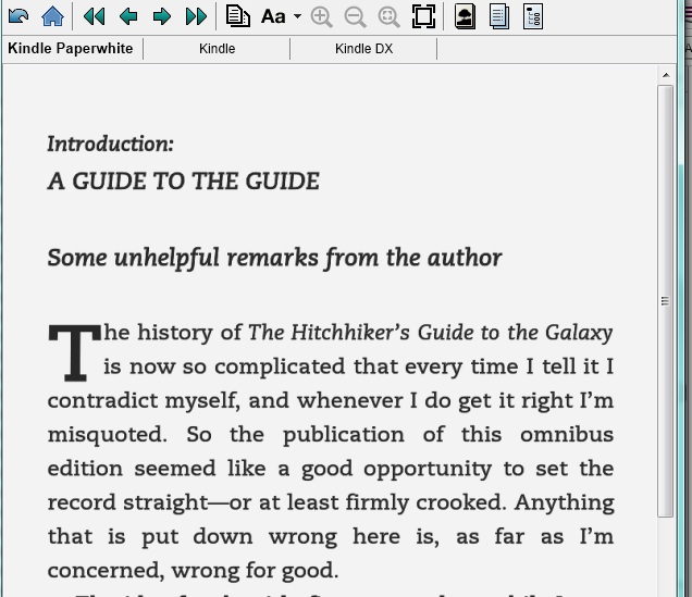

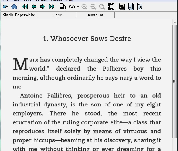

I finally did it! LOL.
After a lot of gnashing of teeth and other dramas, I finally solved the mystery of why my dropcaps had extra spaces underneath. It had to do with the margin at the bottom. Sheesh.
Anyway, here is a screencap of the final product on Kindle Previewer, with the dropcap letter finally the right size and right in place. For other noobs like me who might be interested, this is what I did.
First, I tweaked <span.dropcap> in sigil, with the following end result:
span.dropcaps {
float: left;
font-size: 80px;
line-height: 0;
padding-top: 1px;
margin-top:-.375em;
margin-bottom: -.5em;
margin-right:1.35px;
font-weight: bold;
I guess that is an ugly code, or whatever, but it worked!
Also, when converting from epub to azw3, I made sure the eighth value in the font size rescaling key was the same as my font-size (80). And voila!
So now my only issue with azw3 is the large line spacing, but I have learned to live with that. IMHO, azw3 just looks much, much better than mobi. Call me OCD but there you go.

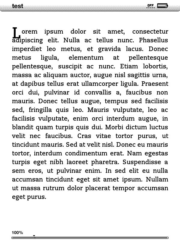

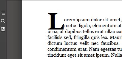

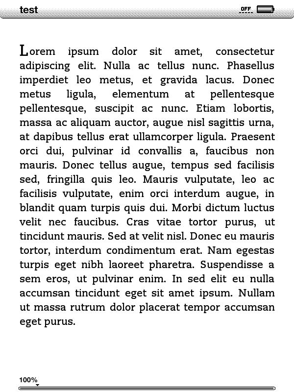

I also encountered problems with dropcaps and tested your dropcaps style. Unfortunately, it didn't work on my K3. Furthermore, it proved that the azw3 output generated by Calibre doesn't match the KF8 output generated by the latest version of KindleGen as the Kindle for PC (K4PC) and Kindle 3 (K3) screenshots show.
Can you post your test .epub?

@Doitsu, I do not think the dropcap code I used for that particular book will work for all books. but I am thinking also that there should be a "general dropcap guideline" for two lines and three lines, that should work for all epub to azw3 conversions. I am still investigating and will get back to you if I come up with a formula. I think though that you will need to tweak each book, adjusting the top and bottom margins and the dropcap size.
As for Kindlegen, I haven't tried using it yet. I will try it and get back to you here with my findings.

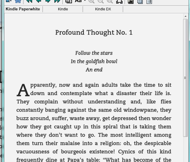

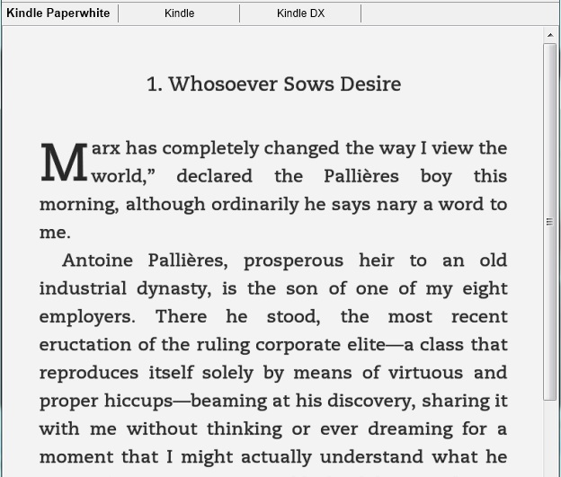

Okay I have tried Kindlegen and I don't really see that big of a difference between the Kindlegen-converted and the Calibre-converted AZW3. Maybe it has to do with the particular book you were trying to convert. Look at my screencaps.
There are some things you might be missing. One, did you tweak the 8th (last) value in the font size key in calibre? make sure it matches the size of your dropcap font that you could see in sigil. For instance, if the dropcap size in sigil is 3em, your 8th value should be 48 because (I think) the values here are in px.
Two, what about your other settings in Calibre? In Look and Feel, here are my settings (only for books with dropcaps):
disable font size rescaling unchecked
base font size: 16
font size key: 12.0, 12.0, 14.0, 16.0, 18.0, 20.0, 22.0, 48.0 -->>change the last value depending on your dropcap font size)
minimum line height: 120%
Line size, line height and everything else zero or blank
Also, your ebook will look different in sigil and calibre (and maybe also kindle for pc -- I didn't even know that kindle for PC could now read AZW3.) Try using Kindle Previewer.
Finally, here is another dropcap code you could try to use. This is the one I used for this particular ebook:
.drop {
float: left;
font-size:3em;
margin-top: -.3em;
margin-right: .05em;
Good luck!
