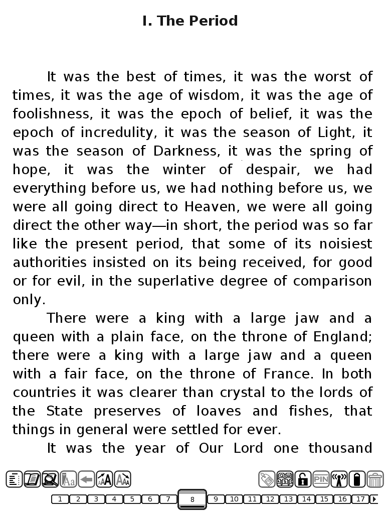

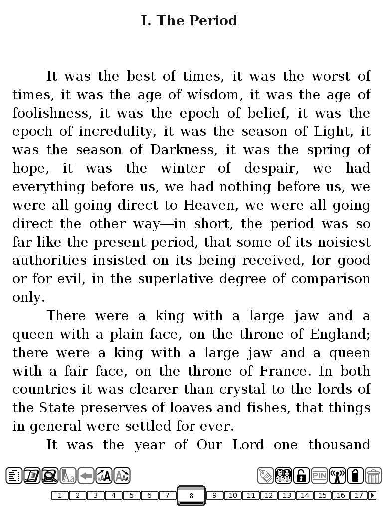

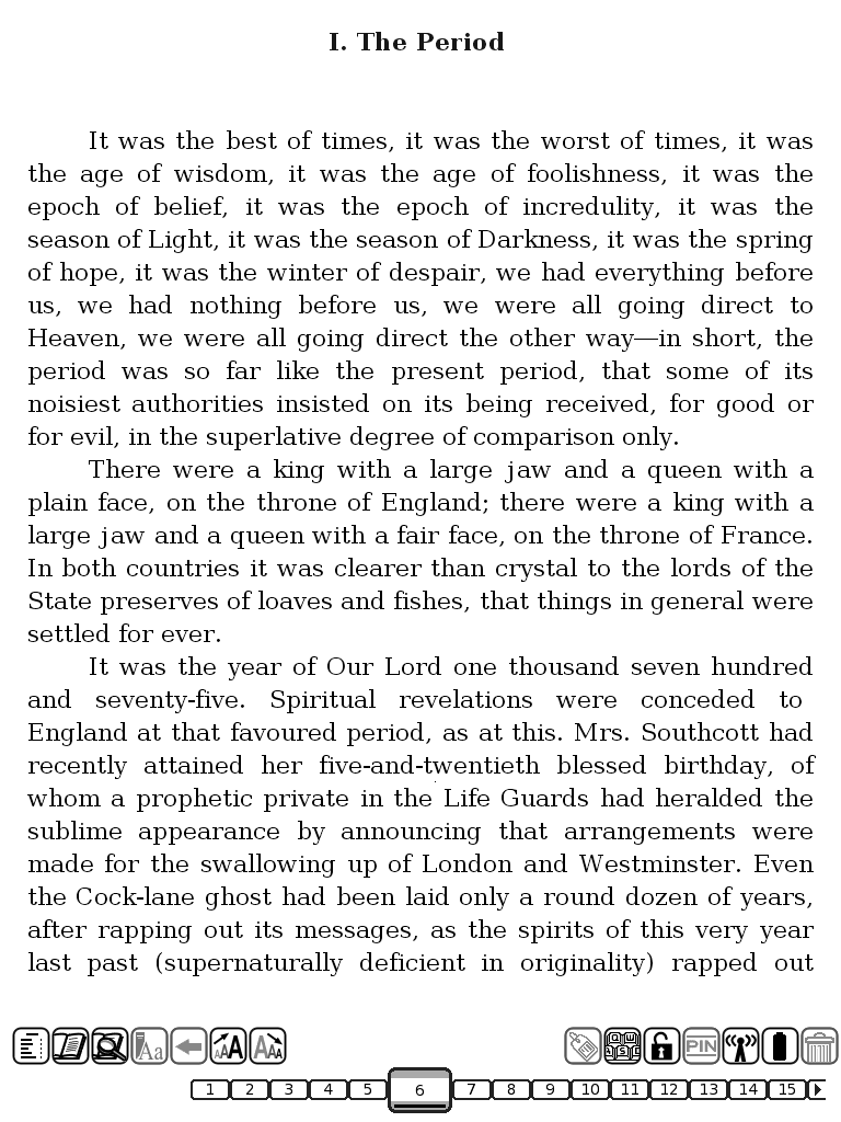

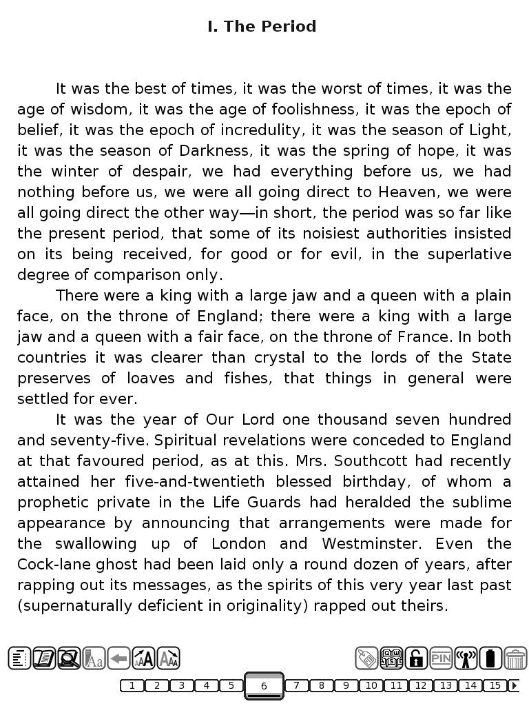

Originally Posted by serge View Post
cp /home/intent/mobipocket.param /home/intent/mobipocket.param.bak
rm /home/intent/mobipocket.param
and try again.
I found that I needed to do this, so I added it to Adam's scripts. See the enclosed zip file.
I enclose screenshots from the Sans Serif and the Serif font at two sizes. As usual, if the image seems ragged is has been rescaled by your browser - click on it again to get the full size version.
The Sans Serif fonts appears to be DejaVu Sans, and the Serif font is Bitstream Vera Serif. There is also a Bitstream Vera Sans font, but (based on FBReader) it seems similar, or identical, to DejaVu. One difference is that Vera has a genuine bold face, but I don't think MobiPocket is recognizing anything except "sans" and "serif" for the font.
FBReader can also use the type1 fonts that are installed on the iLiad, but I can't get MobiPocket Reader to recognize these. The font I usually use for FBReader is Nimbus Sans L, but it is a type1 font.

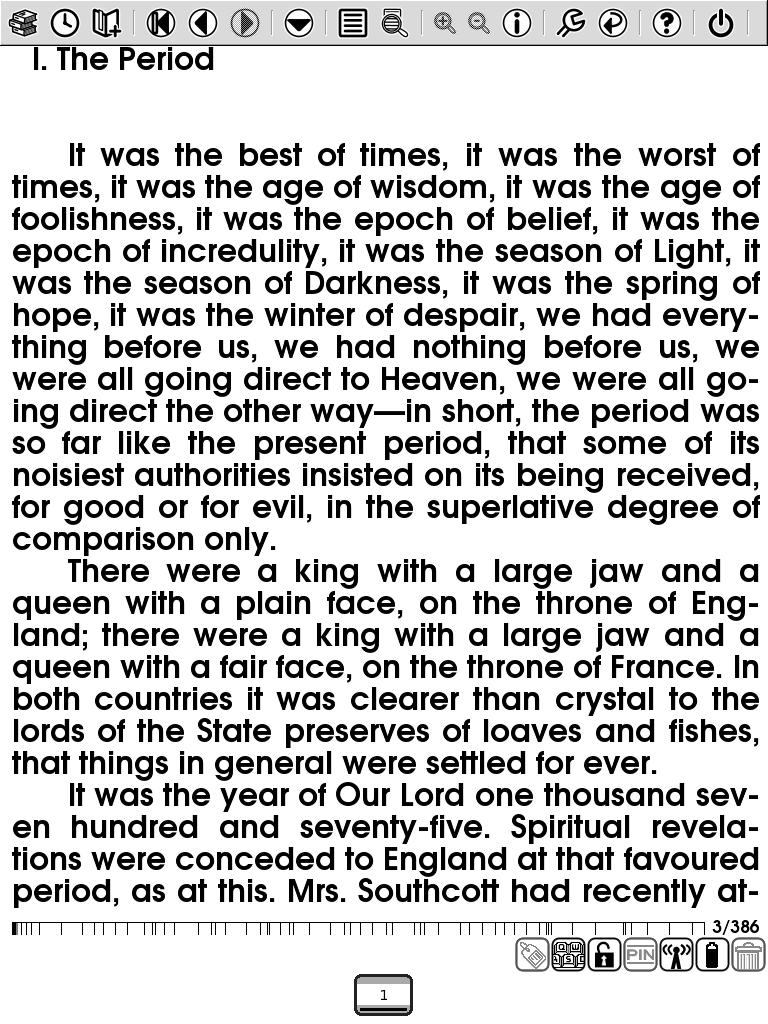

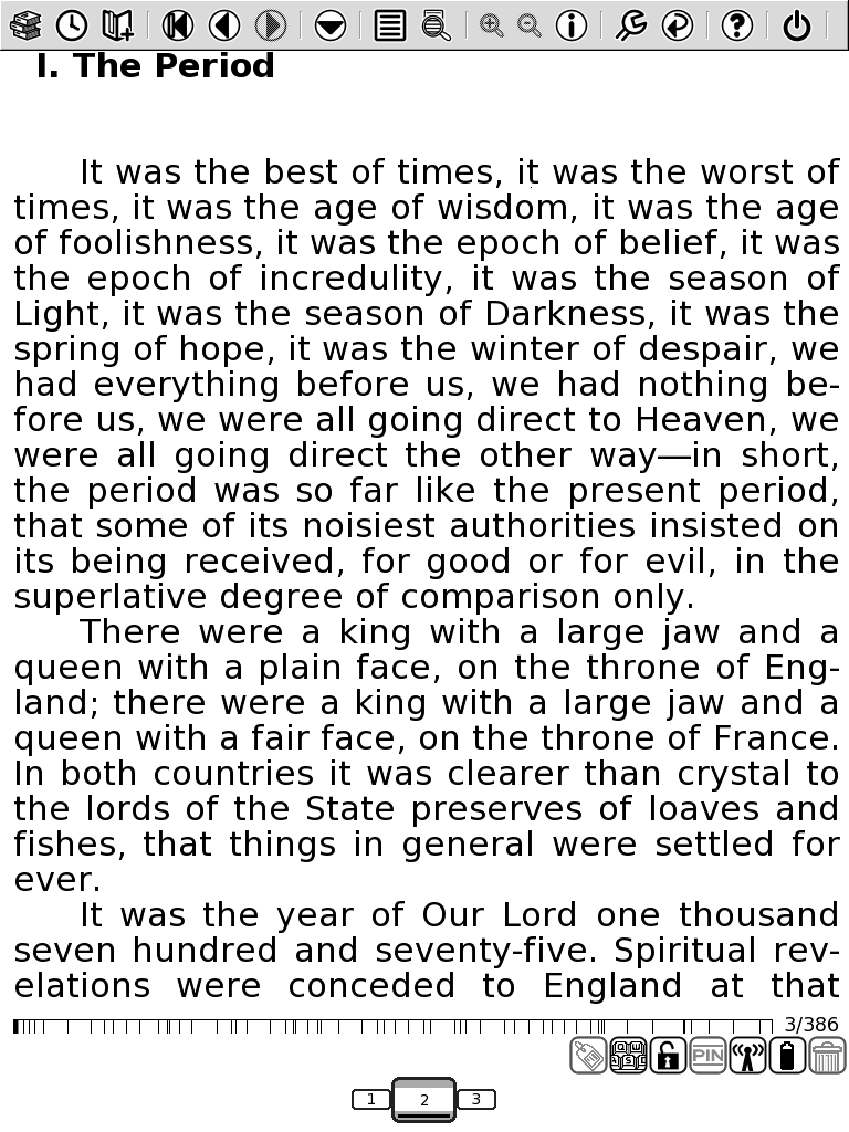

Does anyone know how Java (i.e. the MobiPocket Reader) handles fonts?
I would really like a bolder font for the Reader. The obvious choice is Arial Black, but that is an OpenType font. I have found URWGothicL-Demi.ttf works well in FBReader. I am currently installing it on the CF card, and I have not been able to get MobiPocket Reader to recognize this font. The screenshots are from Bitstream Vera Sans and URWGothicLDem in FBReader. Note that in FBReader, I could just select bold as the default - so there is less need for a heavy base font. I am using these screenshots as proxies for MobiPocket Reader, although I have not tried to replicate its margins and line spacing.
ID:	10488   Click image for larger version
