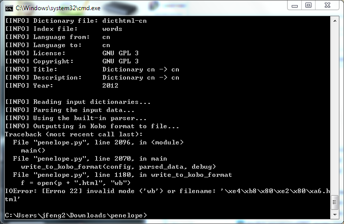

Hi tshering, now I am converting a chinese-to-chinese dictionary and a chinese-to-english dictionary. However, I always get a error during converation as shown in attatchment picture and it seems like a filename coding issue. I wander if you have some experience about this and could give me some hints? Thanks!
I did not use penelope (therefore I do not know how it works), and I know as much as nothing about py. Did you read the exchange with Olderzeus in the current thread? He says something about changing the codepage. I am not sure whether this was only necessary because of his local settings? Maybe this is a point you can start with?

I have created my "dicthtml.zip" file in ubuntu, however it doesn't work... for my test, your chinese-to-english dictionary doesn't work on my HD 3.12.0. Could you check it?

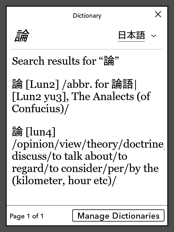

The file name has to be dicthtml-ja.zip, no other name works. I checked my chinese-to-english again, although with a Japanese book, since I do not have a Chinese on my reader. Simplified Chinese is also supported, but having only Japanese books, I cannot demonstrate it now (Edit: But cf. the examples in this post).
ID:	132691   Click image for larger version

Yes, when I change my book languange to ja, it works. another question, did you ever find the parameters to control the frame size of dictionary lookup? Because the fonts in this frame are patched to became larger, so the frame is too small for fonts size and can contain only a few of text.

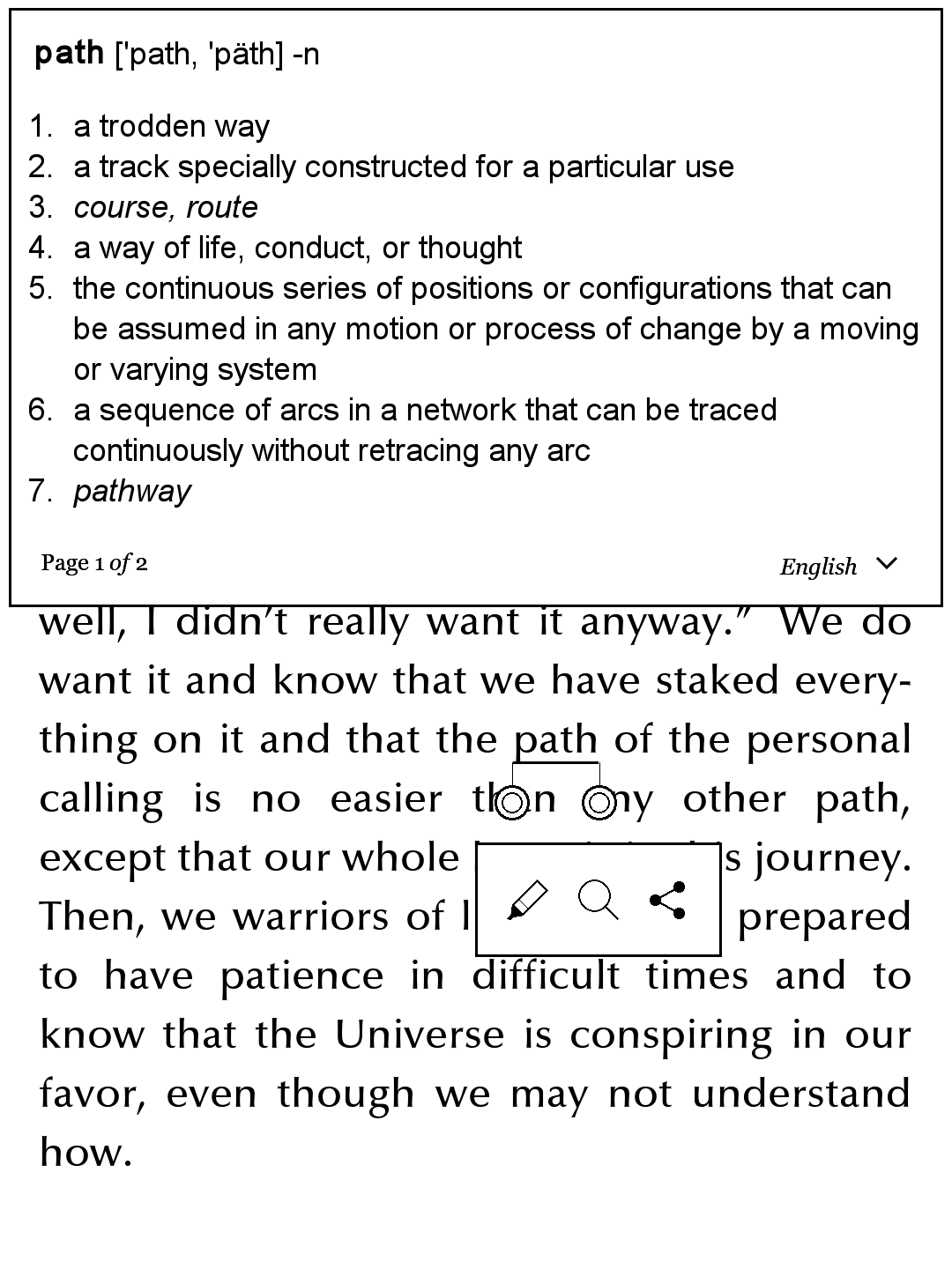

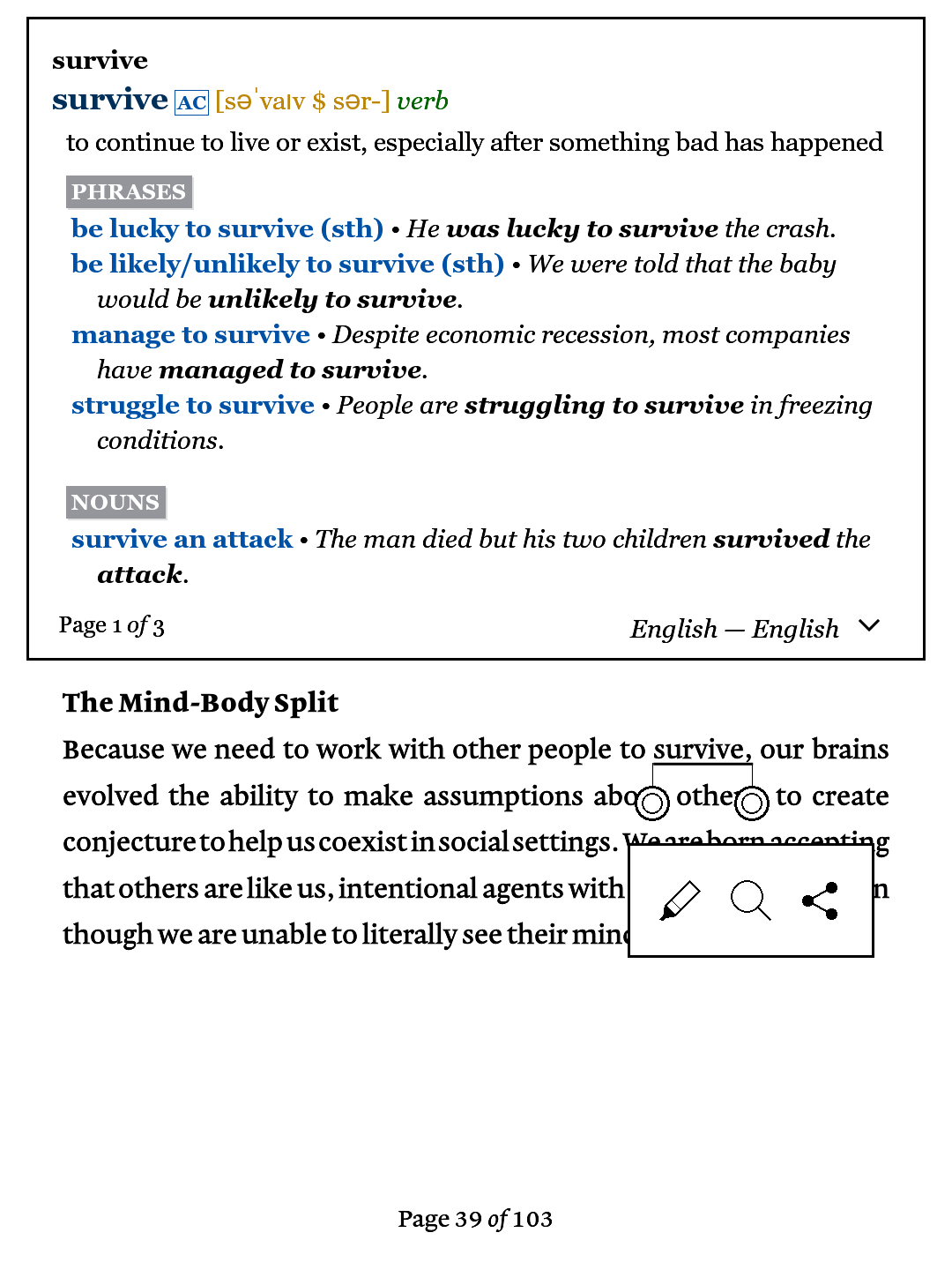

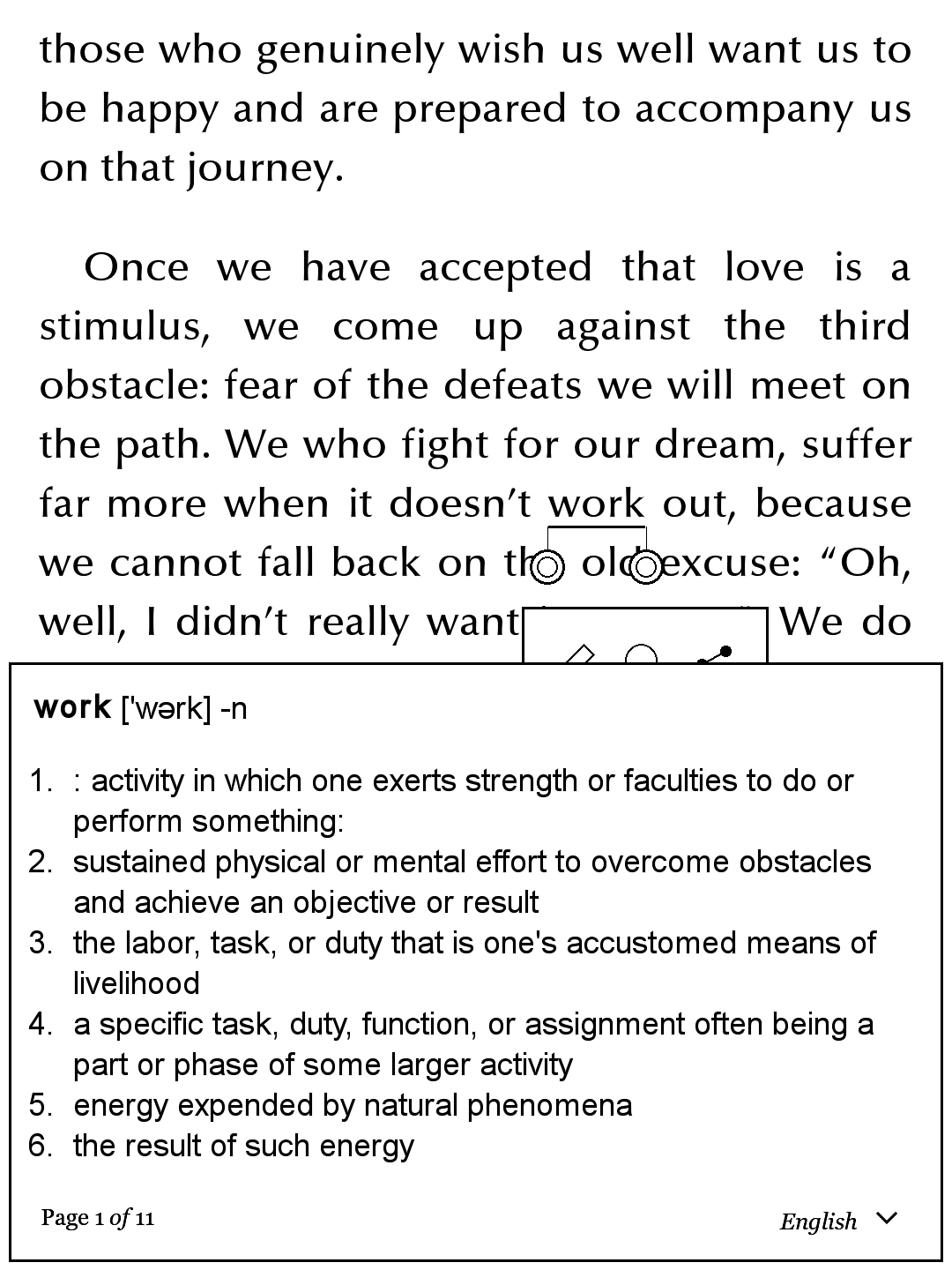

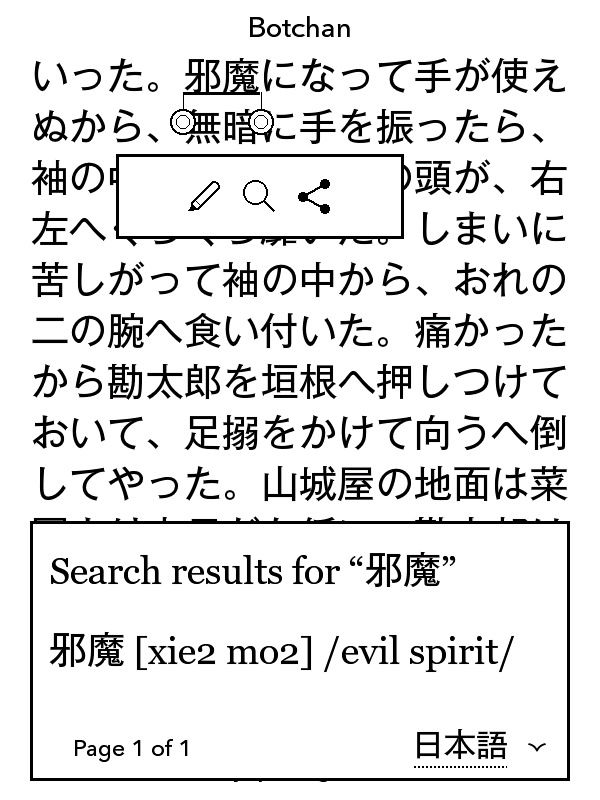

Hi, teshering, I find some parameters can control the frame size. They can in nickel and libnickel.so.1.0.0 in the attachments. Generally, parameters in nickel can control the frame size and in libnickel.so.1.0.0 can control contents size of dictionary. I modify them use hex editor and it isn't convenient for modification, but I don't know how to make patch like you and GeoffR. So maybe you can add them in you patch if you are interested.
A small issue is sometime the frame will cover the small box contains note, search and share.

Old 01-05-2015, 02:57 PM   #24
tshering
Posts: 3,489
Karma: 2914715
Join Date: Jun 2012
Device: kobo touch
Thank you! Please have a look at this post.

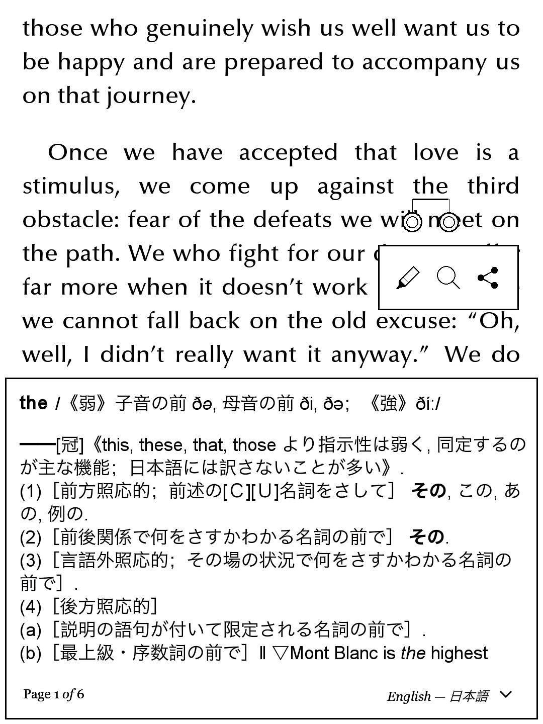

Hi scoky!
Thanks for the infos you provided.

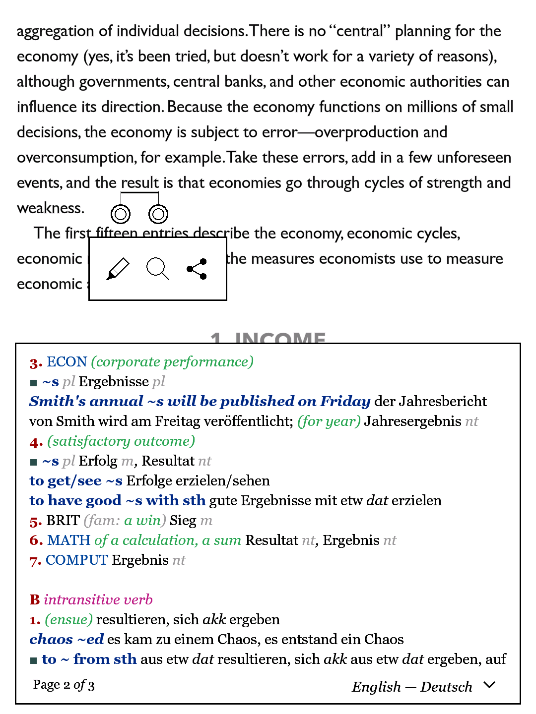

This gave me a starting point to try out some minor modifications. I played around a bit, using a Hex-Editor, and here are my results.
And I must say, now my dictionaries are even more accessible on my Kobo HD. This is a very useful little tweak for those of us who often read foreign texts IMHO. I'm loving it.
Note: There's no color on the Kobo display of course, unfortunately.

If I understood scoky correctly, he solved his problem by using ubuntu instead of windows.
