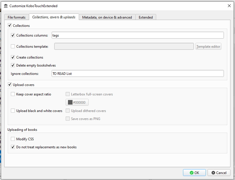

Originally Posted by Deobulakenyo View Post
This book covers are in color in Calibre. Does Calibre convert them to grayscale?
In the KoboTouchExtended driver under the Collections, covers & uploads tab, you have Upload covers and Upload black and white covers both checked.
That does the converting to grayscale and dithering and uploads the cover thumbnails.
It does whatever you have configured the calibre driver (KOBOTOUCH or KOBOTOUCHEXTENDED) to do. Have a look at the 'Collections, covers & uploads' tab.
There's a similar option in the 'Kobo Utilities' calibre plugin for the option 'Upload covers for selected books'.
That is the thing, both my kobo touch and kobotouch extended settings are set like this, so it should take color screenshot but still B&W screenshots are produced.

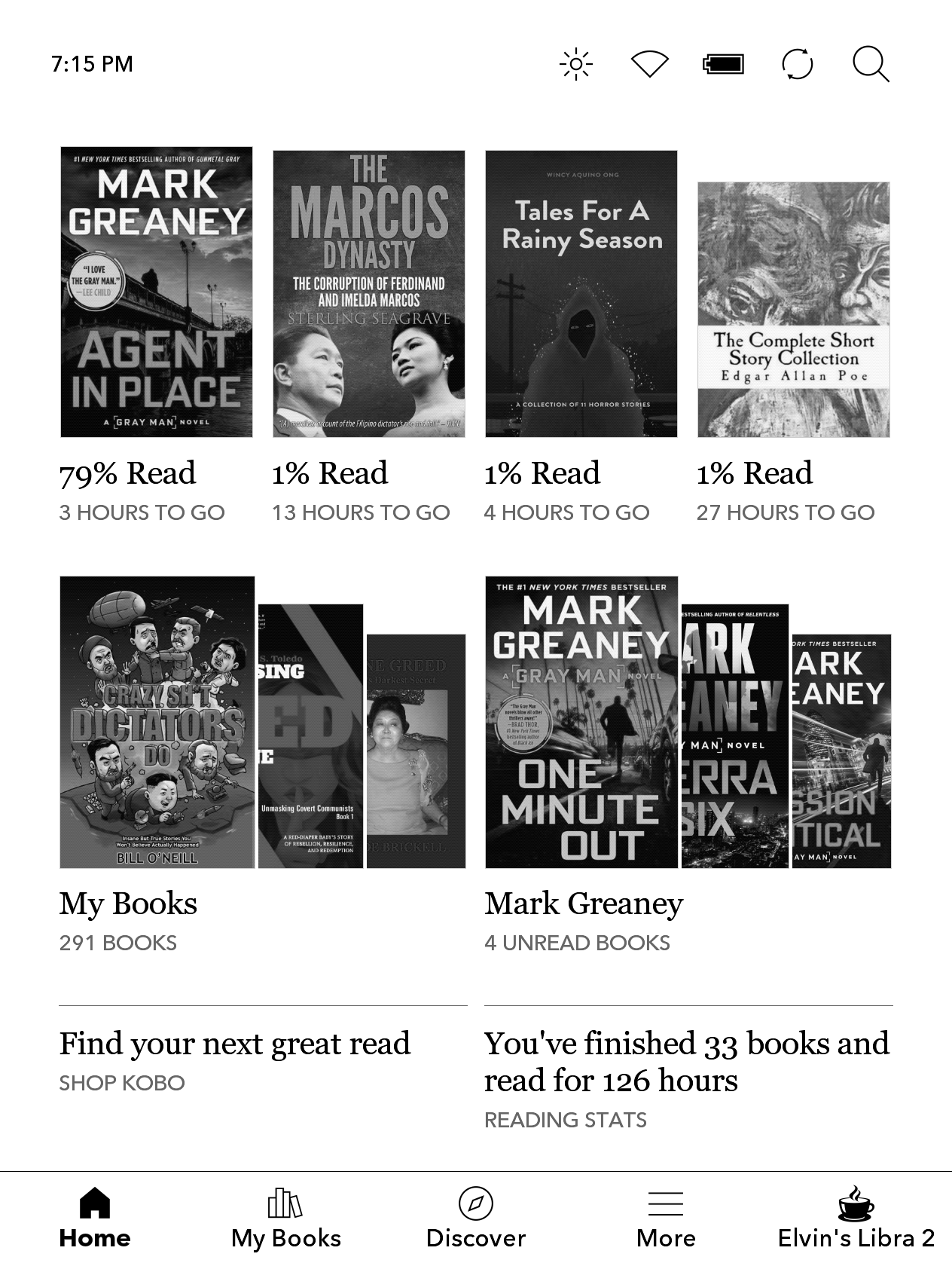

What happens if you take a screenshot of the cover that's in the eBook? That should not have been converted to grayscale and should still be in color.
They are in color.
But Homescreen covers are in grayscale
They are in color.
I suggest you ask in the KoboTouchExtended thread if it's maybe a bug and it's converting to grayscale anyway. But before you do that, I suggest plugging in your Kobo and having a look at the thumbnails and see if they are color or grayscale.
Thumbnails are all in color
Deobulakenyo is offline   Reply With Quote
Old 08-30-2022, 07:26 PM   #30
Posts: 85,236
Karma: 154365101
Maybe it's a change in the firmware that the home screen screen caps are not in color.
