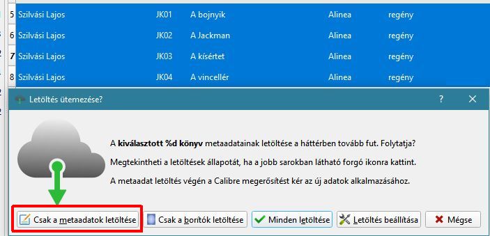

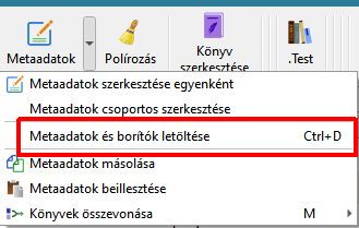

On the other hand, the Calibre program supports group metadata download. All books must be selected, mouse right-clicking, Ctrl + D, then download metadata.
ID:	180055   Click image for larger version

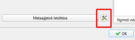

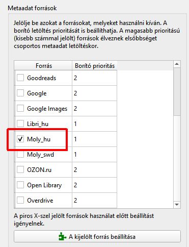

And something else that is important. The first step is to make the selected source only the Moly_hu plugin in the Calibre.
ID:	180060   Click image for larger version

Old 06-30-2020, 02:28 PM   #30
SzZs25
SzZs25 began at the beginning.
Join Date: Jun 2020
Device: PocketBook 626
Thank you
Thank you so much!!!
Thought that button does something else, like saves the data to a file in my computer.
Even if I have to review them after, it's much faster than manually downloading one by one...
