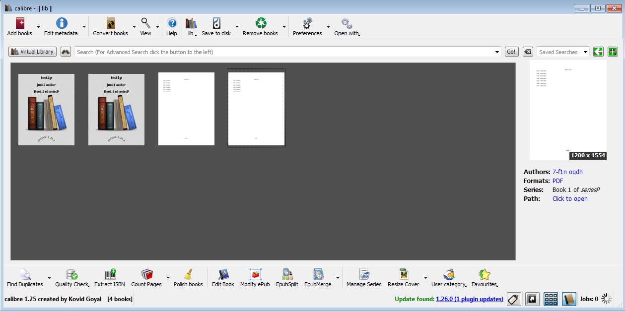

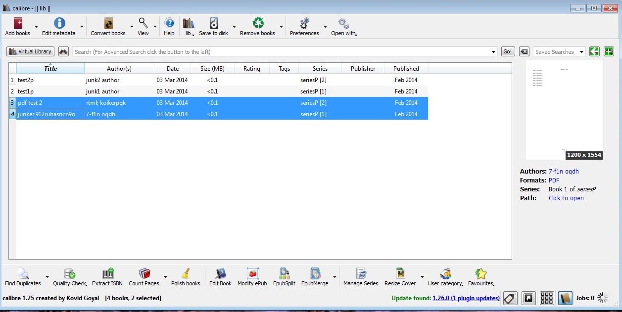

As I stated multiple times that (use internal metadata over OPF) is happening using "Add Multiple" but does NOT happen using "Add Single."
The uploaded screen shots and zip file show this...
Using the two book files sets included in the zip file. I added them twice; with "Single book per directory" option and with "Multiple books per directory" option.
In both screen shots (details and covers) the first 2 book entries are added using the "Single book per directory" option. The Metadata and Cover displayed are taken from the external OPF/JPG files.
In both screen shots (details and covers) the last 2 book entries (highlight selected) are added using the "Multiple books per directory" option. The Metadata and Cover displayed are taken from the internal PDF contents.
As you can clearly see the metadata and covers are different between the two methods of adding the EXACT same books.
