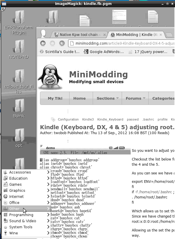

Ah sweet. Looks tidy via VNC on the 3
also looks good direct.
