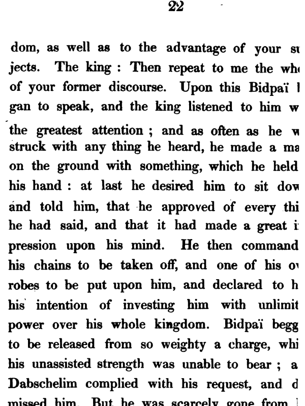

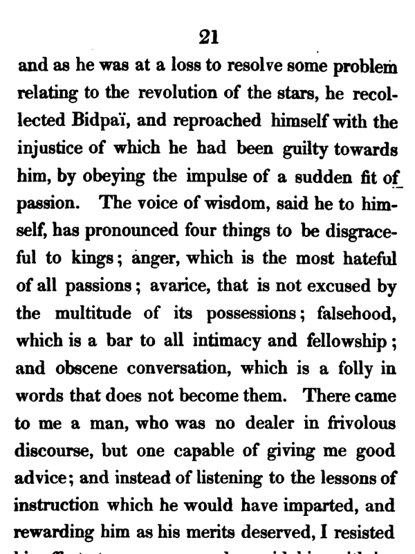

Originally Posted by Kai771 View Post
I just compiled the latest kpdfviewer build and uploaded it if you're interested to try it out. Improvements that chrox made to reflow mode are astonishing imno.

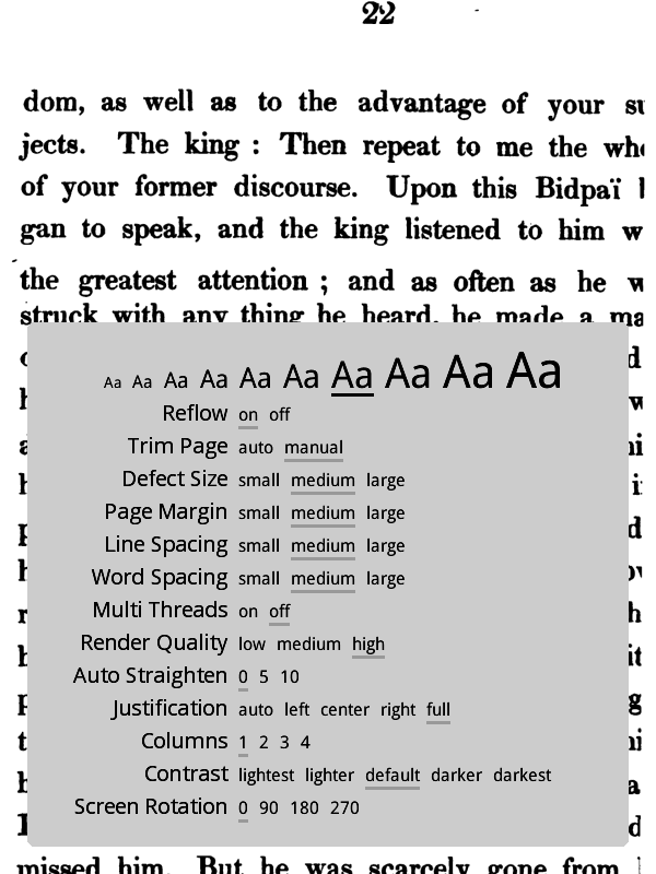

I'm also impressed by the improvements in speed, unfortunately, kpdfviewer still has some quirks that make reading in Reflow mode a bit difficult.
For example, when I tested this pdf from archive.org with it, I noticed that large chunks of text were often randomly carried over from one page to the next (p21_A.jpg & p21_B.jpg), which makes continuous reading rather difficult. Occasionally the Reflow feature also produced lines with just one word in it (p22_A.jpg).
(All screen captures where taken in sequence on my K3, and you can see the settings that I used in the last screen capture.)

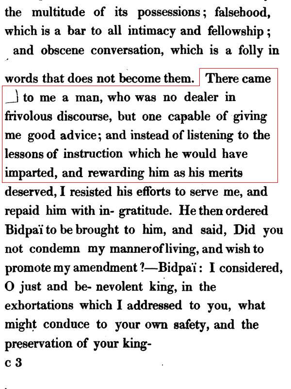

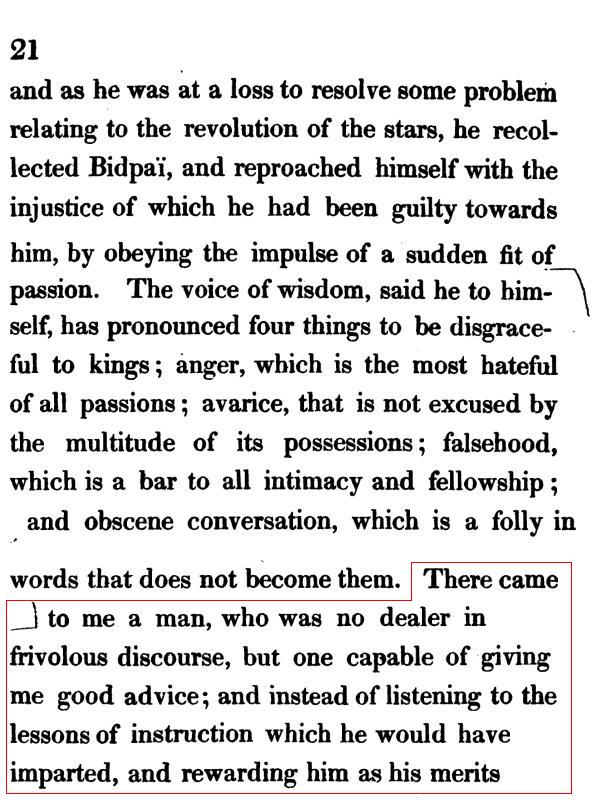

You can eliminate these problems by installing the latest release from my nightly build channel at https://github.com/chrox/kindlepdfviewer/downloads/ . Major improvements are listed below:
  1. more smooth page turning
  2. multi-threaded precaching
  3. fixed a bug of occasional words missing
Attached are screenshots of p21-p22 from the doc you provided. And the reflowing parameters I use are shown in the last pic. Manual trimming box is set to get rid of the defects at the margin of p22 which causes wrong indentation in reflowed view.
Thanks for your reply. The text reflow issues that I found indeed no longer occurred with the kindlepdfviewer-v2012.10-196-gd350c60.zip build and the indentation issue also went away after manual trimming.
(I'd never thought that manual trimming would fix this.)
