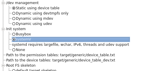

Old 09-02-2012, 12:16 PM   #18
knc1
Going Viral
knc1's Avatar
Posts: 17,212
Karma: 18210809
Location: Central Texas
Device: No K1, PW2, KV, KOA
I didn't read that entire mess, where "diff" magically changes a single line difference into 8 lines of output, but ...
You do need one of the init systems.
Does the K3 (and this busybox) use the standard SYSV init system?
Not using mdev and systemd would then be reasonable (grep for SYSV).

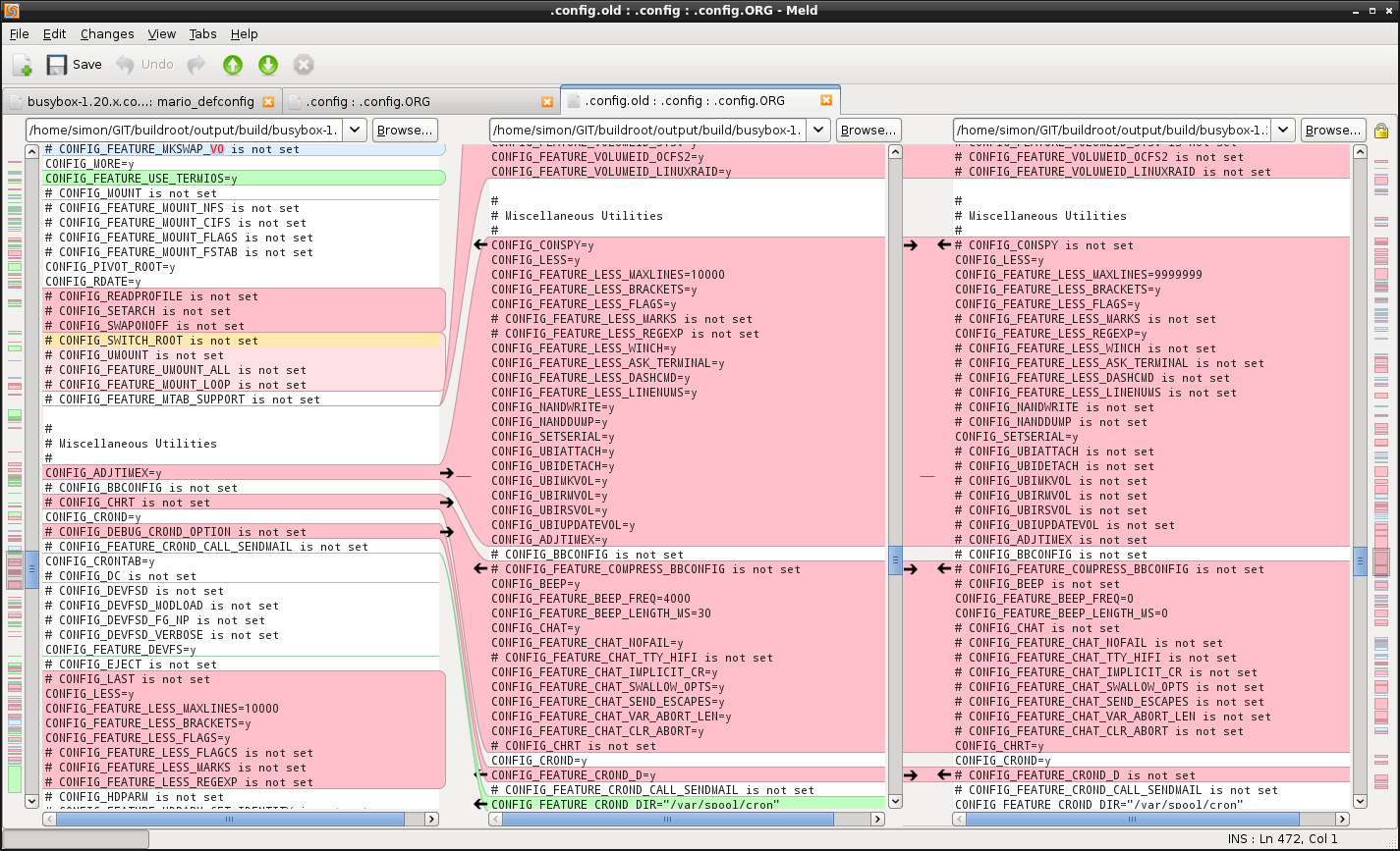

Old 09-02-2012, 12:19 PM   #19
twobob
( ͡° ͜ʖ ͡°){ʇlnɐɟ ƃǝs}Tır
twobob's Avatar
Posts: 6,586
Karma: 6299993
Join Date: Jun 2012
Figuring out what is old, new, borrowed, blue.
I recommend MELD myself...
In picture Left Old Right New Middle Borrowed.... err blue?
well I would be doing this by hand.
Name:	.config.old : .config : .config.ORG - Meld_039.png

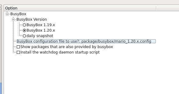

Old 09-02-2012, 12:55 PM   #20
twobob
twobob's Avatar
Posts: 6,586
Karma: 6299993
Join Date: Jun 2012
AFAICT there is no SYSV, systemd or Mdev support in the original setup. at all.?
Also all the module commands are elided.
So it must be reasonably assumed this is being handled by something else.
perhaps...
*more thought on that one later I think*
EDIT: This will be handled outside busybox

# CONFIG_WATCHDOG is not set - That also surprised me.
Guess something else manages the watchdog process too.
Old 09-02-2012, 01:09 PM   #23
knc1
Going Viral
knc1's Avatar
Posts: 17,212
Karma: 18210809
Kernel code. Handled at the system level.

So yeah - it built.
I chose to use the script system for linking on FAT. see how that goes for us.
