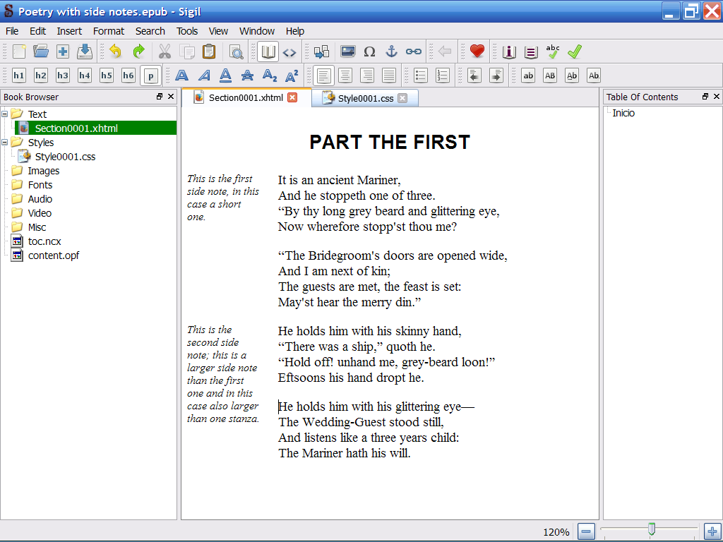

This is how it looks in Sigil:

You must enclose your side notes in a <div class="col1"> tag and your stanzas in a <div class="col2">. That's all. Below you can see the respective .epub and you'll be able to understand better what I want to say
