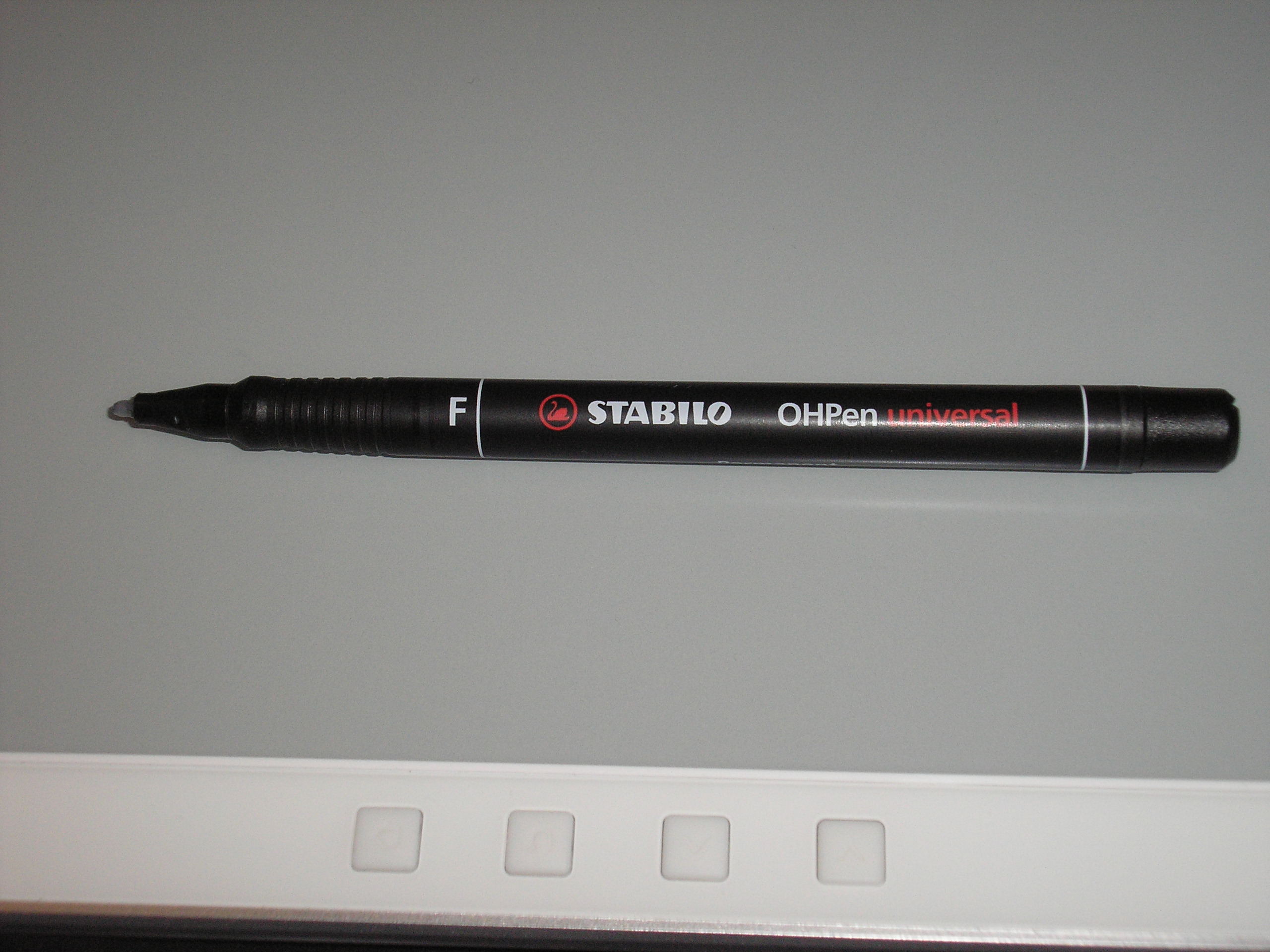

Old 02-14-2013, 11:24 AM   #21

Onyx Boox M92 Stylus
I tried to make a home made stylus using a STABILO OHPen universal but it doesn't work.
What is the problem that you are facing?

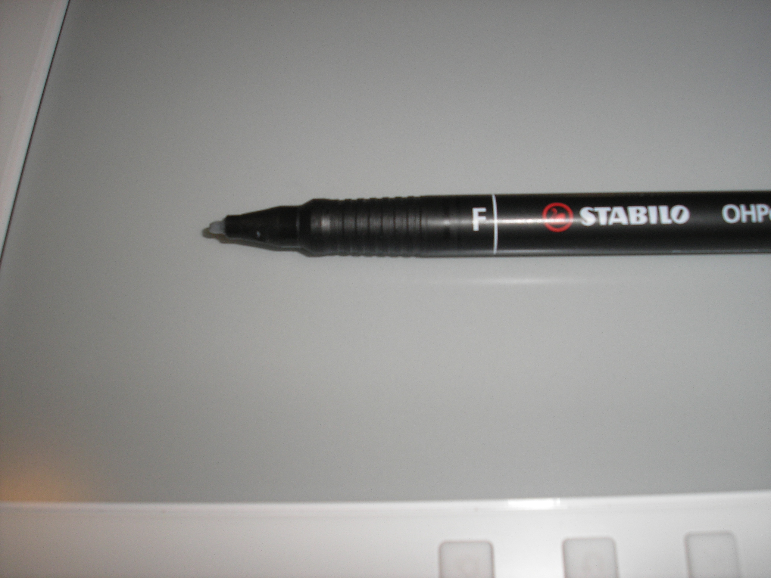

I attach photosClick image for larger version

I think the pen is not suitably shaped

In my opinion you should cut some portion of the front as shown here https://www.mobileread.com/forums/sho...74&postcount=2
I did the same. I took 2 pens. With the first i got a rough estimate on how much i should cut so that i get sufficient friction.I cut the 2nd one very carefully bit by bit with blade. I cut till there were some inner protrusions/ridges left which held the stylus tightly.
BTW is your stylus stuck inside right now or you can get it out easily

Device: Onyx Boox M92; Onyx Boox i86ML; Kobo Aura H2O; Dasung Paperlike
Is your home made stylus working on Onyx M92 e-ink Pearl display?
It is working very well. But why does putting a cover on stylus will affect its working?
The onyx m92 stylus is pressure based stylus. It works when the nib goes back inside the body of stylus. Is your stylus nib stuck?
Feher,
The nib doesn't go back inside the body of stylus. What about yours?

Mine goes back (Note that it doesn't go back all the way.. only a fraction goes back but we can feel nib movement with our hand) and i think this is causing the problem for you. Probably something is obstructing it
I had experienced the same thing - It happened with me when i cut my first trial pen improperly which caused the stylus to stop working
Can you get the stylus out or is it stuck?
