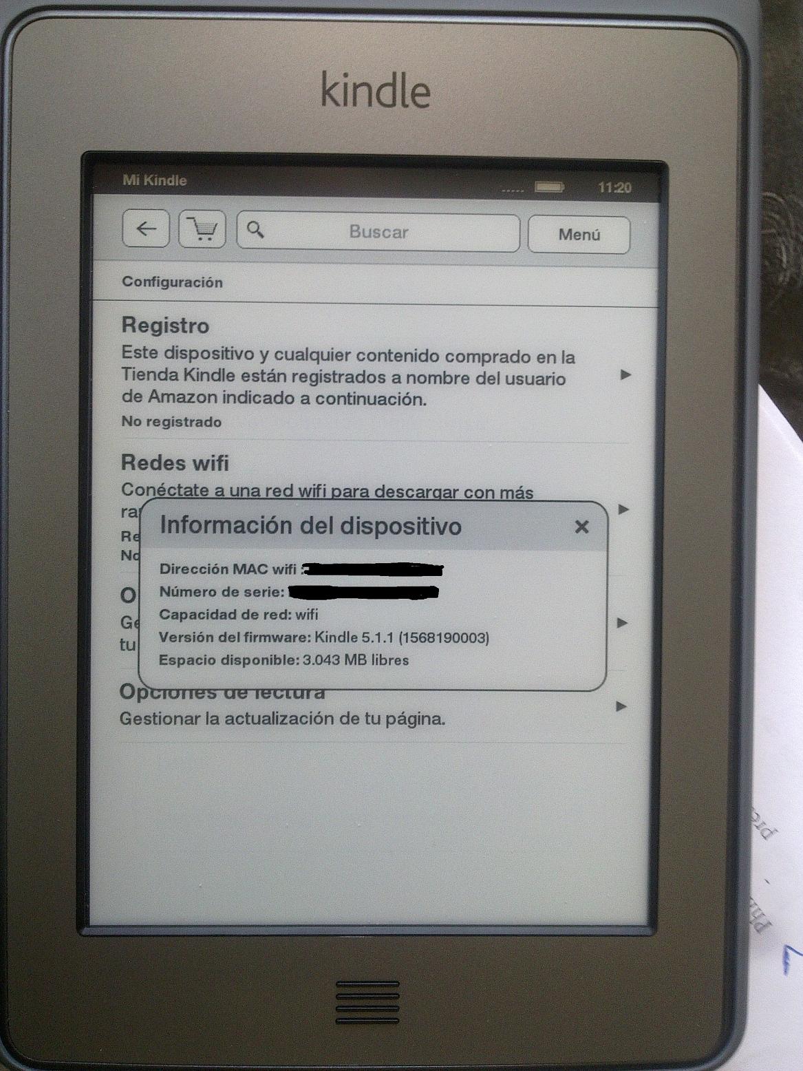

Look at the number of posts for those claiming to have seen the 5.1.1 update. Of the four I saw who claimed to have seen it, one has 13 posts, one 1 post, one 2 posts, and one 6 posts. It is clear that all are new comers to this forum and possibly new to Kindles. I still suspect this is just pure BS or they simply don't know what they actually saw. I still have not seen any credible evidence that 5.1.1 ever existed other than in someone's imagination.
TO DOUBTERS:

Yours is not the only posted photo showing 5.1.1. So far, all reported 5.1.1 kindles have been foreign (non-US) versions, and were shipped with 5.1.1 preinstalled.
There are reports of some kindles reverting from 5.1.1 back to 5.1.0 after an OTA update, and a reboot.
