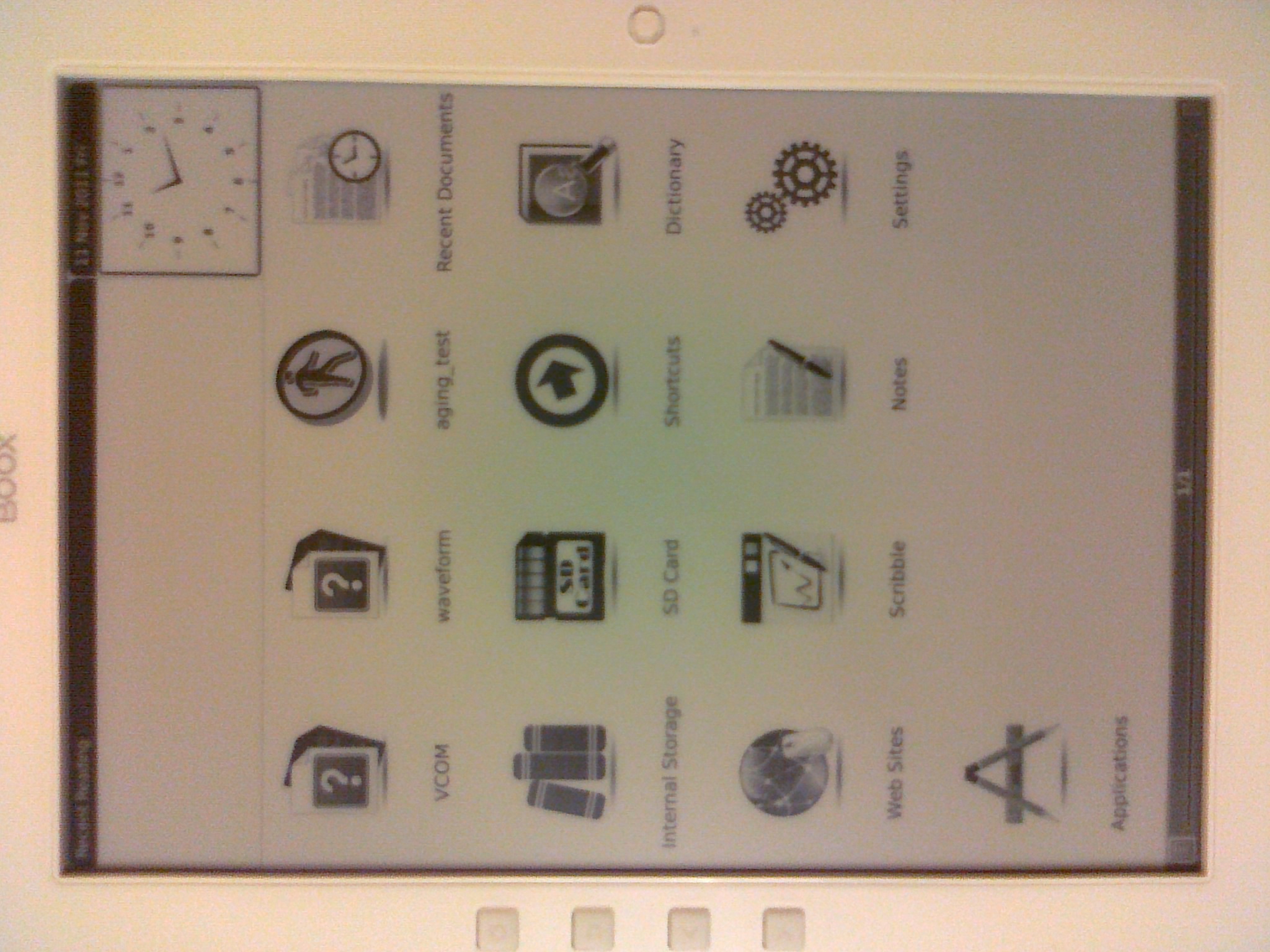

Guys... IT WORKED!
This firmware 'update-20120309' has resurrected my M92!
after checking all the major functions for about 5 min, everything seems good.
all the data files (except scribble; i didn't have notes) in "Internal Storage" stayed intact.
Thanks Markereader, thanks man!

I think so; it definitely helped.
Hard to compare (vs. 1.7) as i had only a week of experience with v1.6
in "About" it reads: firmware version 1.7 20120309;
new "aging_test" icon on home screen;
"Zoom by two points" is new to me.
no other fundamental changes in appearance, navigation, or the way the reader connects to wi-fi.
If you have any questions, let me know.
