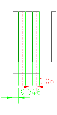

Old 10-19-2012, 02:23 PM   #29
knc1
Going Viral
knc1's Avatar
Posts: 17,212
Karma: 18210809
Location: Central Texas
Device: No K1, PW2, KV, KOA
Contact outline
With the connector cavity outlined, then the contacts are outlined.
We find that our tab needs to interface with 0.046 wide contacts on 0.060 centers.
These are "grasshopper leg" pressure contacts.
So next find the depth of the contact points.
