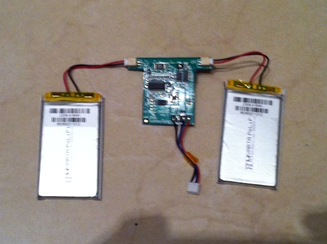

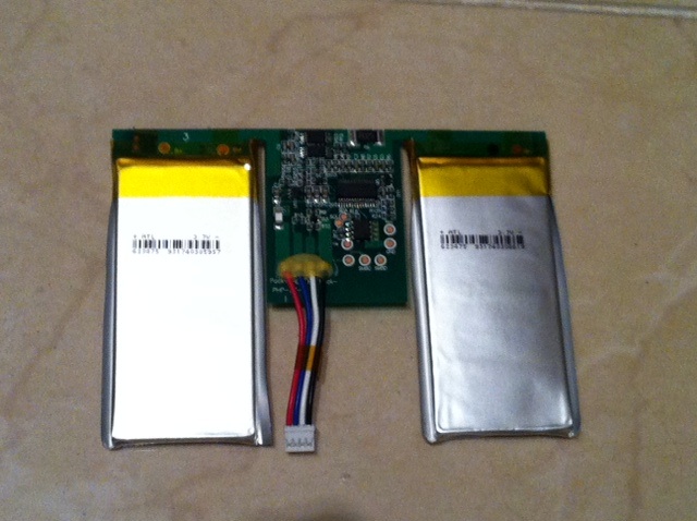

iLiad Batteries
This is the battery pack Version 1
Was used in the iLiad 1st Edition and in the earlier 2nd Edition.
This is the battery pack Version 2
Was used in the Book Editions and in the most recent 2nd Edition.
The two battery pack (not the battery elements!) are equivalent and can be exchanged.

Hi Luke,
then I have a V1...
But the V2 looks much more interesting
FG
