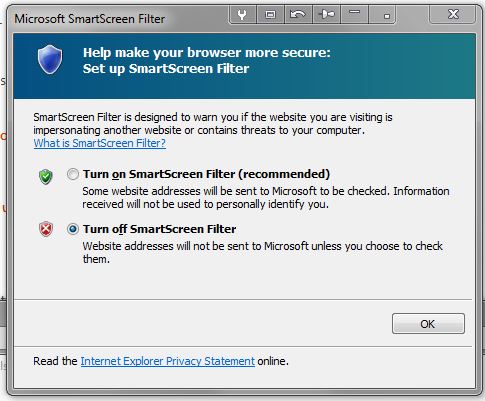

Anyway, after Mr. Goyal said that it looked like a windows security policy issue, I wanted to test other things, such as turning off Windows Smart Screen. So I unchecked the "run as administrator" box in the file's properties. Then, before I tried turning off Windows Smart Screen, I tried opening calibre to make sure that I was still getting the same error message. But the program opened without issue...

Smart Screen is a security 'feature' see SmartScreen Filter: frequently asked questions - which is what Kovid suggested.
Maybe it was causing the block - it obviously reaches beyond the scope of IE.
When it starts Calibre, calls home to look for new versions of itself and here to look for new versions of installed PI's
