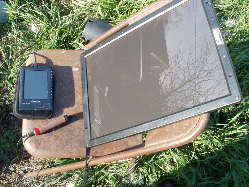

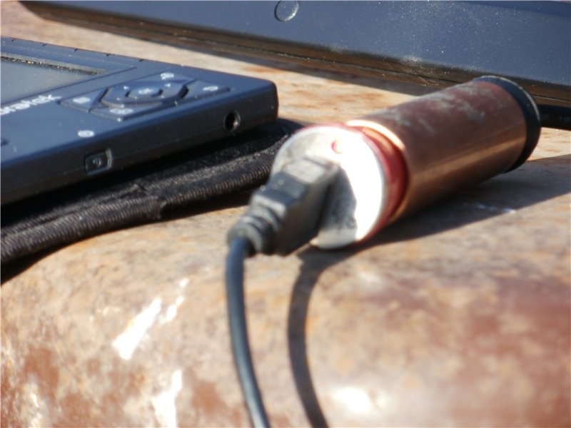

I am charging an Aluratek Libre Pro with a 10Watt panel the same size as my 23" desktop
LCD widescreen monitor.
http://www.northerntool.com/shop/too...6972_200496972
The adapter can handle the output of two of these panels, I think. I have
two of these panels now, and a "Y" cable auto power plug on order.
Here are some pic:
ID:	81604   Click image for larger version
ID:	81605   Click image for larger version

Yes, one panel does put the Libre into charging mode when placed in full sun. I have
not yet timed the recharging from a known state to a full charge, using the one panel.
Until I've done that, I don't have anything to compare with a two panel setup.
So at some point we will see.

Actually, 3 of them (125mA x 3 = 375mA) could supply the 12v 300mA that my MAHA
MH-C204GT runs on to quick charge (2.5 - 6 hrs) 4ea AA NiMH batteries. A fourth
might make up for your latitude issues, though.
The charger has an input spec of DC 12V 300mA and an output spec of DC 2.4V 500mA x
2 Ch. So a any "12 volt" source that can supply the 12V 300mA will be sufficient to power
the two channels of 400mA 2.4V charging.
