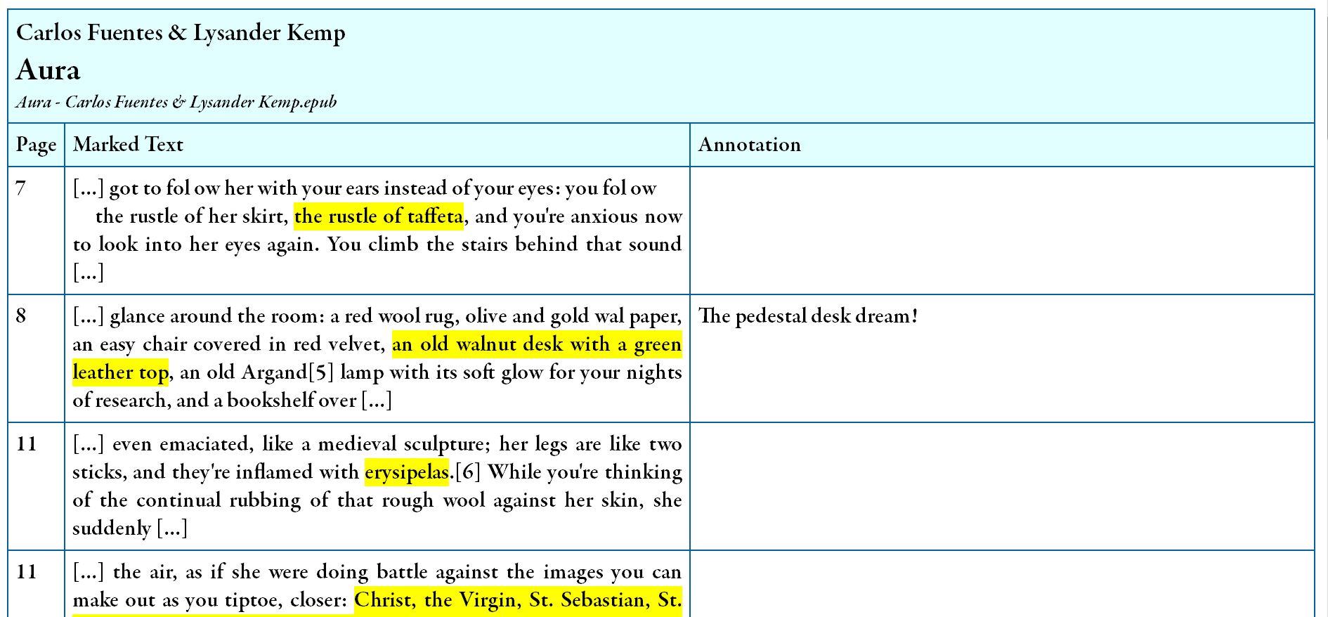

Annotations and Highlighs
I have a question for marp68
what do the annotations and highlights look like on calibre? Could you post a picture here, so that I can see how easy they are to read? Can you get the annotations and highlights to display in separate columns in Calibre, so that it's easy to distinguish between my annotations and the highlights from the text?
There used to be a tool for Sony Readers to export highlights and annotations as an html-file. I've attached a picture to show you how highlights and annotations are separate.
Unfortunately, Sony Readers are not backlit, and the annotations were limited to just 200 characters, plus they are no longer being manufactured.
I make so many annotations, and how easily they can be read, and searched, is important.

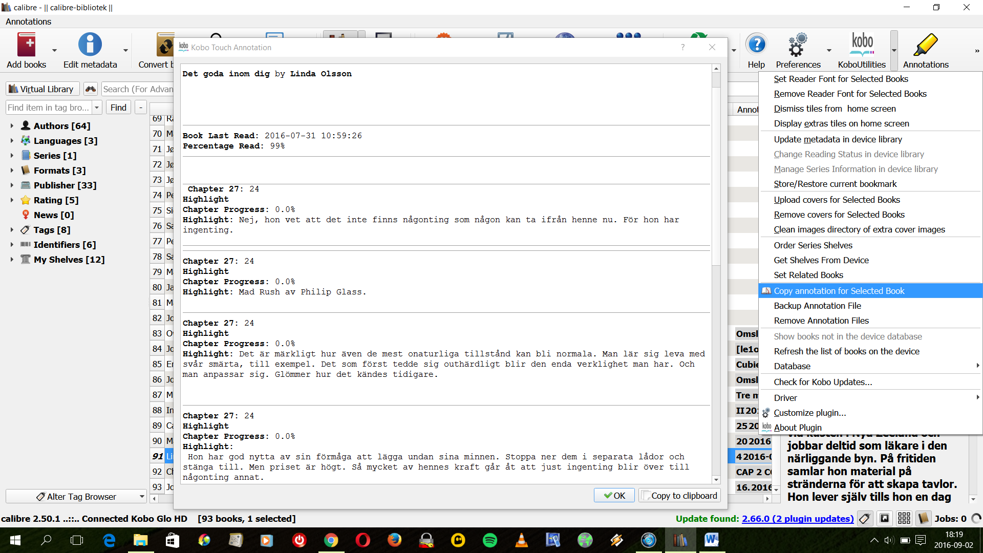

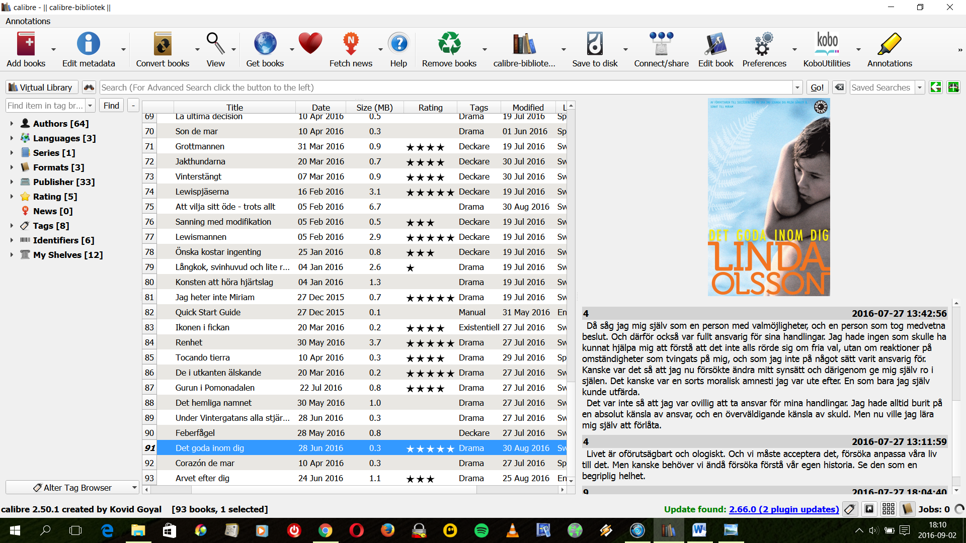

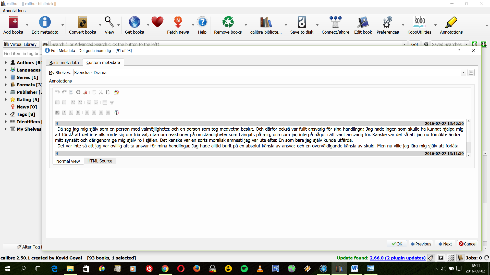

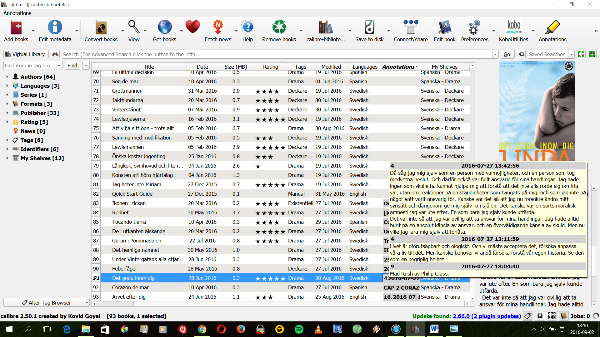

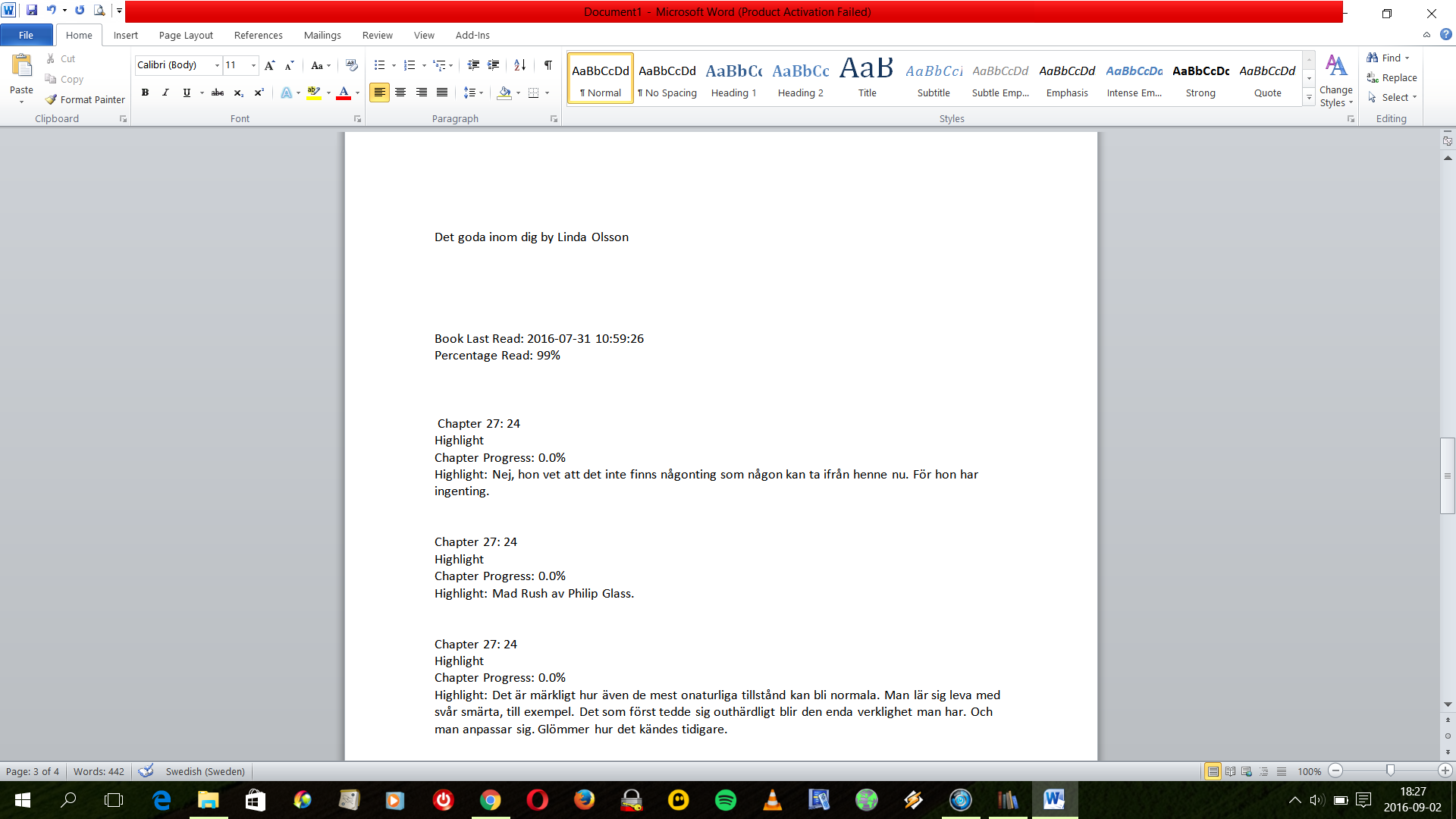

I just made some printscreens. As shown some does not looks as organized as yours. I haven't any saved annotations but I think they enda up in the same column. I think I tried that before. Hey, I tried a lot of things with my new ereader..., but forget quickly. There is the plug in called Annotation that one can put on on the menu bar. Then there is a program called ToxAnnotationExporter. Neither can be imported back to a new device along with the book.
But trying the Kobo Utilities plug in option for annotations I think turns out quite well if you would like to read it immediately, Copy annotation for selected book. The option Back up annotations seems to create a text file with a lot of code in it as well. Not easy to read. Turned out better when first choosing Copy annotations for selected book, then choose Copy to clipboard and then paste it in, for example, Word, and then save that. Clean and easy to read immediately or/and save for later use. See last image.
Hope that helps... Good luck
