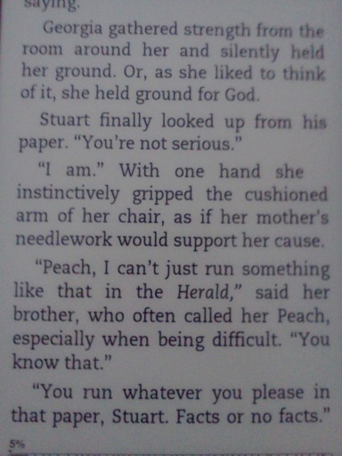

Originally Posted by Ron. View Post
The Kindle does not recognize 1.3em indent it rounds it up to 1.5em, the kindle will display 1em, 1.5em, 2em, 2.5em etc indents. anything in between it rounds up.
Mine shows 1.3em or 3% or whatever the third letter is. The indent in all my books starts on the third letter space. Which I assume is... 1.3 or 3%. Whatever it is I like it. 1.5 is too far of an indent.
1.5 is default it seems on all HQs I buy so I always change the indent because I don't like how it looks. The changes do show on my Kindle. I do make my mobi books using the Hanlin v5 profile not the Kindle profile in Calibre.

All my Indents start on the third letter space in a paragraph. I'm not sure what it's called but I do know to get it I use 1.3em in the Extra CSS box It looks the same in both epub and my mobi file.

Mobi don't have no CSS. Whatever you put in that box gets translated to html attributes.
I know that it gets translated but I use the CSS box because it works for both Mobi and Epub by default that way.
Okay I've attached a pic from my Kindle. It's a tad dark but you can see where my Indents are. I don't know what the setting really is.
I just know using 1.3em in CSS box gets it for me and I like it that way. lol
It's a Inspirational novel to make sure there are no woo woo scenes showing from other books on my K3

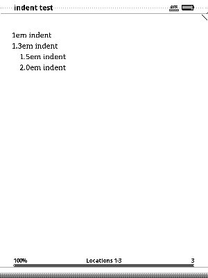

try this
<?xml version='1.0' encoding='utf-8'?>
<html xmlns="http://www.w3.org/1999/xhtml">
  <head>
    <title>indent test</title>
    <meta content="http://www.w3.org/1999/xhtml; charset=utf-8" http-equiv="Content-Type"/>
  </head>
  <body>
<p style="text-indent:1em;margin-top: 0px;margin-bottom: 0px">1em indent</p>
<p style="text-indent:1.3em;margin-top: 0px;margin-bottom: 0px">1.3em indent</p>
<p style="text-indent:1.5em;margin-top: 0px;margin-bottom: 0px">1.5em indent</p>
<p style="text-indent:2em;margin-top: 0px;margin-bottom: 0px">2.0em indent</p>
</body>
</html>

Okay here's my experiament.
I used your code to make a html file them converted it to mobi and 1.em and 1.3em are the same. I then converted from html to epub and got the same results. The only difference in the mobi and epub was 1.5em every other size matched on both epub and mobi with 1em and 1.3em showing no difference from each other.
Very Interesting!
I then put the mobi in Kindle Preview and 1em & 1.3em are the same.
So are 1.5em and 2em they match each other.
try this
  <head>
  </head>
  <body>
</body>
</html>
That html produces the following mobi source when run through kindlegen and unpacked using mobiunpack.py:
<html>
  <head>
    <meta http-equiv="content-type" content="text/html; charset=utf-8" />
    <guide></guide>
  </head>
  <body>
    <p height="0" width="1em">1em indent</p>
    <div height="0"></div>
    <p height="0" width="1em">1.3em indent</p>
    <p height="0" width="2em">1.5em indent</p>
    <p height="0" width="2em">2.0em indent</p>
  </body>
</html>
Which looks like this:
Either a 1em or 2em indent.
