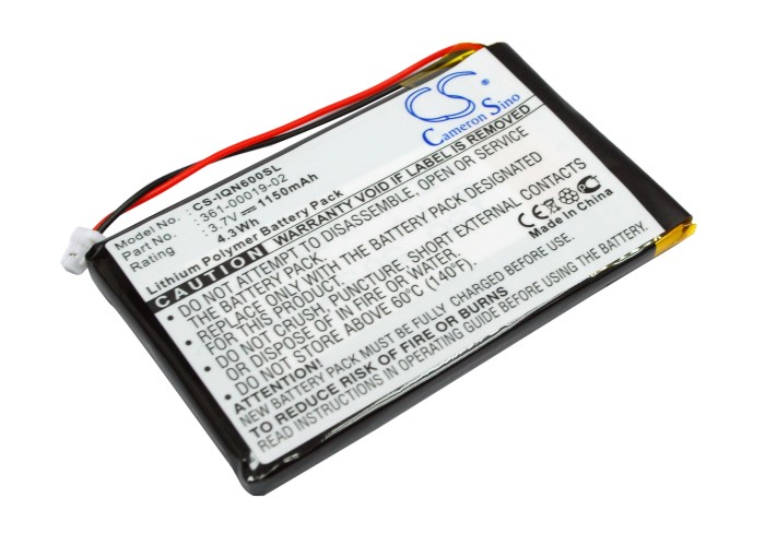

Cameron Sino Replacement - 13 hours and 30 minutes continuous use
Battery Replacement:
CameronSino Technology
ItemNo.: CS-IQN600SL
Volts: 3.7 V
Type: Li-Polymer
Capacity: 1500 mAh
Period of use test:
Charging Time – Overnight
Use Start Time - 12:40
Use End Time - 01:10
Total - 12 h. and 30 min.
No warning has been given before the switching off the device, which is what the Irex used to do with the original Varta. Secondly, the screen stayed on the last page although the device itself did not function from that point of time onwards. Obviously the battery still had powers to feed the device, which is why the screen did not go blank. So the Battery itself could have powered the device for some extra time, and it is not completely drained on the hanging event.
I am not sure that this can be adjusted by a hack in the setting of the device, but there is obvious mismatch between how the device behaved with the original Varta.
Although the screen was still showing the last page which was loaded before the hang-up, I could not reset it through the reset switch on the bottom. It needed a recharger to be plugged in before it can start again. I am not complaining though, I have got nearly 13 hours of continuous use and even with the annoying hang-up on the end, the device is much more useful than with a nearly dead Varta on board.
Thanks for the tips on replacing the battery Guys.

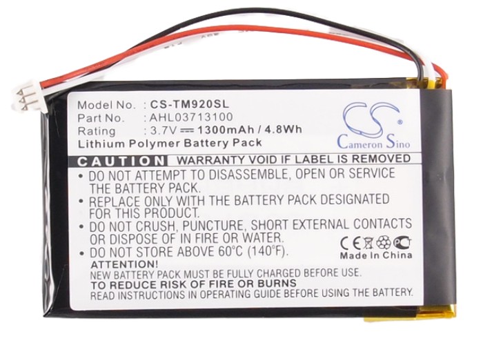

Hi Guys,
I hated the constant playing up of the Irex DR1000 recently.
Pretty much the behavior was the same as the experience of MrWarper, and the fact that I have to watch constantly for not over discharging the device battery. Thus, I have decided to change the battery to something closer or identical to the original one which was according to Varta is 1300 mAh.
http://www.farnell.com/datasheets/89136.pdf
The new replacement battery is yet another Cameronsino product :
ItemNo.: CS-TM920SL
Volts: 3.7 V
Type: Li-Polymer
Capacity: 1300 mAh
Dimension: 60 x 37 x 6 mm
The Battery is in fact more like 5 mm thick, or the same thickness as the previous two batteries used, and it fits perfectly without any alterations of the casing.
I don't like, and I am pretty fed up with the constant playing up of the device with the 1500 mAh of the previous CS battery, although it was nice from time to time to have 12&1/2 hours of use without charging.
However, the device is constantly being over discharged and its behavior is as if the battery is constantly full, where in fact was less than a half discharged.
I will try to keep you updated on the behavior of the Irex DR1000 with the new CS-TM920SL.
BTW, CS are no longer making the 1500 mAh model and are stating that the CS-IQN600SL model is now 1150 mAh instead of the extended 1500 mAh, which I had in the Irex DR1000.

Now I am convinced the DR1000 is actually “she”, and she is so fussy that it only takes the right size to make her happy…
Jesus, if I only knew that earlier…wouldn’t have wasted so much time.
Guys just don’t bother with anything else but 1300 mAh batteries, if you of course want trouble free use. “She” is like brand new…and since “she” is happy with the replacement battery and everything seems to be working as before, I am too.

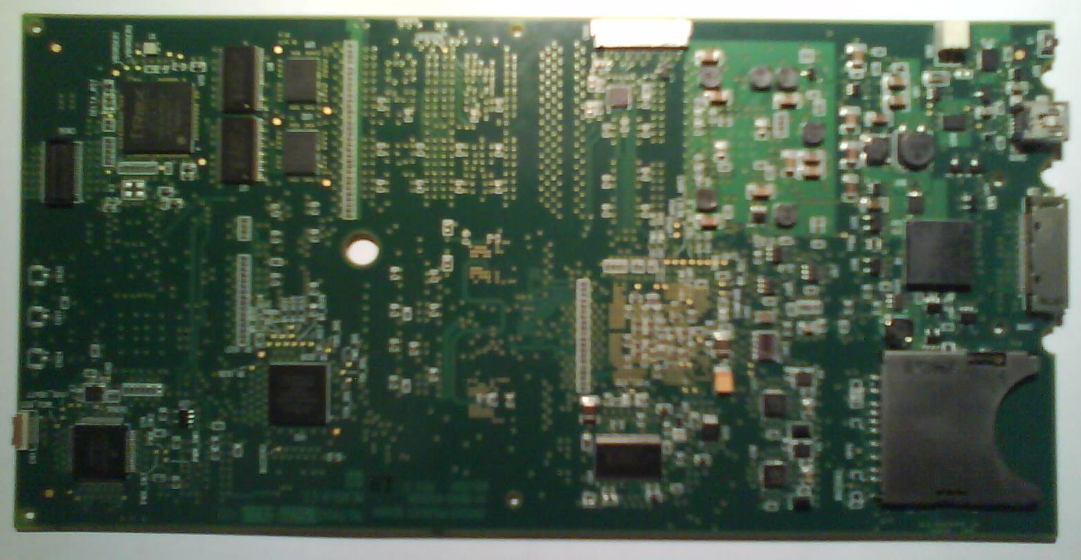

2x Capacity battery failure(s)
After a veeeery looong test period, I have now an enormous log of the charge / discharge cycles of my large (2400mAh) battery. I'll post it here tomorrow as an edit, after one last discharge period.
My conclusions:
-It is currently not possible to make the DR1000 work with battery capacities larger than the original (1300 mAh).
-Its charge gauge adapts very well to batteries of that or lesser capacity, which makes sense, because batteries are expected to diminish their capacity over time and be replaced at some point.
Working with a 2400 mAh battery I've observed three different behaviours:
-The DR1000 will discharge for ~12.5 hours and will give its low battery warning, and lit the red led. It will sit like that for another ~12.5 hours before actually running out of power.
-The device will report 100% battery for ~12 hours, and then will report a 'normal' discharge over the next 12 hours.
-It will discharge over the course of 12 hours as if the battery were the original one, then will do another identical cycle if restarted.
Since I haven't find a method to reliably make it work like cases 2 and 3, the idea of sticking a larger capacity battery in the reader is not very practical... yet
Originally Posted by Mackx View Post
Looking in the source code of the DR, there seems to be a gasgauge IC on the DR1000 (kdbupgrade.c). The gasgauge ic probably contains its own CPU ...
Unfortunately the pictures on http://dr1000s.blogspot.nl/ do not show anymore, so I could not find any details w.r.t. the used gasgauge ic.
But dear friend, you have me here. What do you think the numbers and xs below my name, where it says 'device', mean? Here you have a couple of pictures of a DR1000 board, and I'm ready to do all the experiments you want. The only problem is I can't take very good pictures with my mobile phone, so you'll have to guide me 'a little'.
Assuming the IC you mention is the little black square below and a bit to the left of the battery plug socket (ivory square next to the right edge) in the second picture, it has 14pins (7 going up, 7 down), is labelled as U25 or U35 on the board, and it also has the number 6 to one side. On top of it there's three lines -- 1: 4085; 2: N7347; 3: LT90. If you need whatever else, just send me a PM...

I googled a little bit and U59 seems to be a bq27500 from TI.
The bq27500/1 accurately predicts the battery capacity and other operational characteristics of a single
Li-based rechargeable cell. It can be interrogated by a system processor to provide cell information, such
as state-of-charge (SOC), time-to-empty (TTE) and time-to-full (TTF).
I had a quick look at the datasheet at it seems to be a very complex device that can (must?) be tuned to a specific battery by programming a lot of registers via I2C.
