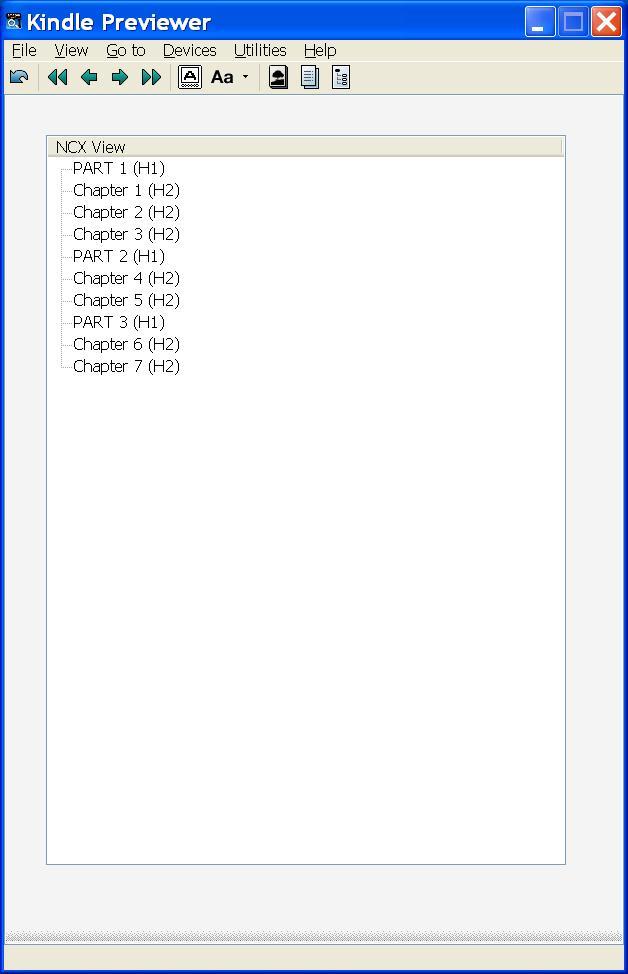

What is the NCX view? I just used Goto TOC in Kindle-for-PC plus I opened the mobi in the Calibre Viewer. Both of these seemed to be OK. Is NCX view something else? I don't have a Kindle so I'm not familiar with the finer details.
Yes, the NCX file is something else... and is an Amazon requirement.
When you display a Kindle file with the Kindle Previewer, look at the two little icons at the right end of the Menu Strip.
Click the very last icon to display the NCX view...
Click the next to the last to display the TOC that was built by Calibre.

The NCX view is "required by" Amazon for Kindle eBooks, but they are not currently enforcing that requirement.
It can be displayed by clicking the last icon at the menu strip at the top of the Kindle Previewer. (see screen shot).

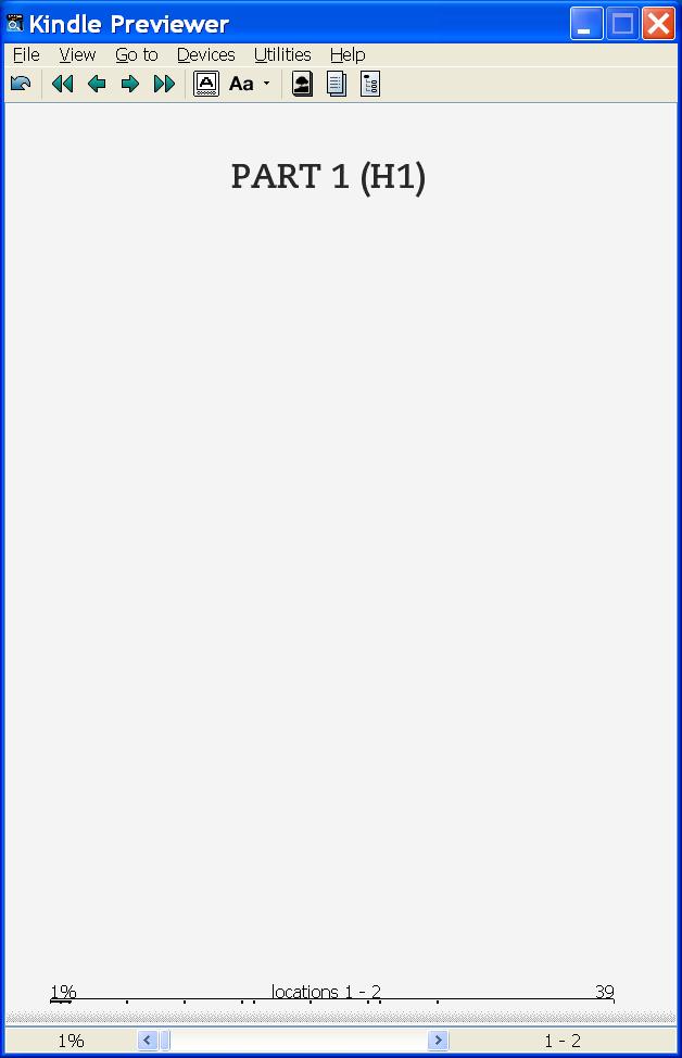

Calibre, at default, creates a page break before H2.
When there is no body text immediately after the title for H1, that leaves the entire rest of the page blank.
(see screen shot)
Then H2 starts on the next page.
If I try to remove that page break before H2, I create problems with the proper display of H1 and H2 in the NCX file.

Perhaps you could make life easy for yourself and learn to love the H1s being on a page of their own
Is this really so bad? Many novels I read which are structured:
Part 1
     Chapter 1
     Chapter 2
     etc...
Part 2
     Chapter 1
     Chapter 2
     etc...
have their Part headings on their own page.
Part 1
     Chapter 1
     Chapter 2
     etc...
Part 2
     Chapter 1
     Chapter 2
     etc...
You are right... that doesn't look bad at all!
