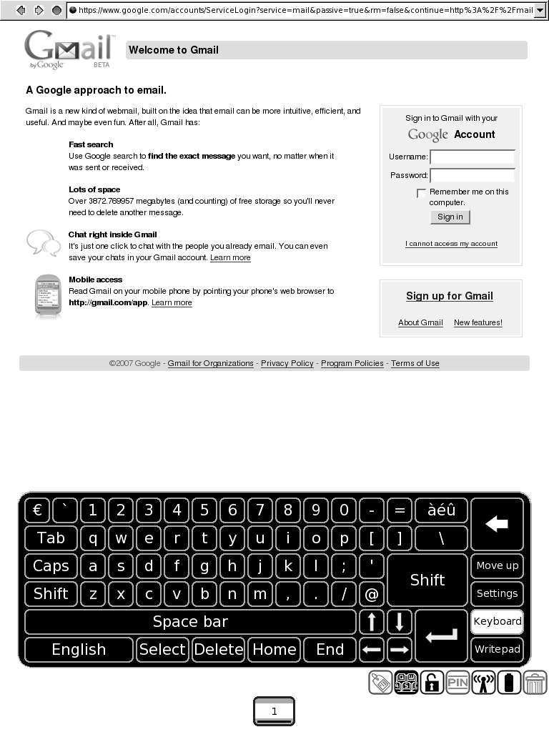

After a few hours of hacking, I've finally got SSL working!!!
I'll have to do some more testing to make sure it isn't a fluke(), but if all goes well, expect a release in the next few days.
Edit: I'm going to go ahead and post for files for those who have SSH access. Delete the /usr/lib/mozilla-minimo directory (be sure to make a backup, this isn't tested very well), and overwrite with the attached file. You'll need the hacked libX11.so.6 in /usr/local/lib. Launch with "/usr/lib/mozilla-minimo/mozilla-run.sh minimo".
