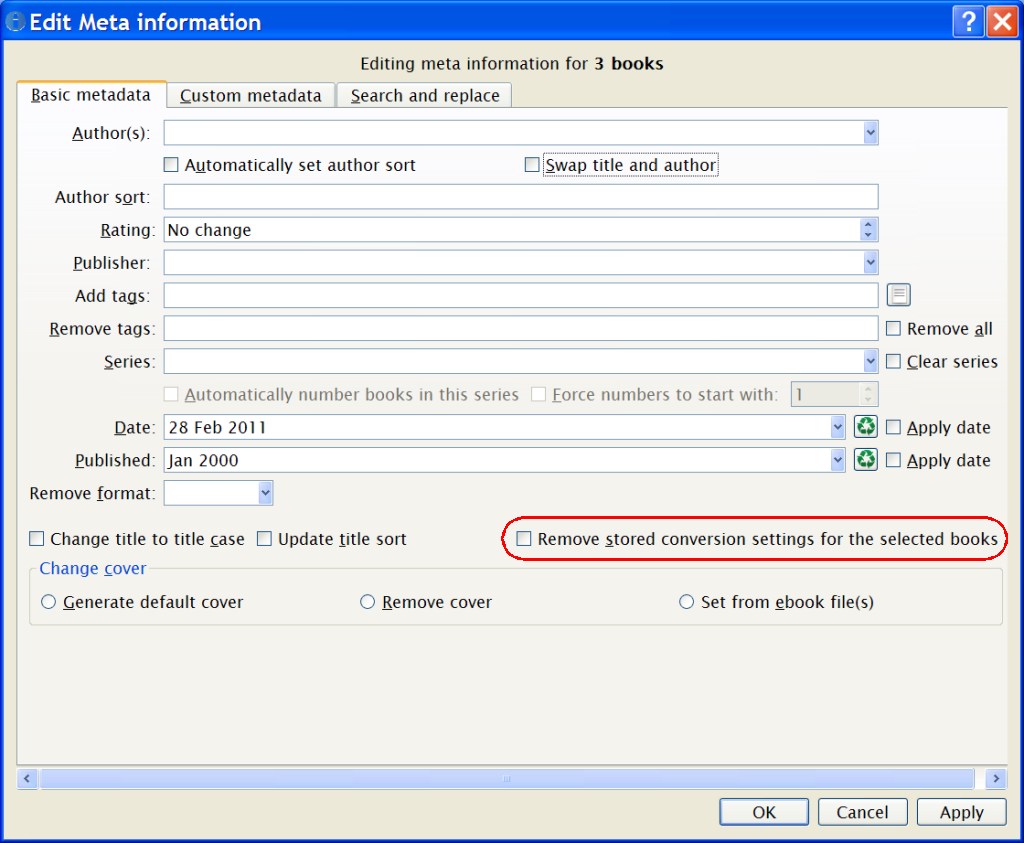

It is hard to imagine any way this could be a calibre issue, but I'm willing to inspect a ePub file closer to see if something pops out.
Originally Posted by jager31702 View Post
I recently set the split size to something ridiculously high, like 6mb so that there shouldn't be an issue.
Set split size (in epub output) back to 260k and leave it alone if you expect any book you convert to epub to work after conversion.
Also after changing this setting select all books, go to edit metadata and remove stored conversion settings from selected books (see attached)
Name:	remove conversionsettings.jpg
Last edited by DoctorOhh; 02-28-2011 at 11:07 PM. Reason: Removed bogus recommendation based on new info.
Do you have 7Megs of free memory in your reader?
Didn't think so
That setting affects the size if a split, NOT the size of the epub . You did not just choke your reader. You strangled it, wrapped it in saran, cast it in cement, stomped on it
Your PC DOES have 7M of RAM. that is why that worked.
260K
260K
260K
is a tried and true number

Just a note for the OP, the Adobe Digital Editions (ADE) epub renderer built into the prs-600 requires the split to be smaller than 300k. Stick with the default of 260k.
