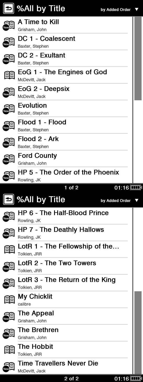

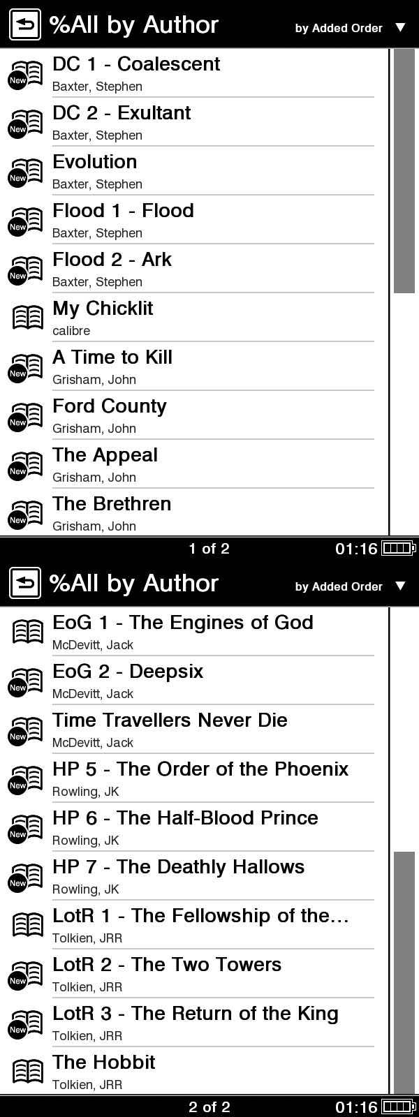

Old 12-23-2010, 09:40 PM   #28
jackie_w
Posts: 6,356
Karma: 16800000
I do believe you've fixed it. Let joy be unconfined!
For completeness I've attached screencaps of the 2 new special Collections, %All by Author and %All by Title
I hope you have a very Happy Christmas
ID:	63404   Click image for larger version
