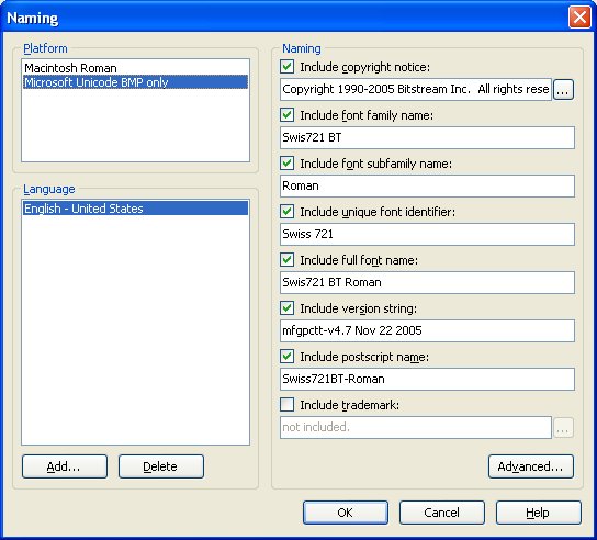

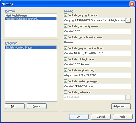

Okay, I think I've figured out a part of what was going wrong with my attempts to replace the fonts -- I think I had some of the internal attributes off.
So, for the future reference of those who come after me, I hereby attach screen shots of the internal attributes of the original Sony Reader fonts, as seen and displayed by FontCreator.
They are Monospace, Serif, and Sans Serif, in that order.

Old 06-28-2007, 09:46 PM   #26
Posts: 85,424
Karma: 154365103
So do you have the replaced fonts working now?

Old 06-28-2007, 09:57 PM   #29
NatCh
Gizmologist
NatCh's Avatar
Posts: 11,615
Karma: 929550
Join Date: Jan 2006
Device: Pocketbook Touch HD3
Nope.
I'm beginning to think that M$ may have done something obnoxious to them, that's interfering with the load somehow. The only one that would actually load was the Consolas, and that's the one I care the least about -- like not at all. I'm giving up for the evening.
