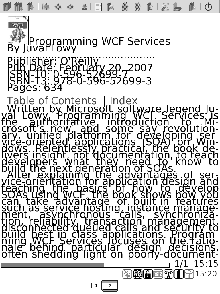

This is an example of a CHM on my iLiad after installing 2.9.5.
FBReader's clock seems to be off by 5 minutes as well???
This font always looks uneven on screenshots. Is it better on the iLiad screen? I had not seen text from one line overlapping another in FBReader before, but I can get the same effect under Windows or Linux Desktop by setting the line spacing to 0.5 (I usually have this set to 1.3, which is probably the default). This setting is under the tools icon in the format tab. If it is set to 1.3, then probably the character hight isn't being detected correctly. The font itself is selected under tools/styles.
Old 04-28-2007, 04:13 AM   #28
templario
templario began at the beginning.
Posts: 86
Join Date: Dec 2006
Device: Iliad
The same happened to me, but you can change the font type and size in the settings menu, so i did and know it looks good. One question why the clock is two hours different to my time zone? can i change this?
templario is offline   Reply With Quote
Is the time off by 5 minutes right after you turn the page/open the book? The time is not updated on iLiad (as it's a very long operation that reduces usability), so if you read one page for some time, then you should observe the difference.
