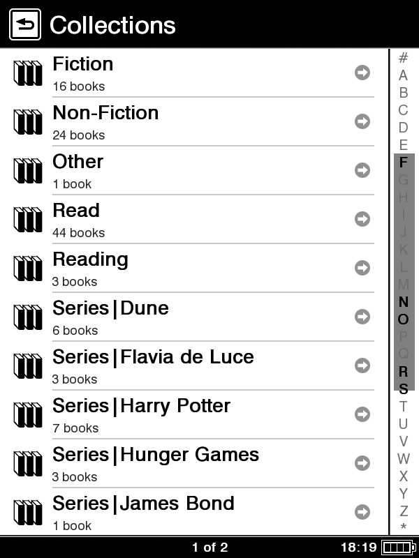

Quisvir, could you upload a screenshoot of the new modification "Added sub-collection support"?
thanks

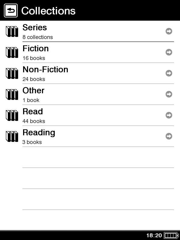

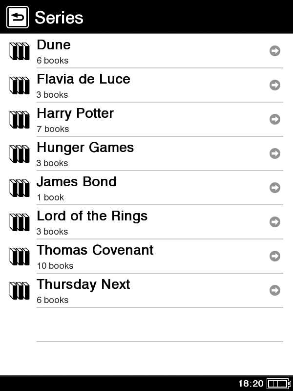

VICTORSJG:
Sure, here you go
First screenshot is collections with their actual names, 2nd and 3rd screenshot with sub-collections enabled. So to use sub-collections, just name your collections with a | character where you want the split. The name Series|Harry Potter will result in your Harry Potter sub-collection being inside the Series collection. I'm guessing it's most useful for series and genres, but I'm sure people will find other uses as well.

Quisvir, to use sub-collections on prs-505, would i have to add the character | to the collection name, when i create a new in readerlibrary?
thanks

VICTORSJG:
That's correct: just put a | in the name where you want it to be split.
