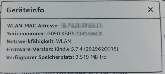

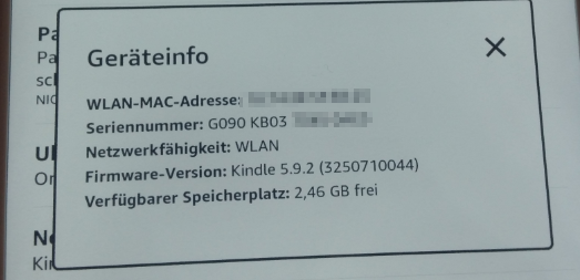

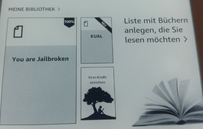

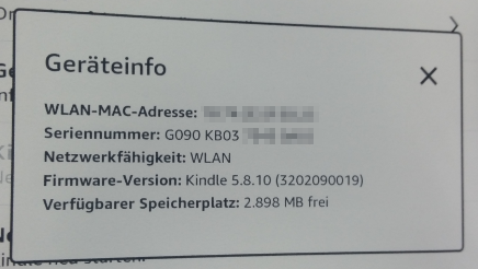

Old 11-26-2017, 04:07 PM   #2872
Export
Export began at the beginning.
Posts: 4
Join Date: Nov 2017
Device: kindle
Will this jail break work on my current firmware?
If the third field of your firmware version number: 5.8.7.0.1 is larger than 7 this jail break will not work on your device.
That means it will not work on: 5.8.8, 5.8.9, 5.8.10, ..., 5.8.99999999.
Please do not even think of asking if this message still means what is written. The message is kept current.
You may want to Update this text. As halentech stated in this Thread, a downgrade from 5.8.10 to 5.7.4 is possible (at least in some cases).
The same approach worked for me too (new Kindle PaperWhite 3 White (2015) WiFi, G090KB, 5.8.10).
What i did withy my new kindle:
1. skipped wlan connection
2. created "update.bin.tmp.partial" folder via usb
3. backuped my folders
4. connected to amazon once
5. downgraded to 5.7.4
6. stuck in Tree Screen - connected usb, cmd diskpart, kindle starts
7. flashed Kindle Factory Image Generic Jailbreak - main-html
8. flashed jailbreak hotfix - JailBreak-1.14.N-FW-5.x-hotfix.zip
9. flashed newest update https://s3.amazonaws.com/firmwaredow...hite_5.9.2.bin
10. keep asking me what to flash, since the main reason to buy and jailbreak - WebLaunch - doesn´t works anymore
Export is offline   Reply With Quote
Old 11-26-2017, 05:45 PM   #2873
knc1
Going Viral
knc1's Avatar
Posts: 17,212
Karma: 18210809
Location: Central Texas
Device: No K1, PW2, KV, KOA
Do I do not want to change.
Not based on a message that does not bother to mention what model Kindle (there are at least 80 models) nor what firmware version they found was susceptible.
It is just forum noise without specific details.
Old 11-26-2017, 06:07 PM   #2874
Export
Posts: 4
Join Date: Nov 2017
Device: kindle
As stated in my previous post:
see the screenshots for the particular fw versions.
ID:	160245   Click image for larger version
ID:	160246   Click image for larger version
ID:	160247   Click image for larger version

Old 11-26-2017, 08:02 PM   #2875
knc1
Going Viral
knc1's Avatar
Posts: 17,212
Karma: 18210809
You failed to mention it was a German Kindle.
If you have been following this site, you would have known.
