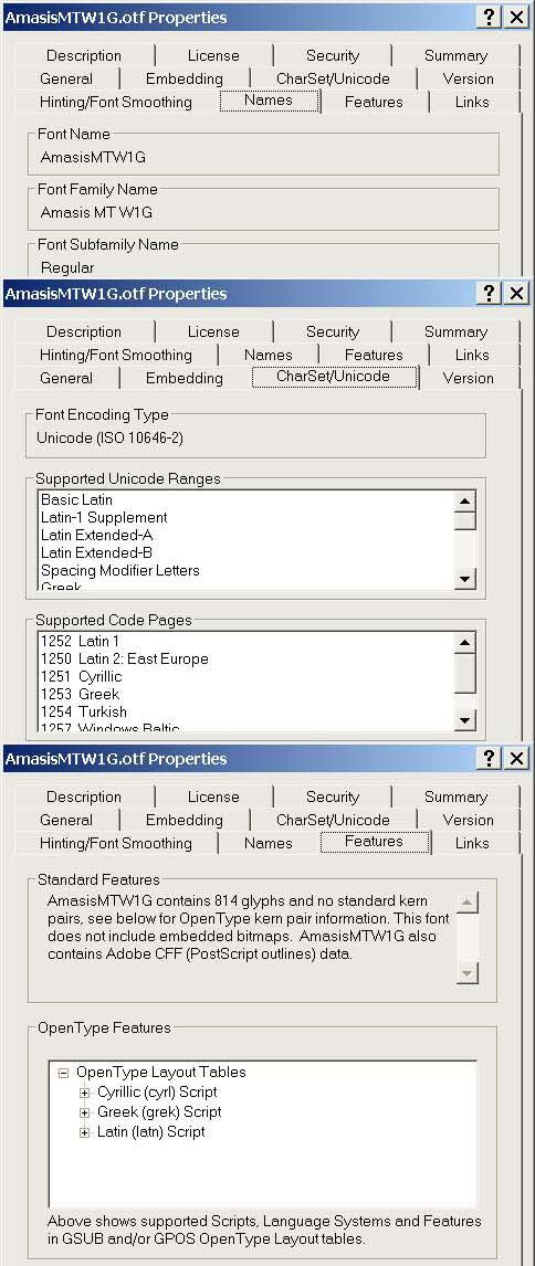

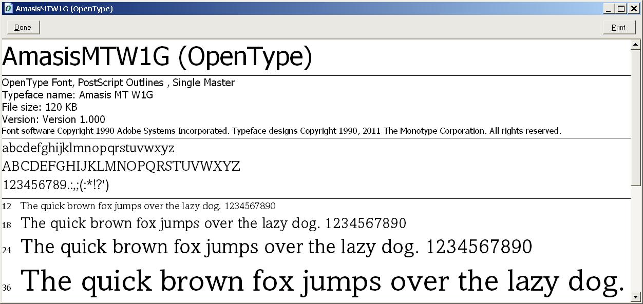

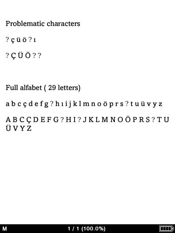

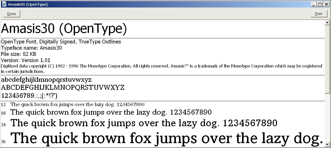

@Timur,
Re: Nook Amasis - that's very interesting and somewhat perplexing, because that's exactly how I did acquire the Nook fonts to try out on my Sonys. Admittedly it was a few weeks ago.
Nook Amasis Regular font is called Amasis30.ttf sized 83,420 bytes
PRST1 Amasis Regular font is called AmasisMTW1G.otf sized 122,660 bytes
The Nook Amasis shows most of the Turkish chars, but not all, when used on my Sony. The PRST1 Amasis shows all of them. See attached screencaps, 1st is Nook, 2nd is PRST1. The same epub on the same PRS650 reader was used for both screencaps.
Which version of Amasis is better (T1 or nook)?
@JSWolf,
That would depends on your point-of-view. Based on visual clarity I'd say Nook Amasis because it's a heavier font (like a semi-bold) -- presumably that '30' in the filename is describing font-weight. However, if you need non-English char support then the T1 is probably more versatile.
IMO the Amasis font is rather nice. Amasis Regular has the benefits of the Kindle Caecilia fonts (clear, plain, simple) with the added benefits (again IMO) that Amasis Italic is more elegant than Kindle Caecilia Italic and Amasis has a bigger difference between bold and non-bold.
ID:	80684   Click image for larger version

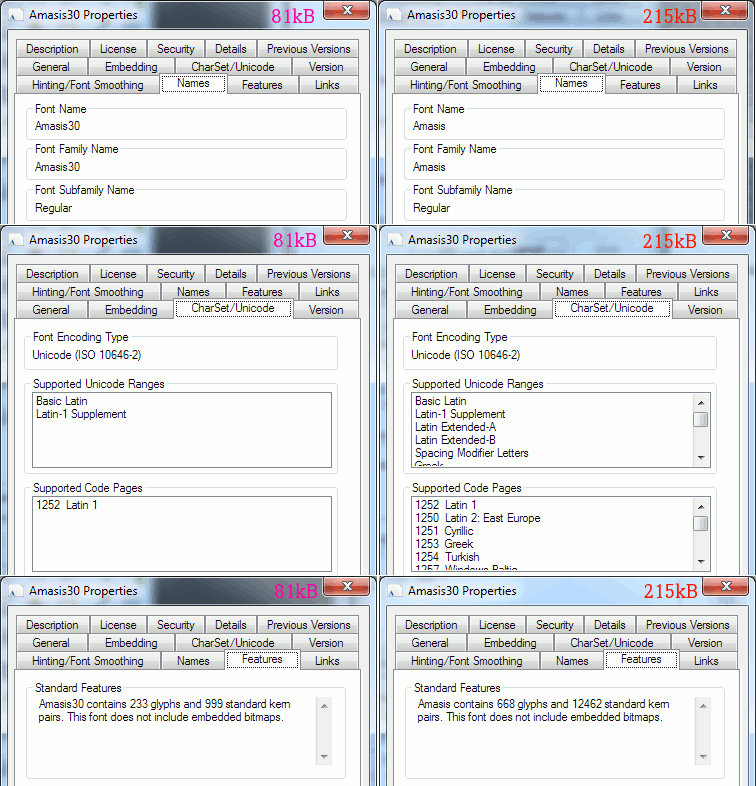

I see the reason for the discrepancy now, your Amasis is from 1.0.1 update package, mine is from 1.1 update package. These are the file sizes from 1.1:
220,280 Amasis30.ttf
234,924 Amasis30-Bold.ttf
259,544 Amasis30-BoldItalic.ttf
263,936 Amasis30-Italic.ttf
Coincidentally, although the font files in 1.0.1 update seem to be missing Turkish glyphs, I have used 1.0.1 for a long time and I remember checking Turkish characters with all fonts and found them working then as well. Maybe 1.0 firmware had the bigger files anyway and the updater was not really copying those font files from 1.0.1 during update.
Timur is offline   Reply With Quote

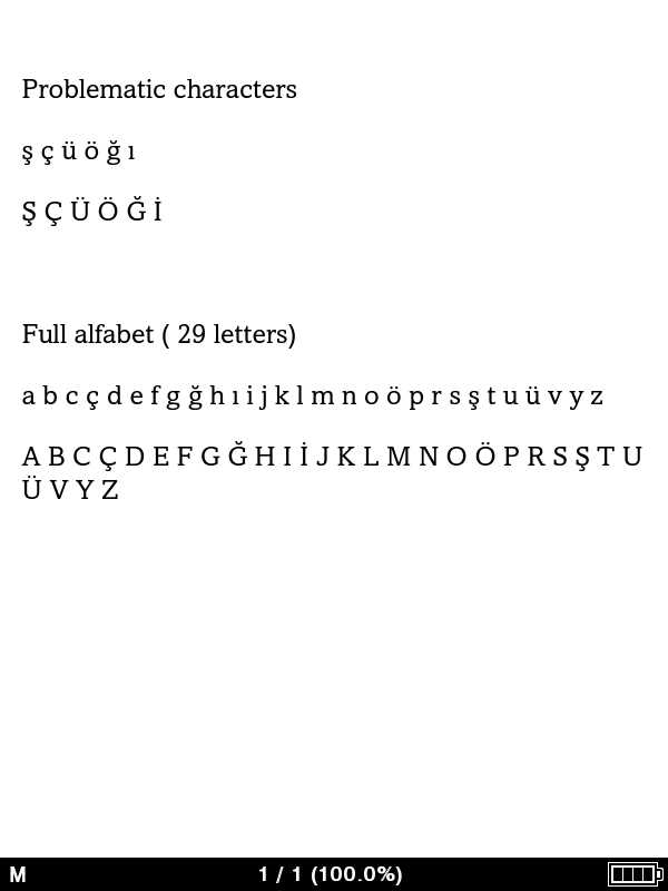

Follow-up ... after downloading Nook Amasis from Nook update v1.1
The results are mixed. The Turkish chars are now displayed correctly with the v1.1 Amasis. However, despite the filenames remaining the same (Amasis30...) I see that the font-weight of v1.1 is not as heavy as it was in v1.0.1.
I would say the Nook v1.1 Amasis looks more like the PRST1 Amasis, but the fact that the Nook font files are twice the size of the PRST1 font files may mean that the Nook is 'better' in some way. I don't know enough about how fonts work to draw conclusions.
For anyone interested in a comparative visual overview from a Windows PC, the 3 versions are, from left to right, Nookv1.0.1, Nookv1.1, PRST1.
(I hope I'm not breaking any copyright protocol)
ID:	80697   Click image for larger version
ID:	80698   Click image for larger version

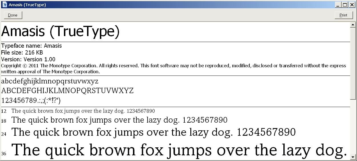

Although the new files are named "Amasis30", they are not Amasis30 but regular Amasis(different weight). One can tell from fontname property embedded in the files.
Couple of comparisons between 81kB and 215kB Amasis follows in the attachment:

... and just to complete the comparison, the PRST1 equivalent of Timur's Nook font properties...
