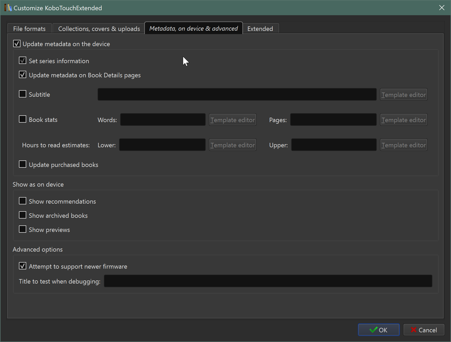

So, I'm not sure I could remake my current Calibre config from scratch as it's been made through a lot of years of usage.
For adding the serie metadata to books on the kobo, I'm using 2 plugins (maybe only the first is needed ?)
- Kobo Touch Extended Driver https://www.mobileread.com/forums/sh...d.php?t=211135
- Kobo Utilities https://www.mobileread.com/forums/sh...d.php?t=215339
These are the settings for the Extended Driver.
To get the serie metadata updated, I think you need the "Update metadata" checked on this page, and the series one also.
Name:	2024 03 08 104254 - calibre.png

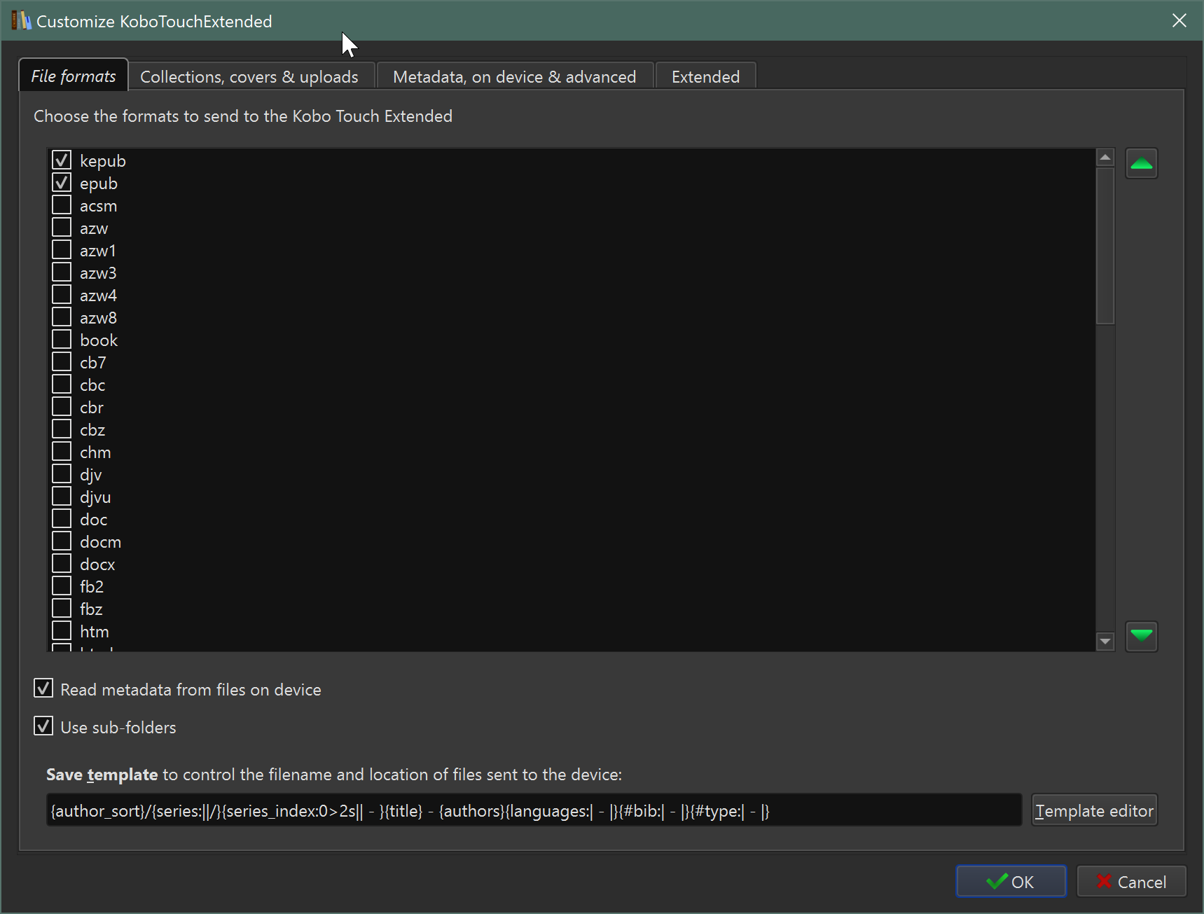

I'm also converting epub to kepub when sending to device, it can have an impact ?
Name:	2024 03 08 104306 - calibre.png

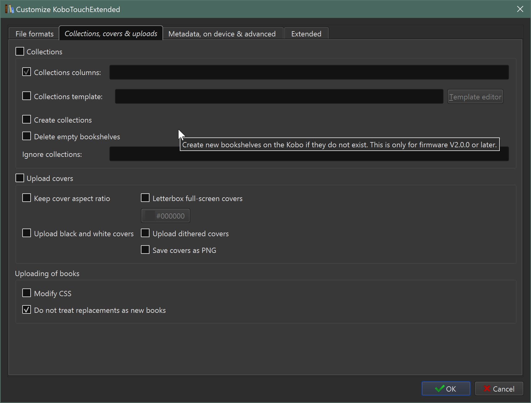

I've seen how to set up Kobotouchextend, would it be possible to see the settings for the "Collection, covers" tab in KoboTouchextend?
Thank you
Patrick Faret is offline   Reply With Quote
Old 03-08-2024, 06:25 AM   #277
dragoworld235
dragoworld235 began at the beginning.
Posts: 30
Join Date: Oct 2012
Device: kobo libra 2
Originally Posted by Patrick Faret View Post
Hello Dragomonde235,
Thank you
Name:	2024 03 08 104231 - calibre.png
Name:	2024 03 08 104246 - calibre.png

Re hello Dragomonde235,
I see that the "Collection column" field is checked, but the assosciated field is not filled. Which Caliber column do you fill in to indicate the collection of your books?
On the other hand, the "creation collection" field is not checked. Is this normal?
Thank you for your help
I don't sync kobo collections to calibre anymore. So it must be remnant of previous time. As it's not creating any problems, I'm just not trying to fix something that ain't broken .
