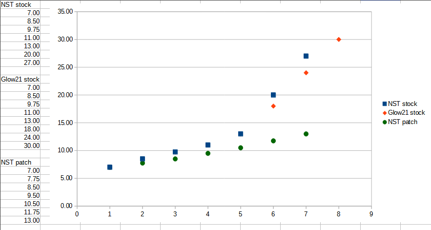

The B&N stock reader font sizes were always stupid. From the days of the Nook Simple Touch until this new device they have basically stayed the same, except now the super large sizes have been stretched further and the addition of an 8th even stupider font size.
Back in the days of the NST I wrote a patch for this. It's still available on my website. I never got around to writing one for the Glows as I stopped using the stock reader long ago. The problem with patching is that you have to re-sign them which basically makes them a non-system app. The latest device also has this obfuscated (not that that's a biggie). It can be plainly found in smali\com\bn\nook\reader\commonui\ReaderCommonUICo nstants$3.smali in the earlier Glows and smali_classes2\com\bn\nook\reader\util\h0.smali in the latest.

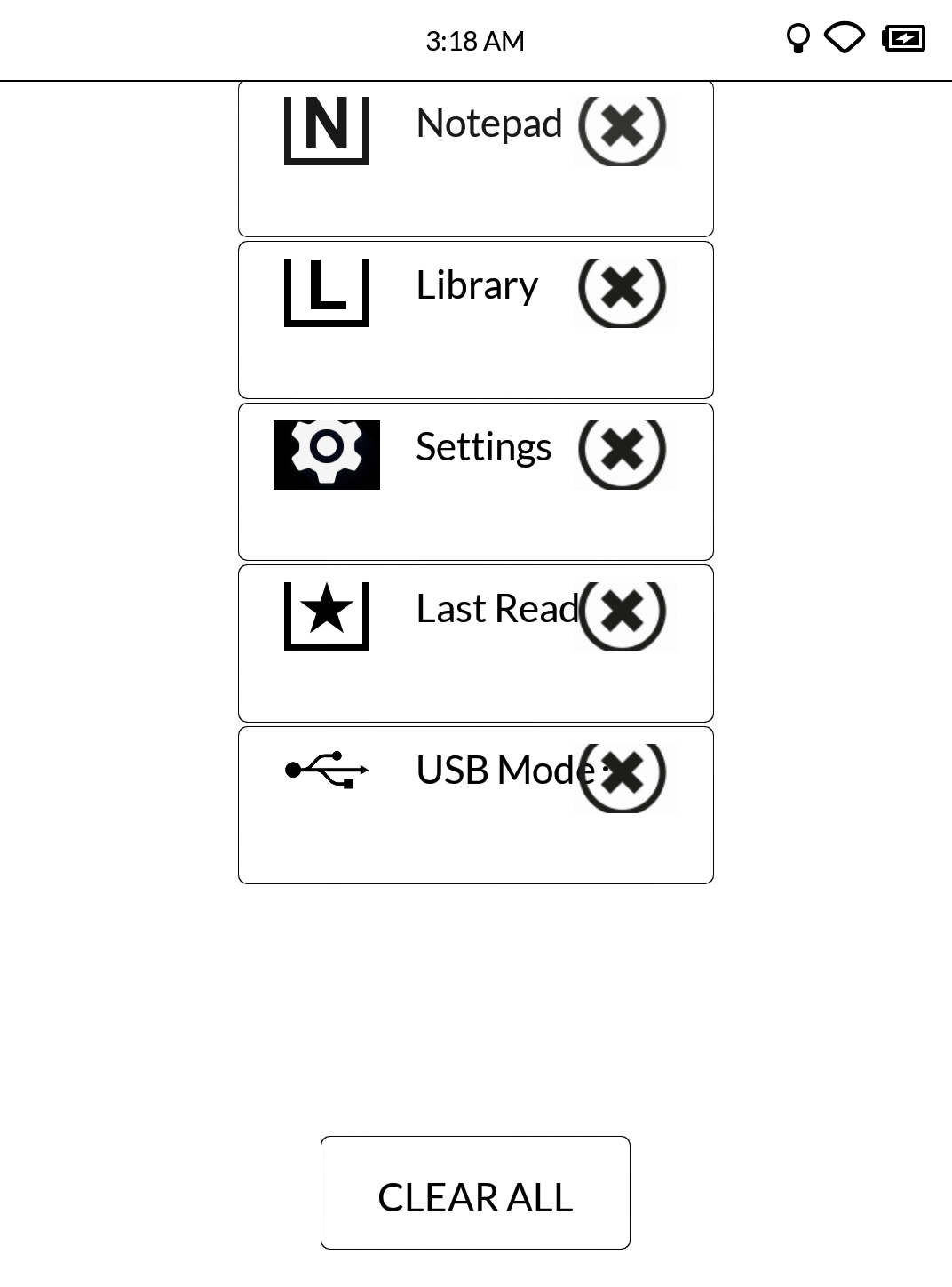

Well, now that you (that is, everybody) have it rooted probably the first thing you want to do is to fix those buttons!
The file that you care about is /system/usr/keylayout/Vendor_0001_Product_0001.kl That has the nonsense about F9-12 in it. Now, you can go in and just overwrite that file. You might never have a problem with that, but the Magisk way is to build a module. It's not that difficult, mostly a bit of boiler plate. Full instructions are found here: https://topjohnwu.github.io/Magisk/guides.html
So the file contents are your choice. Here's mine because I regard back and app switch as two of the most useful things in Android.
key 116  POWER
key 102  HOME
key 191  APP_SWITCH  # top left
key 192  PAGE_UP     # top right
key 193  BACK        # bottom left
key 194  PAGE_DOWN   # bottom right
OMG, is that app switcher UGLY! Want to see how ugly it is without doing the mod above? Just do:
C:\>adb shell input keyevent 187
I finally got my version up to 8.1.1.110. I did it the hard way.
