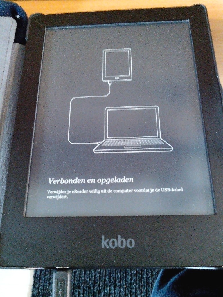

Interesting. With my Glo as soon as I do the disconnect via calibre the device displays the processing new content screen, even while the USB cable is still connected.
Yes.. but in the release notes, nowhere stands that the "ejection" (hmm.. hope I don't say 18+ things here) is only for Calibre.
It is announced as a feature, then I think it is a feature that works in my o.s.
If there was: When u eject the device from within Calibre, it will start again, I wasn't "complaining" because that works (never saw that button but more things are hidden in my language,or not exactly clear because everyone is speaking english here and then I have to search for what the function is in English.)
Everyone says, it works for me in Calibre, but this is not a Calibre topic.
So if i see: If u eject the device,it starts again without disconnecting the usb cable,and it is not in a Calibre topic, I think it is a feature that works in windows 7,which it doesn't with the safe eject function.
Windows doesn't give a warning like "another program is using this device so you can't eject it" it just does, the device drive (usually J) disappears,and I can't use the eject button again since I already eject it.
So yes it works from Calibre, but that is not what the feature list says.
Originally Posted by patrik View Post
You are completly correct, Calibre has nothing to do with it (nor did I say it did). It doesn't matter if you eject/unmount from within Calibre or some other means in your OS. For me, whatever way I eject/umount, my Aura HD recoqnizes it and starts to process and return to main menu.
There is something fishy with your setup I guess...
I don't think there is something wrong with 3 computers, but I now think... did I tried it with the Aura HD or the Glo.. from the Glo it doesn't work, for the Aura HD I gonna test it.
All the deviced are hooked up on a 14 port USB hub..so I gonna see if that is the bottleneck.
/edit tried it on a direct USB port,not on the hub with both Aura HD and Glo, didn't work so I think the function called in the Changelist for this firmware,must have something like ("works from Calibre").
What release notes? Or are referring to my post with a list of changes? The post that has disclaimer about them being things that I noticed while testing the betas? And that I state they mainly cover functions of the firmware that I use and are probably incomplete? I'll remember to put the disclaimer in bold next time. Or do I need flashing red as well?
I think that's based on another off-hand comment of mine. Yes, I have an eject button in the toolbar. You probably don't as I use a plugin called "Smart Eject" so that I can have an easy way to eject the device.
And I have no idea whether it works with Mac or a Linux box. Actually, I do know for CentOS6. The eject that it's explorer equivalent has, will disconnect the device so that it restarts.
Attachment 130340 The menu shows the device.
Attachment 130341 The menu shows the device is ejected (with the sound that belongs there)
Attachment 130342 Device stays in this modus.
So, I was lax in my testing. I did notice that it didn't always work. But, that hadn't happened enough for me to look for a pattern. But, I made the assumption it was a combination of what I did while the device was connected. Pre-3.11.0, I had occasions where the device didn't restart after disconnecting, or took a long time to, so I assumed it was related to that. But, I have done some testing. Much to my surprise, ejecting from the "Safely remove device" menu is not the same as ejecting from explorer or calibre. From explorer, it's the same as from calibre. The device will disconnect fully and restart. From the safely remove menu, it doesn't. To my mind, that's unexpected and bad. This should be the safest way to disconnect the device. After all, that is what the menu says. But, it leaves the device in a partial state that could be a problem.
And just to be explicit:
- I did most of my testing with Windows 7, 32bit and all the latest fixes on an aging ASUS laptop
- Ejecting from calibre, will let the device restart without disconnecting.
- Using "Eject" from explorer, will let the device restart without disconnecting.
- Using "Eject eReader 3.11.0" from the "Safely remove device" icon in the system tray will not let the device restart without disconnecting.
- Using "Eject" on the icon in the "Devices and Printer" folder will not let the device restart without disconnecting.
- This is with a Glo and a N905 Touch
- I have not tested in any other version of Windows
- I have not tested in a Mac
- I have tested with a CentOS6 machine (some sort of AMD) and it did let the device restart without disconnecting.

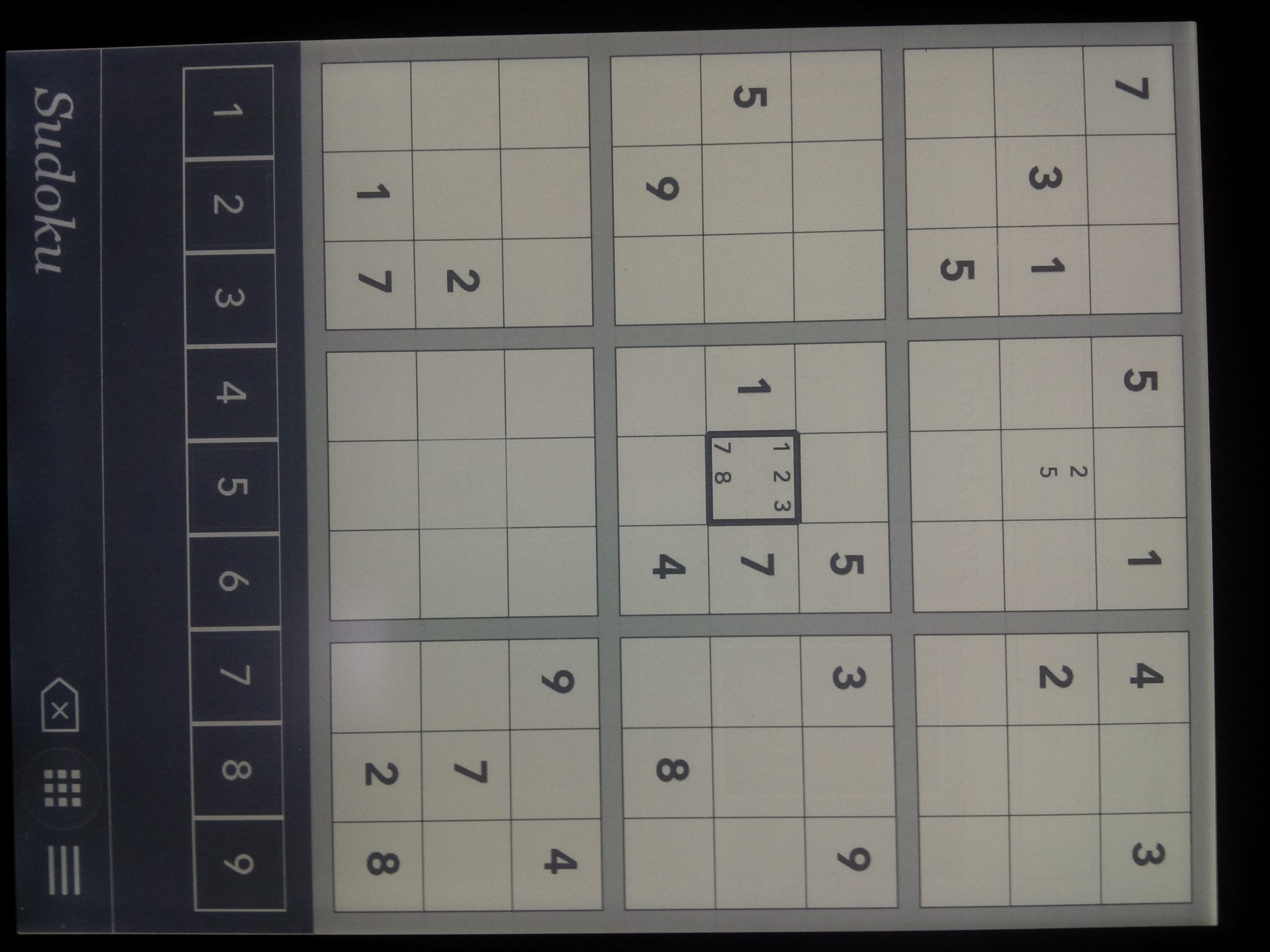

Hmmm... Is it just me, or is the Sudoku game also updated? I don't play any of the games very often so I can't be sure, but I seem to remember that Sudoku didn't allow you to write possible solutions in tiny numbers in the corners of the squares. Now it does. It also looks different than my memory recalls. Can anybody check?
Edit: I added an image of the screen.
I just tried it on my reader that still has 2.4.0 firmware on it, and you can enter in the small numbers as possible solutions on it by hitting the small 9x9 grid icon at the bottom right. It's the same exact layout except for the light icon that used to be in the bottom bar.

So please, i am again not attack you.
My main issue was, why does it disconnect and restart at a bunch of people,while it doesn't happens here at my home,with two devices and 3 computers and if it is intended as a feature for this firmware, why does it not work the way it has to do.
In that "light" I put my post, not for attacking you at any way and if you feel like that, my deepest excuses. (apologies)
But if it is a feature implemented by Kobo,then it is "important" to tell that it doesn't work the way it should be by everyone.
If it is only a feature used in Calibre, then I misunderstood and again sorry.
I can hear a difference between using the save eject, or Calibre eject,with Calibre it more sounds as a "disconnect" then a eject from the menu.
Originally Posted by jackastor View Post
When using a USB Hub please ensure its powered by an external source and that the source provides enough power to the 14 devices that you may or may not have attached at any one time. Any more then one device attached with out power to the hub will result in interesting and potentially damaging effects on devices that are underpowered due to insufficient power supply from the computer.
regards
Jack
It is powered by a external source at 3 ways. (Hubport/14 14 Port USB 2.0 Hub)
It has a power supply of 6 amps, leaving 4 gates also more powered to charge devices, per port it gives 600 milli amps and 1.5 amps at the charging ports.
Beside that it is connected to a UPS (APC Smart-UPS 1500VA USB & Serial 230V)

That is visible in the attachments I placed (post #275) so yes.
But now I know it is not my device problems by the last post of davidfor:
- Using "Eject" on the icon in the "Devices and Printer" folder will not let the device restart without disconnecting. (again thanks for clarify) so case closed.
But the charging thing is a bit of "magic" some say when pin 2 and 3 are connected (short cirquit) it is a charger, if not, is is a computer, other states that all above 500 Milli amps are seen as chargers.. but that is not the way a charger works, it only gives what the device ask so if it's charging by a regulator not more as 300 milli amps to prevent that it will blow up your usb ports, it will never been seen as a charger.
it could be a combination, if pin 2 and 3 are short cirquit, then it is a charger and more current can be drawn so the device switch inside to accept a bigger current like my Nexus tablet does when connected to an usb port it takes 400 milli amps but when connected to a charger with the 2 pins shorted, it drawns 1,5 amps, but I had once an usb cable that has internally shorted pin 2 and 3,off course didn't send or receive information but it blew up my HTC phone... and the windows energy scheme can shut down USB ports to save energy and go into sleep...
My Glo and Aura HD accept a old charger,but when I connect my Sony to it, it says "this is not a charger so charging is suspended" (or something like that.. it's on Dutch..)
I saw 3 of 4 explanations on the internet about the charging,and they all where different..
