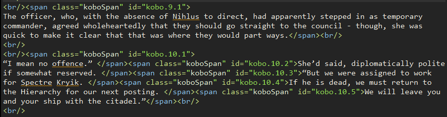

I was having a look at the code of the KePub that I am reading. I was wonder what the reasoning is for the multiple koboSpan spans in some paragraphs? Are they needed or would KePub work with just one koboSpan per paragraph?
I did a quick S/R and removed all of the koboSpan except for those that followed <p>. So far everything seems to work.

Is this anything similar to what you're seeing? It's from an eBook downloaded with FanFicFare and then sent to my Kobo with KTE.
Name:	2022-06-09 12_49_36-Edit book.png

Judging from the id of the spans, I'd expect that it was used internally for reading position/annotation purposes?
Yes, that is what I am seeing with multiple spans in some paragraphs. I'm wondering why more then one span per paragraph is needed.
Based on experiments (several years ago), rather than inside knowledge, I had a very bad visual result when I allowed any kobospan to contain other inline tags, e.g. <i>, <span>, ... etc. In other words, a kobospan should contain only text. You need to start a new kobospan for the text inside <i>...</i> or <span...>...</span> or following a <br/> or a link <a...></a>.
For any paragraph which contains only plain text, a single kobospan wrapped around the whole of the text should be fine.

Based on experiments (several years ago), rather than inside knowledge, I had a very bad visual result when I allowed any kobospan to contain other inline tags, e.g. <i>, <span>, ... etc. In other words, a kobospan should contain only text. You need to start a new kobospan for the text inside <i>...</i> or <span...>...</span> or following a <br/> or a link <a...>...</a>.
It would be nice then for the KTE extended driver to do it that way for less spans.

Is it causing issues? If not, I dont see why it matters.
Old 06-09-2022, 02:50 PM   #2774
Posts: 85,886
Karma: 154365287
On really long eBooks, it would make the code less and thus the size and maybe it wouldn't time out like it can. Also, I do like cleaner code when possible.
