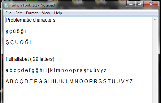

Yes, as soon as I finished my post at this Sony-specific thread, I immediately initiated a new thread under Nook subforum here, with a direct link to this thread in order to avoid double effort and identical threads. Currently I am waiting for Nook experts' return on my issues, especially for the issue no 2.
As requested, I attach all the problematic Turkish fonts in a txt document. I also attach a screenshot of the fonts so that you could yourself see if they are displayed correctly and get a hint of what we are speaking about. Besides, if you see those letters correctly with any of your fonts, this would mean that in addition to LiberationSerif, that particular font of yours does also support Turkish. This would give me more alternative fonts to use in my Nook. Your support in resolving the issues 1 and 3 will therefore be truly and higly appreciated.
Happy new year to everyone.

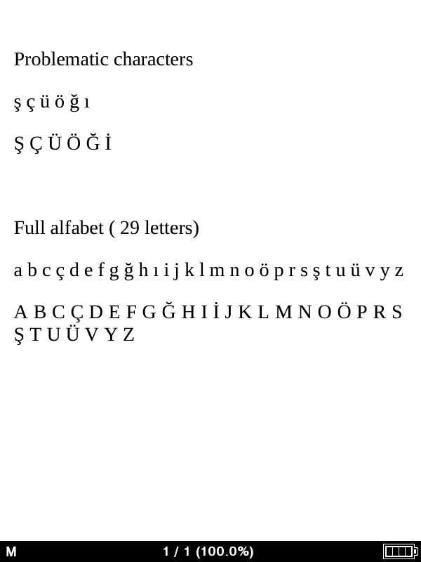

  1. The Liberation Serif font appears to display Turkish OK. The attached image is a screencap from my Sony PRS650 of an epub created by Calibre from your Turkish TXT file. It references the Liberation fonts stored in a /fonts directory on the Sony using the Sony-special urls
    @font-face {font-family: serif; ... ... src: url(res:///Data/fonts/LiberationSerif-Regular.ttf)}
    etc ... etc ...
    in @font-faces stored in Calibre Look&Feel ExtraCSS. So if the Nook community can tell you the Nook equivalent you should be OK to prepare your epubs this way.
  2. If you can't find the Nook url info then you still have the option to eliminate problem 2 by fully embedding the Liberation fonts inside each epub. I've attached your sample so you can test it on your Nook.

Yes guys, if anyone follows my threads in many blogs up to this point, my issue has been cleverly resolved by this gentlemen, jackie_w... I truly owe him a lot.
My problem turned out to be lack of a proper codepage utilisation. When I choose cp1254 for Turkish (jackie_w says it is cp1252 for English windows users) everthing worked out perfectly. cp1254 should be chosen in Calibre under Common Options/Look and Feel/Input Character Encoding.
As part of the solution the ExtraCSS block in Calibre also turned out to be:
@font-face {
font-style: italic;
font-family: 'LiberationSerif', serif, sans-serif;
font-weight: normal;
src: url('res:///system/media/sdcard/my fonts/LiberationSerif-Italic.ttf');
@font-face {
font-style: normal;
src: url('res:///system/media/sdcard/my fonts/LiberationSerif-Regular.ttf');
@font-face {
font-style: italic;
font-weight: bold;
src: url('res:///system/media/sdcard/my fonts/LiberationSerif-BoldItalic.ttf');
@font-face {
font-style: normal;
font-weight: bold;
src: url('res:///system/media/sdcard/my fonts/LiberationSerif-Bold.ttf');
body {
margin-right: 8pt;
font-family: 'LiberationSerif', serif;
I hope this is helpful.
Many thanks again Jackie_W!
