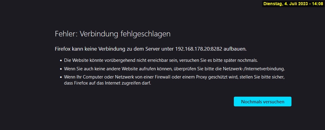

@mariosipad
Just "Fauld - Not able to build a connection"

Old 07-04-2023, 11:15 AM   #260
mariosipad
mariosipad is clearly one to watchmariosipad is clearly one to watchmariosipad is clearly one to watchmariosipad is clearly one to watchmariosipad is clearly one to watchmariosipad is clearly one to watchmariosipad is clearly one to watchmariosipad is clearly one to watchmariosipad is clearly one to watchmariosipad is clearly one to watchmariosipad is clearly one to watch
Posts: 726
Karma: 10738
Join Date: Nov 2012
Device: iPad & iPhone with Marvin 2 + 3 & Kobo Glo HD
@huber70
Strange.....
what is the output of (from the pi with pigallery2):
ip a
mariosipad is offline   Reply With Quote
