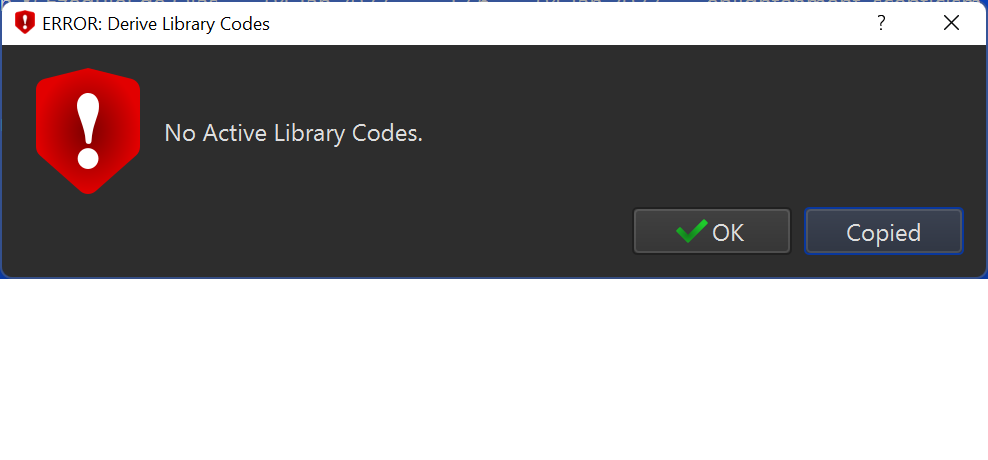

Old 01-04-2022, 11:13 AM   #268
baris_a
baris_a began at the beginning.
Join Date: Jan 2022
Device: kindle
Library codes not found
Hi,
I have been using the library codes for since last year and because I had to reinstall calibre in another machine I installed it on that machine but I am receiving this error.
calibre, version 5.34.0
ERROR: Derive Library Codes: No Active Library Codes.
I have manually installed the plugin as well as through regular path but both produced the same result.
I have searched for the error in this forum but could not locate it.
Any lead is appreciated thanks
Baris
baris_a is offline   Reply With Quote
